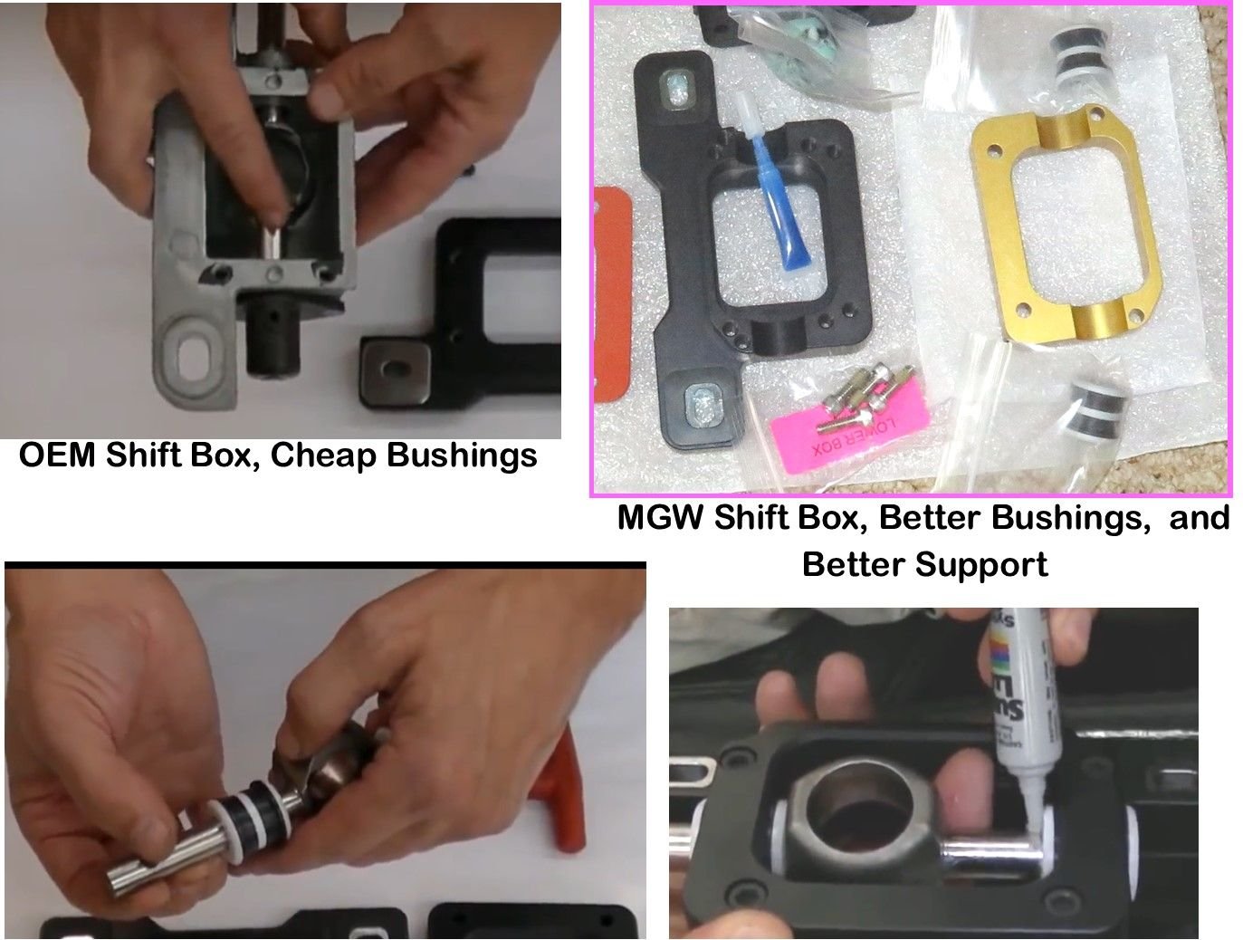

Hmm, the OEM **** slips over the OEM shaft and is attached with a screw. The part that slips over the shaft is made of plastic so a vibrating shift lever can't causue objectional vibration.
I bought the Cue Ball **** with aluminum base for my early 2014 Z51, loved it. So when I got my 2017 Grand Sport bought another BUT the product mfg was sold and it appears to be slightly different.. Perhaps the OD dimension, don't know. BUT after some months is started to vibrate and make noise. Got so bad I installed an MGW flat stick shifter that does use a threaded ****.
I had two problems with the OEM **** when I removed. One, the screw head sheared from the screw thread! They used a very strong loctite material. PIA to fix and I was not about to mess trying to fix it! One note: when I had the bad vibration sound I could grab the OEM shaft through the boot with my hand and the nose stopped. The OEM shifter vibrates. The MGW shifter fixes that. It had a much better design and no shift handle vibration! It's also a 25% reduced stroke. Great product.
If anyone is interested this PDF covers all three installs: http://netwelding.com/MGW_Shifter.pdf

Wrong! Have to look at the OEM shifter to see the issue versus MGW. It uses better bearings and a more ridged bushing shift rod support!
When my cue ball **** starting making a loud rattle sound I could grab the OEM vertical shift lever through the leather boot, stop the vibration and stop the rattle. When I installed the MGW shifter, the superior shift rod bushings were obvious as were they larger Nylon cushining. I can grip my MGW shift through the boot and feel it is NOT vibrating like the OEM! Great shifter. In fact I was surprised the 25% shorter shifts did not appear to increase the shifting effort. All due to the better design!
