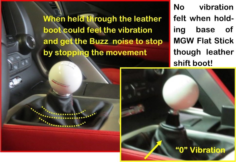

Originally Posted by boss2k
RPI ****
Had the same **** on my Grand Sport- same rattle. Funny had that **** on my 2014 BUT from the original manufacturer and no issue.
Because I had problems removing the OEM **** (screw head sheared off) did not want to mess with it. So solved the problem with a MGW flat stick shifter that uses a thread ****. A lot more work BUT works great!
Here is a PDF of my install with comments about the **** rattling: http://netwelding.com/MGW_Shifter.pdf

Mine started to rattle, first at a specific rpm than in most gears. Could grab the OEM shift level through the boot and stop vibration and rattle. What I had was not going to be eliminated with a "O" ring. As mentioned previously had the same **** on my 2014 for 3 years with no issue but the manufacturer changed, perhaps also the hole tolerances.
When I installed the MGW shifter all the vibration stopped. I used their Flat Stick version since it uses it's own rubber part eliminating the OEM chrome ring AND has a screw on ****! No chance of a rattle!
I am getting the same noise as you mention
Is the white **** on the MGW shifter you bought with it or the RPI ****? Will the RPI **** fit on the MGW Flat stick?
