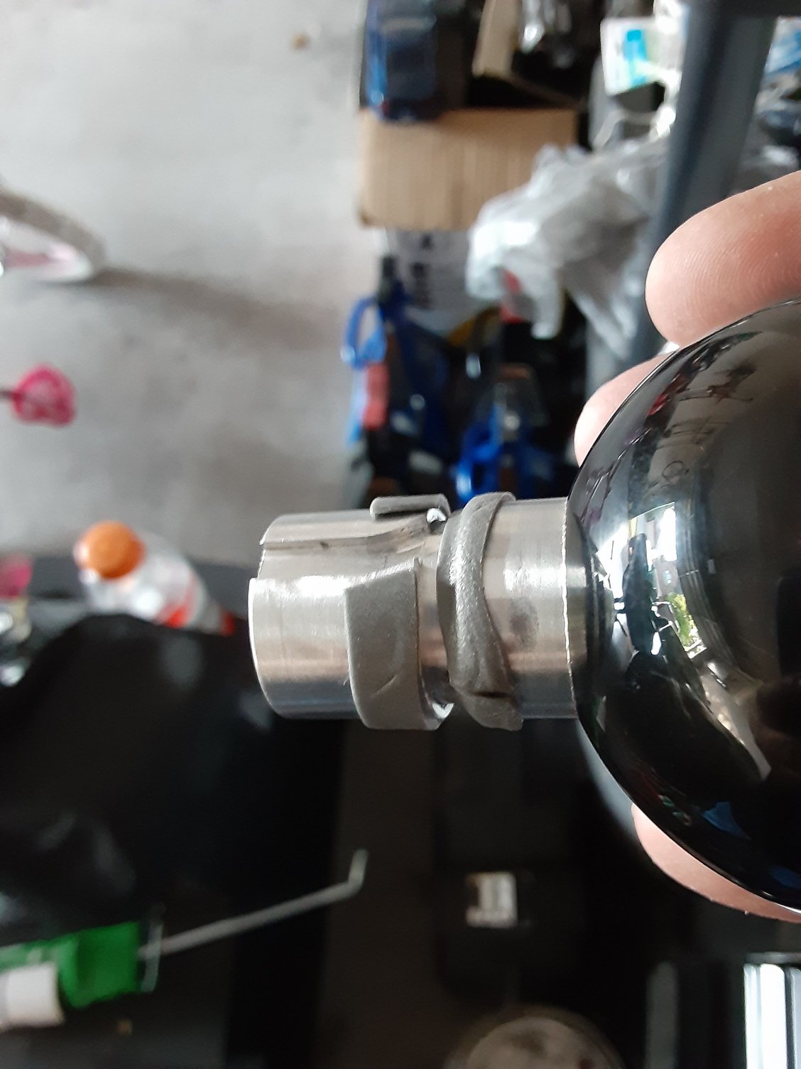

My little fix for the clicking on the ****. You cant see it when the **** is on. I used double sided tape, which stretches pretty well to make it thin. Put on **** where channel is at for the chrome ring and middle of shaft. The **** fits over nice and tight. Feels good shifting in garage no clicking. I'll see if it works when I drive.

^^^ it worked. Went for a quick drive with hard shifts and no clicking. Easy fix and something I had available in garage.

yep still good. Buy the double sided foam tape. Check out my picture . It is still working for me.. you have to stretch that tape out on the shaft so the **** goes over it. Its tight to get on

Tried with tape but rattling noise wont go away , so swapped back to stock for now and will return the RPI ****
The rattling noise is terrible and impossible to drive with it although it looked better and much shorter than stock ****

ok that stinks. so maybe the noise I had and yours are different. My **** didnt rattle. It was a clicking noise when I shifted. I don't have any vibrations. I guess that's why I was able to pinpoint the problem.
