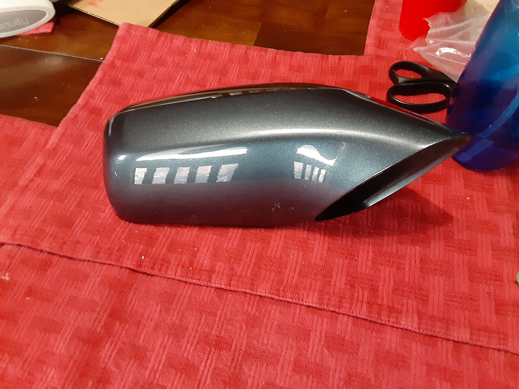

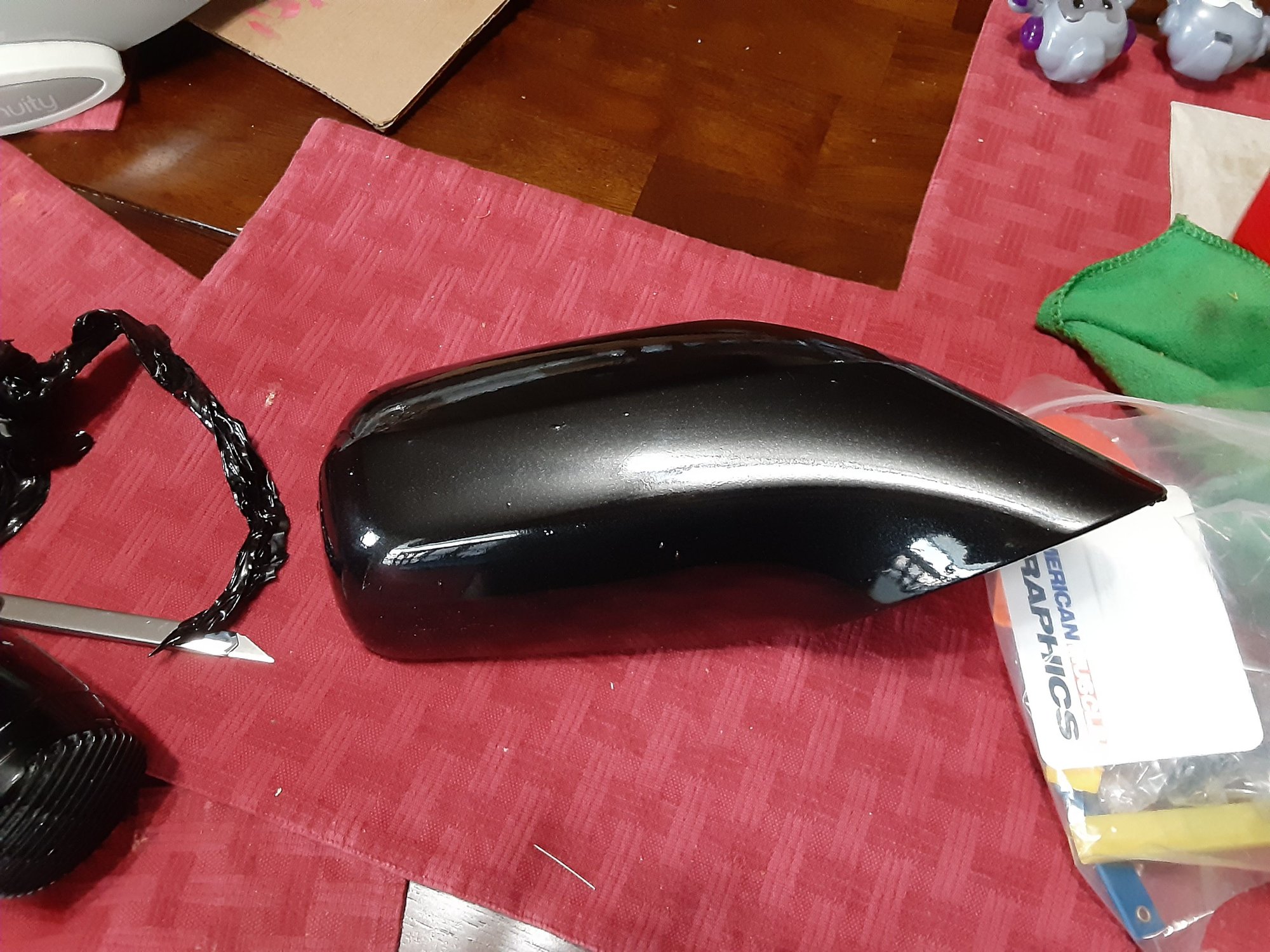

Well I have to buy more wrap. It is way easier taking off the shells. You could do it with one wrap sheet-and finger fu$$ the wrap and stretch. But not quite good enough yet so I'll keep trying. I am sure my next try with more wrap will be a success. Probably next weekend I'll be done. If I had enough wrap I would have been finished today. I got better after my 2nd try. But still had some small imperfections and I want it to look good.

ok, I did passenger side but not perfect. Still learning. I am good with it for now but gonna do driver side. If I am better with drivers mirror, I am going to redo passenger side. Here is first one.

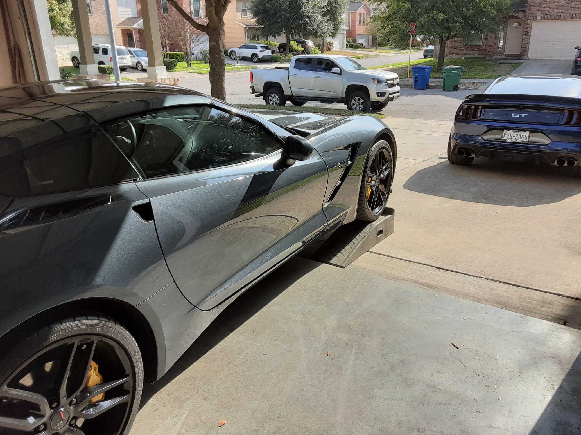

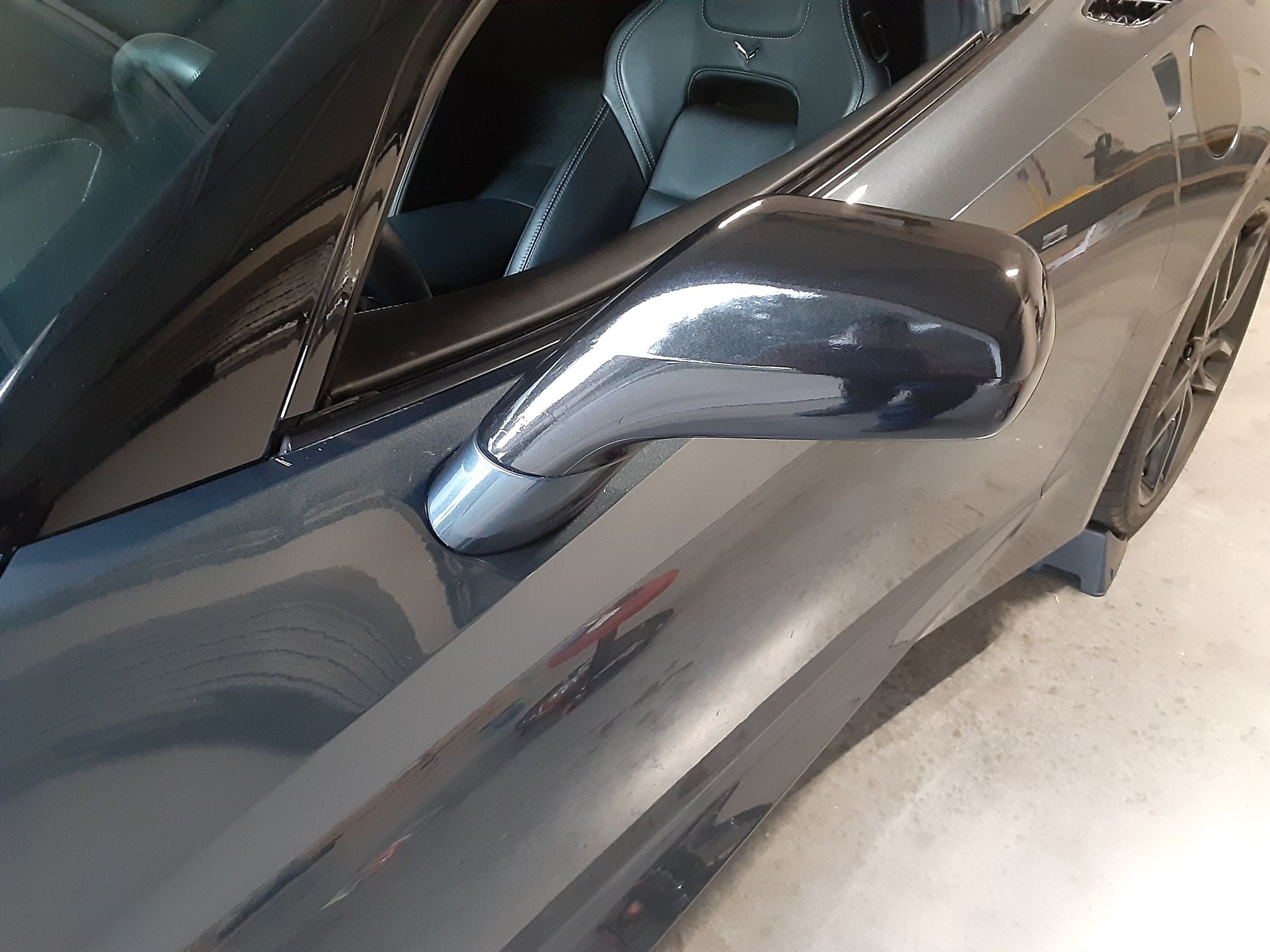

I finally got it down. Did the mirror wrap with the shell on the car in two parts, the very lower portion-underneath and then the rest on top. Took weeks to get the hang of it, and much materials . I'll be finishing it up tomorrow and will load up some better pics.

It's also easier if you raise the car. I had the vette on ramps, leading out of the garage, in order to get under the side view mirror.
