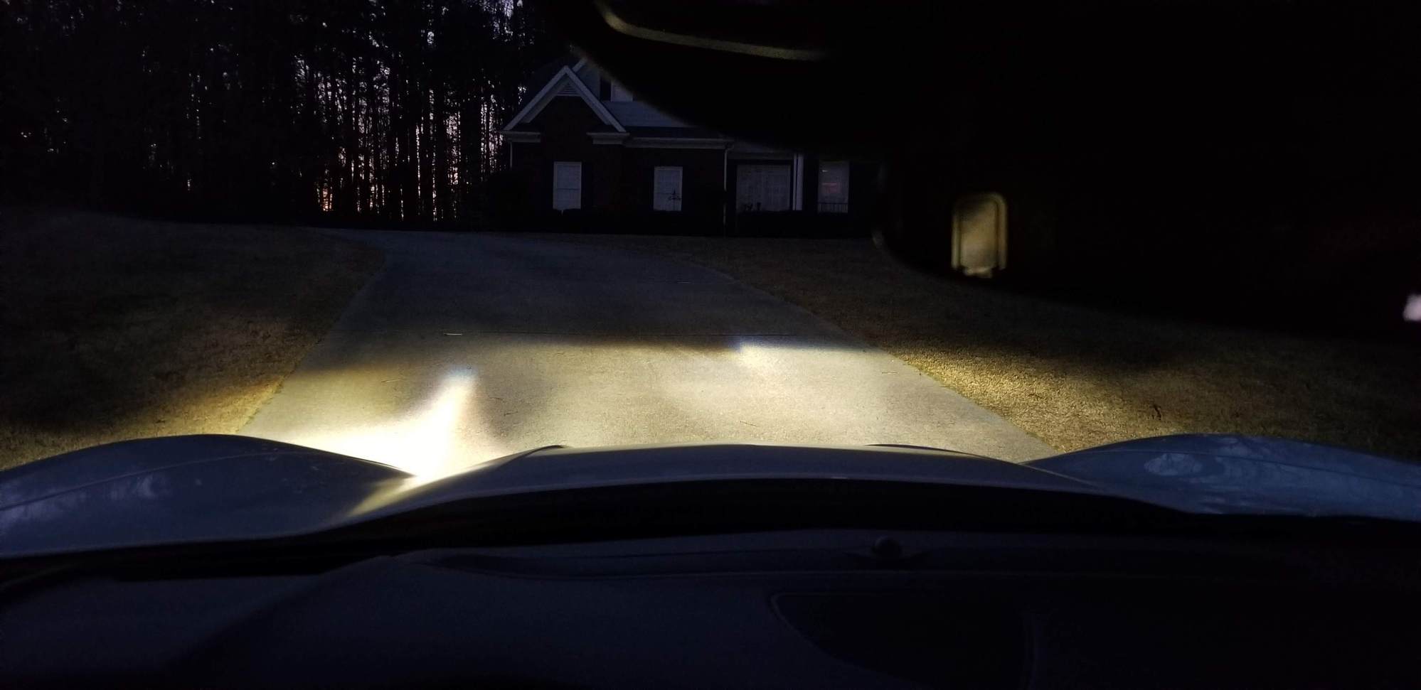

Anyone have a photo and/or video of their headlight beam pattern (preferably at night)? Mine appears a little odd after the bulb swap.
Thanks......

Here's mine.......

Originally Posted by carllangford
Here's mine.......
Looks like the bulb is not positioned correctly in the headlight housing because it is not seated properly in its mounting socket.
Thank you, finally a response that seems to agree with my 'thinking'........ Now we'll see if the dealer will actually go back in and to it right....... Or I'll be left dismantling the bumper cover myself which apparently I might should have done in the first place. I'm so tired of paying for people to do things wrong (in all matters of life)............
