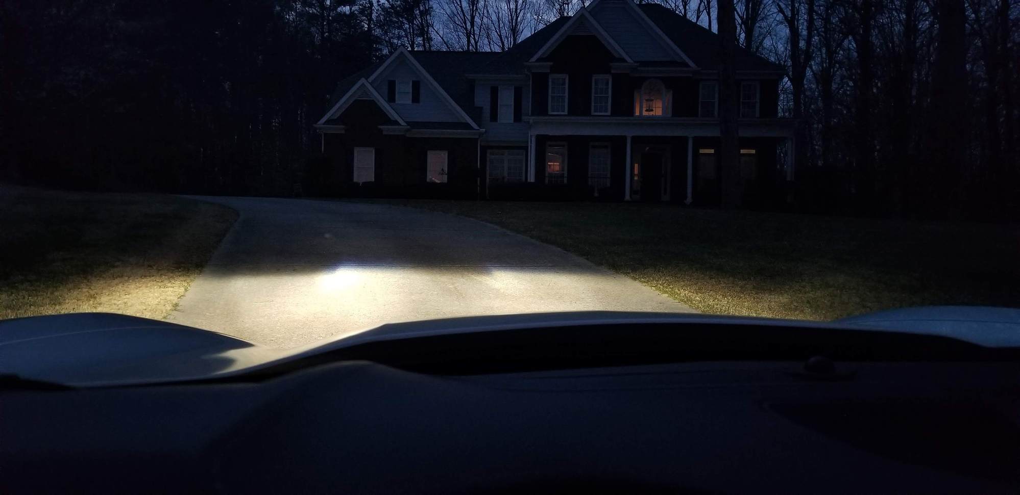

It's been mentioned in Post #35 and C5Kev seems to confirm that it is possible to install the bulb and it not be seated properly... That does seem to be my symptom (wobble of lighting on small bumps in road and what seems an incorrect lighting pattern).
I go back to dealer tomorrow morning for them to have a 'look see'....... I'll keep my social distance while I'm out... All jokes aside, this virus situation really sucks....

I sent in a couple photos ahead of time and they already agree something is amiss and will peel the nose off again and get it right. I dropped it off tonight to get worked on early tomorrow........
Let's see if they get it right this time.

Here's the "after".... Looks good now

From the work order:
CUSTOMER STATES SINCE HEADLAMP BULB WAS REPLACED ON LAST
VISIT DOES NOT SHINE PROPERLY AND SHAKES WHILE DRIVING AS IF
LOOSE IN THE HOUSING - PLEASE CHECK AND ADVISE
BULB LOOSE IN RETAINER
BULB RETAINER TENSION TABS LOOSE, ADJUST TABS FOR BETTER FIT
