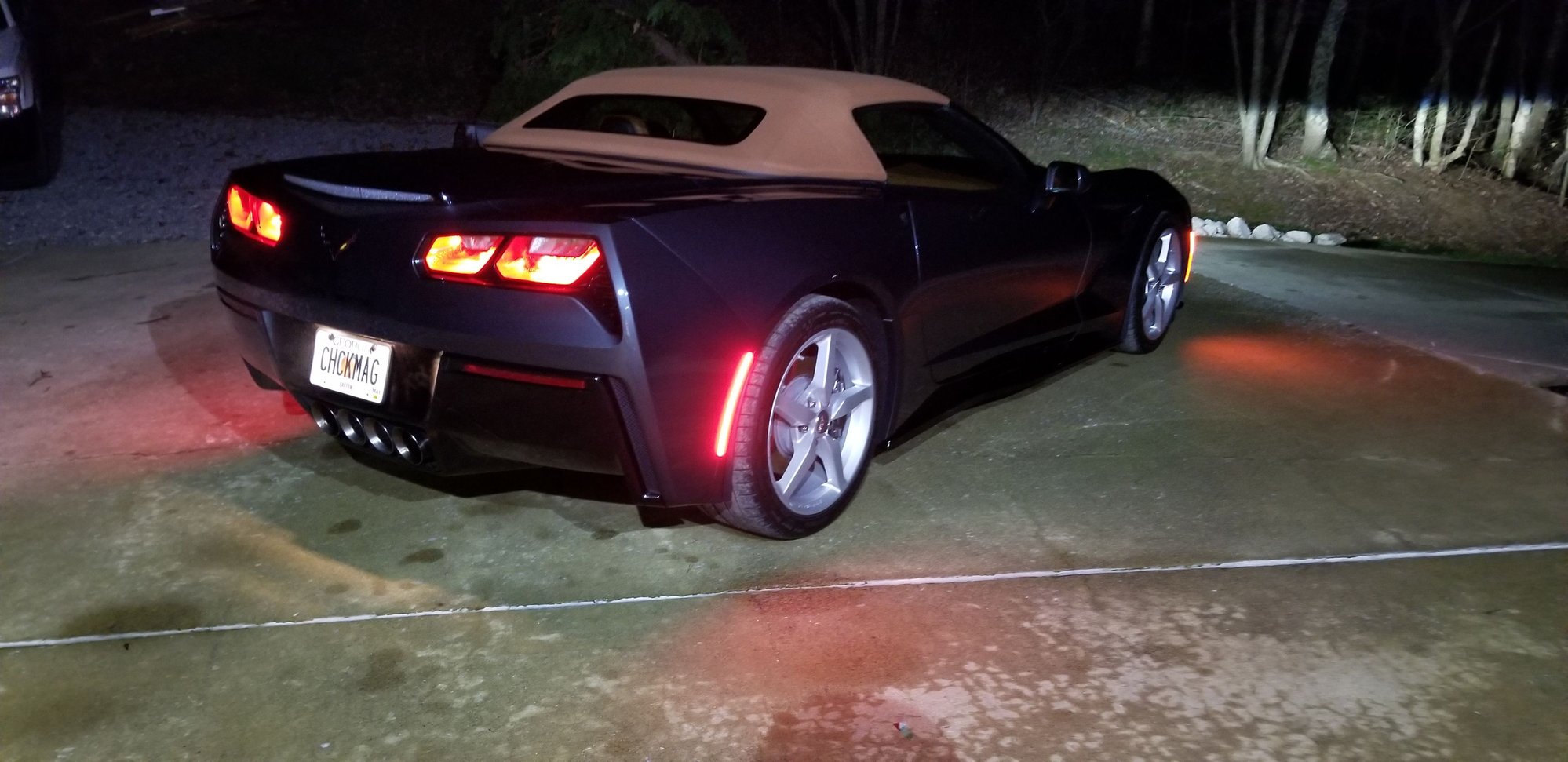

2014 C7 3LT Stingray (non-Z51) A6
Oracle sidemarker lights.
No issues observed.
I tried to study the Oracle, RPI, and group buy lights. You know retailers don't want head-to-head comparisons. The only real way to compare them is to buy them all and return the ones you don't use. I found a big difference in the warranties offered by each company and went with Oracle. I also talked to a guy at Oracle and he was either a genius at sales gimmickry or he really knew his stuff. You eventually have to trust somebody so I went with Oracle.
