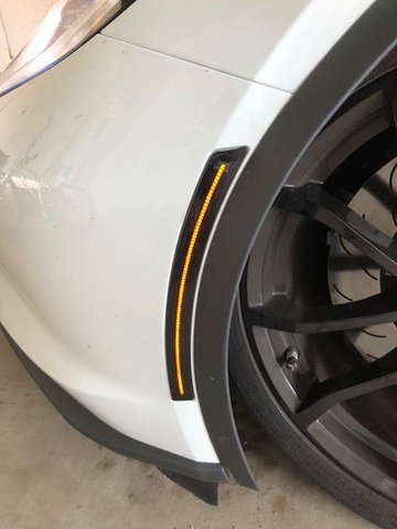

I went with Oracle Carbon Flash Ghosted. Really like them, they are not too bright, far better that the two bulb OEM (IMO). They do not throw any codes.
On (daytime, in garage):
