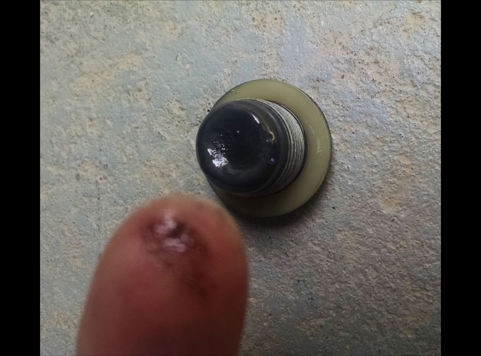

I brought mine in at 5000 miles to have it changed the tech came out ten minutes later told me it looked like it just left the factory and it would be a complete waste of money to change it. So I didn’t. Brought it back with 20,000 miles this time the service manager told me he and his tech looked at a sample they sucked out and that it did not need to be changed.
After the summer driving season I plan to have it changed whether it needs it or not.

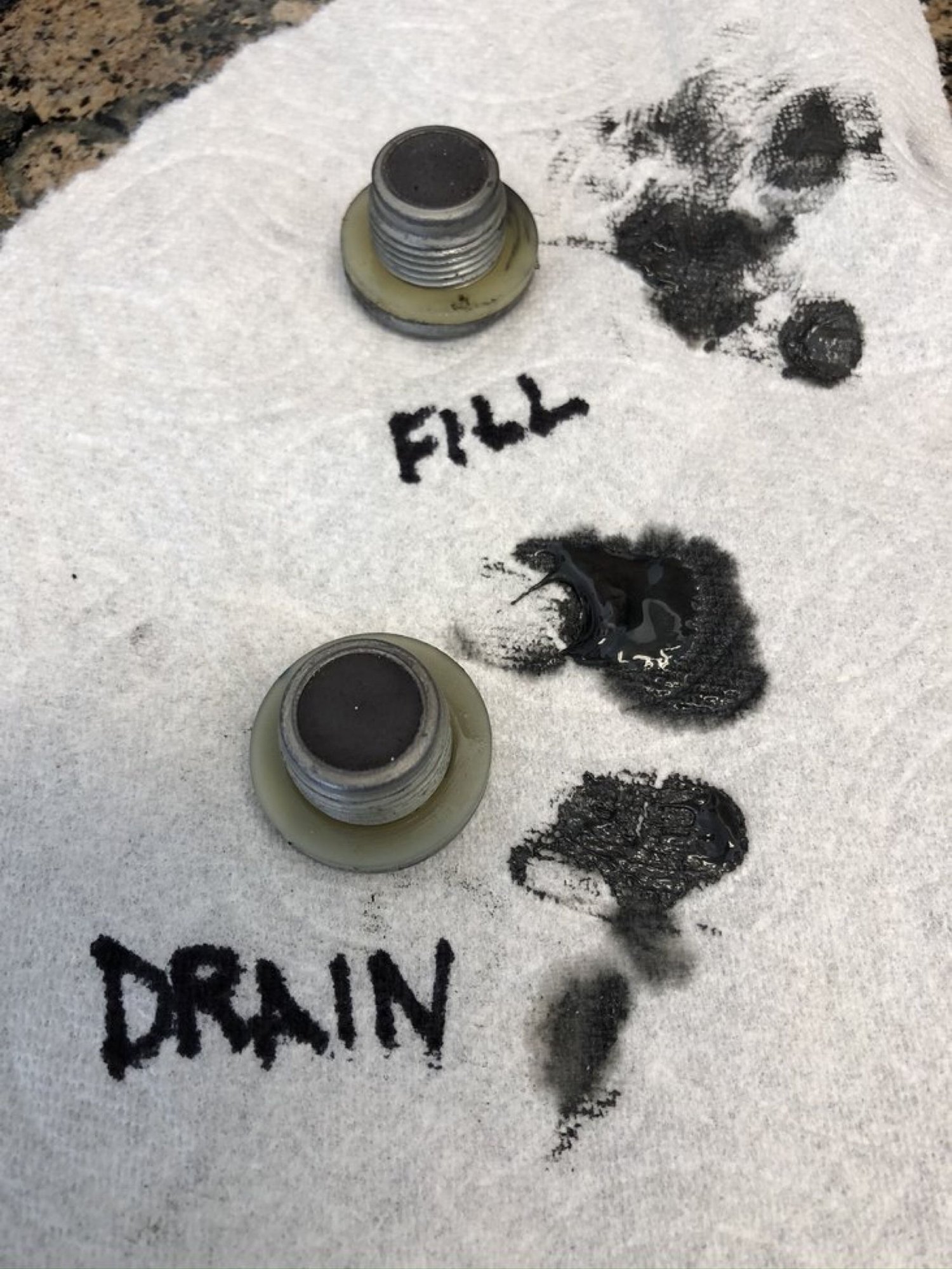

At 21k With the amount of Crap on the magnet so glad I did it.3quarts with pump from Amazon about 70 bucks.
3qrts out 3 In

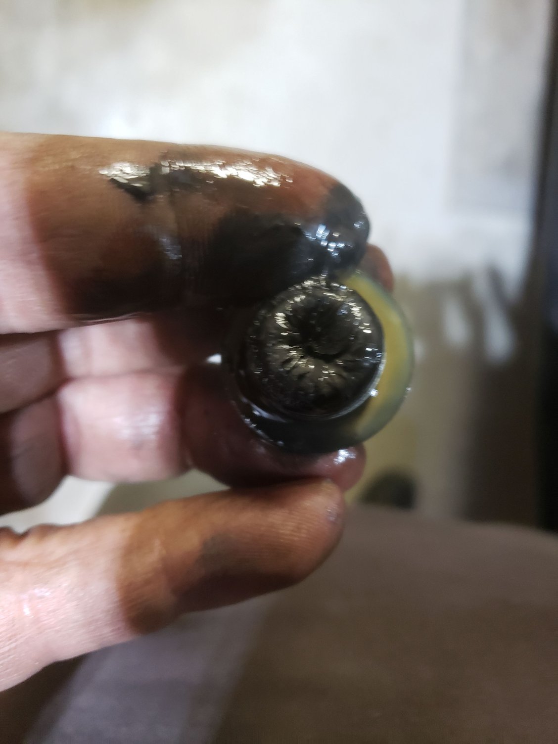

I did the same at around 600. There was grit and fine metal shavings on the drain plug. Oil color was mostly clean but has a layer of silver slime on the drainage bolt. I would recommend it to anyone before 1000 miles.You don't want that grit circulating in your gear box.

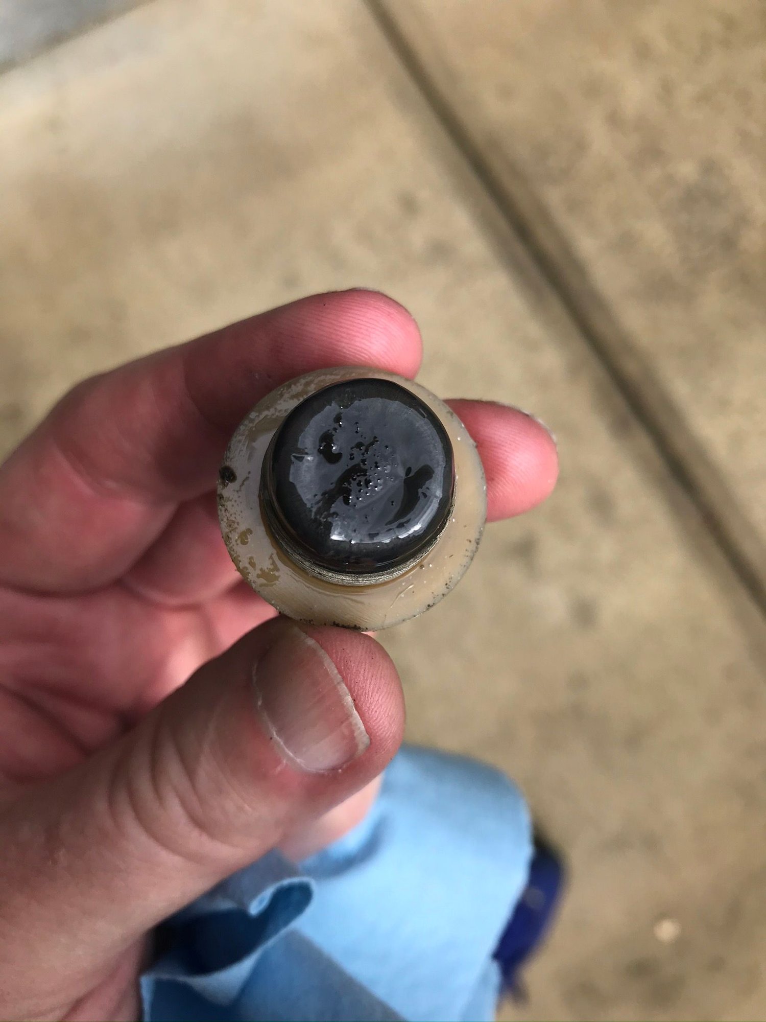

I did mine last weekend. I’ve got a 2014 vert in LRG w/ a M7.& 30k miles. I figured “why not”.
Both the fill & drain bolts were barely tight, but I had read that’s “typical”
Easy to do with 2 ramps + 2 jack stands for the rear. Followed the “sticky” to the letter ! 👍🏻
