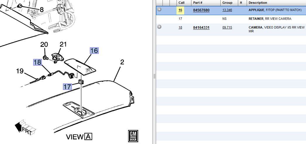

Just got a reply from Part Monkey, and they are looking at it for us:
The only camera I see listed separate is on the Convertible. I will include the Catalog illustration and part numbers in the attachment. I'll keep looking on the Coupe...I think we have a couple here to look at today.
If you look at the diagram, that (part number 16) housing may be just the ticket for some wanting to mount it on the halo?
I asked for pricing on those two parts, #16 & #18.

This whole time I've only been looking at the coupe. Mainly because there are a lot more photos and those are actually in private hands. I was using that as a starting point and then trying to come up with my own idea. I had just mentally tuned out the convertible.
Turns out the convertible setup is almost exactly what I've been envisioning for my car. I'm extremely interested in pricing on that bezel now. Looks like we might also #20 and #21.
The camera comes up in internet searches. $132

It's like a bigger version of a C7 halo. It's perfect.

More good information from Parts Monkey!
The camera has changed numbers to 84895800 which we sell for $133.59 on
Trunkmonkeyparts.com . The Applique does not have pricing yet, and there is no inventory on it yet. Should be available after the first run of new convertibles. Keep checking it on the siteMore info from Paris Monkey!
