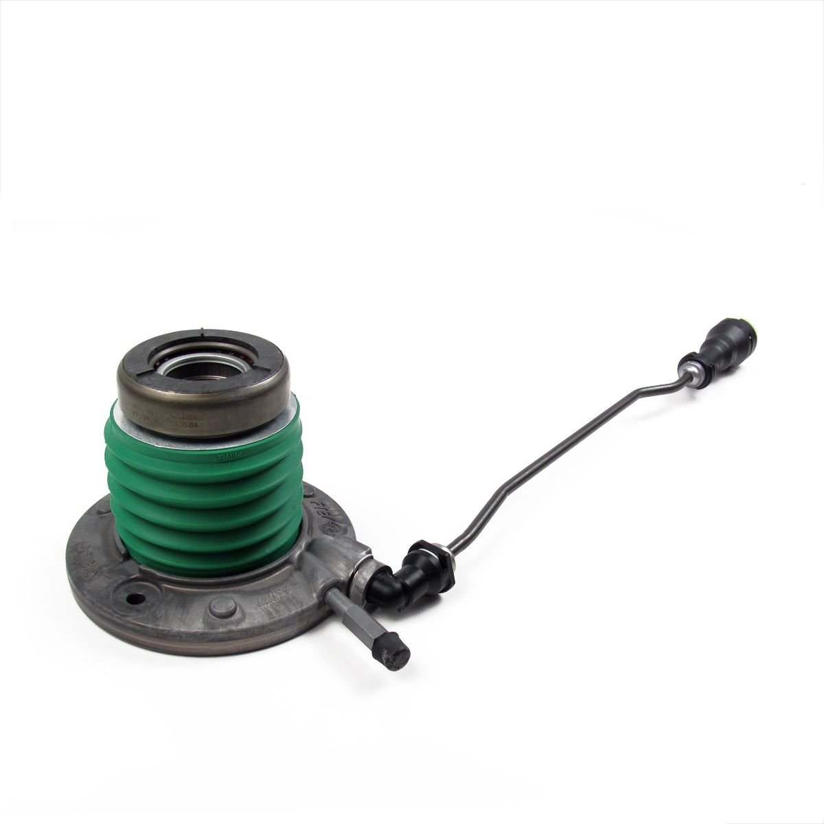

This is where the bleeder is. I'll try to get a close up photo when I go back down there tonight.
This is the slave cylinder. You can see how the bleed fitting extends inward to the base flange.
BTW, beware of the dust cover. I pulled mine off and promptly fumbled it inside the bell housing. It got caught on one of the torque tube bolts, and didn't fall through to the bottom. Fortunately I have one of those little inspection cameras, so I was basically able to do endoscopic surgery on my car. I was able to use a zip tie to knock the dust cover down so I could pull it out of the vent holes in the bottom of the bell housing. If I had it to do over again, I'd wad up a shop towel before I pulled the dust cover off. I'll probably do that when I go to put it back on.

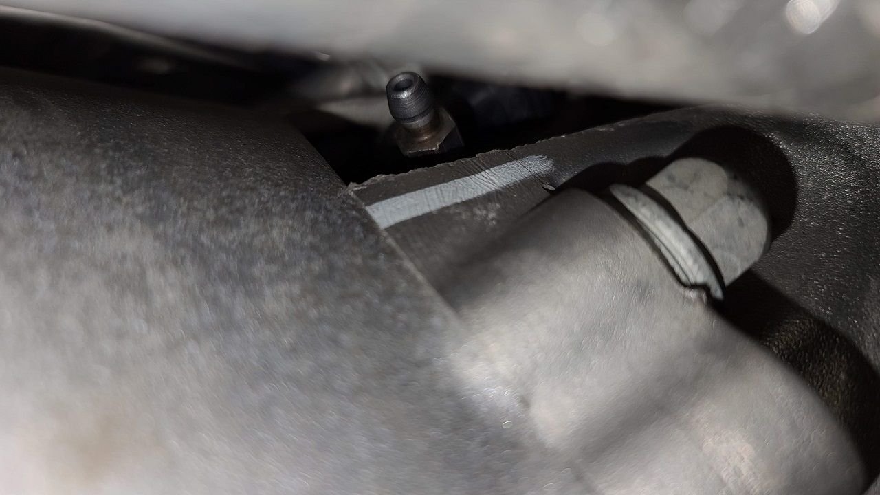

I tried to get a better picture of the bleeder, but I my phone just wouldn't focus when it was so close to the torque tube.

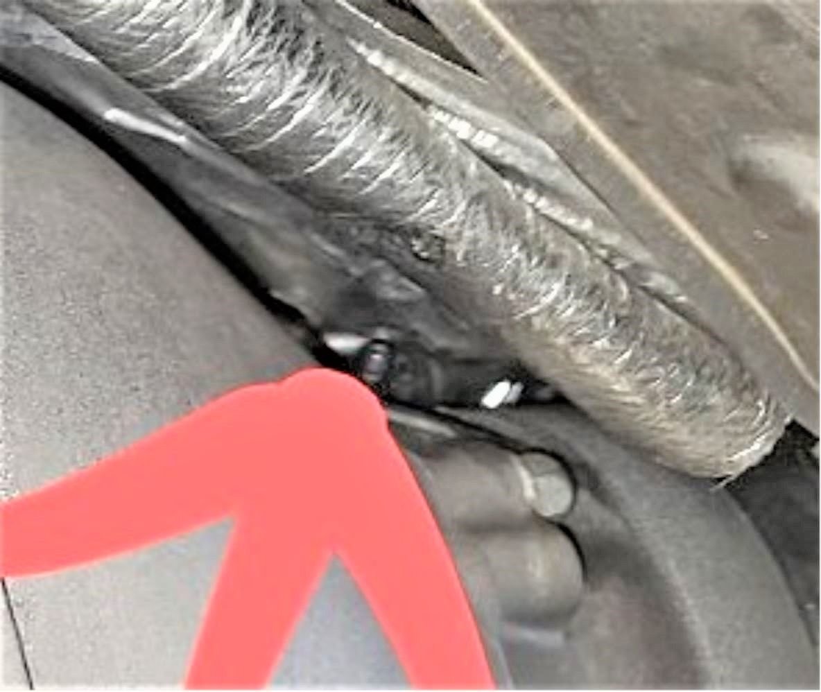

Jeff, thanks for posting this great info. If it's not too much trouble please get a pic of the place you applied the pry bar to get that little bit of extra clearance.

The work around for that is to get the photo like you did where focus is OK, then crop it, like this. I just cropped yours on my laptop. Alls this would need is more light... so I used the photo editor to brighten it up a bit. Most phones let you do the cropping in their native cam/photo apps. It is especially easy with an iPhone.

This is as physically close as I could get. It's less about the distance than the angles involved. I can't get a higher angle that shows the top of the torque tube because there's just no room to fit anything up there.

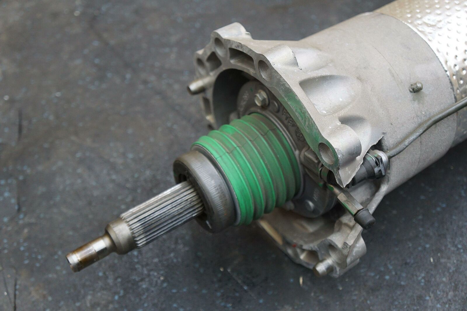

Here's a good photo from an eBay auction.
