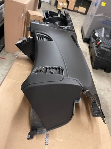

WOW my new GM dash just came in. It is a much larger piece than I was expecting. Anyone considering a repair I would again reach out to a GM dealer to see what they can do for you. The replacement piece being installed in my car I LOVE way more than if I was to just repair the issue. Wasn't aware it has the piece between the blue section by the heads up display too. That part is bubbling on my car too but I thought that was a separate piece. It has more metal framing than I was expecting, also includes the back cavity for the touch screen. I feel much better on the price now that I saw what is being changed out. Wish I would have taking a picture as again you get a very large section.

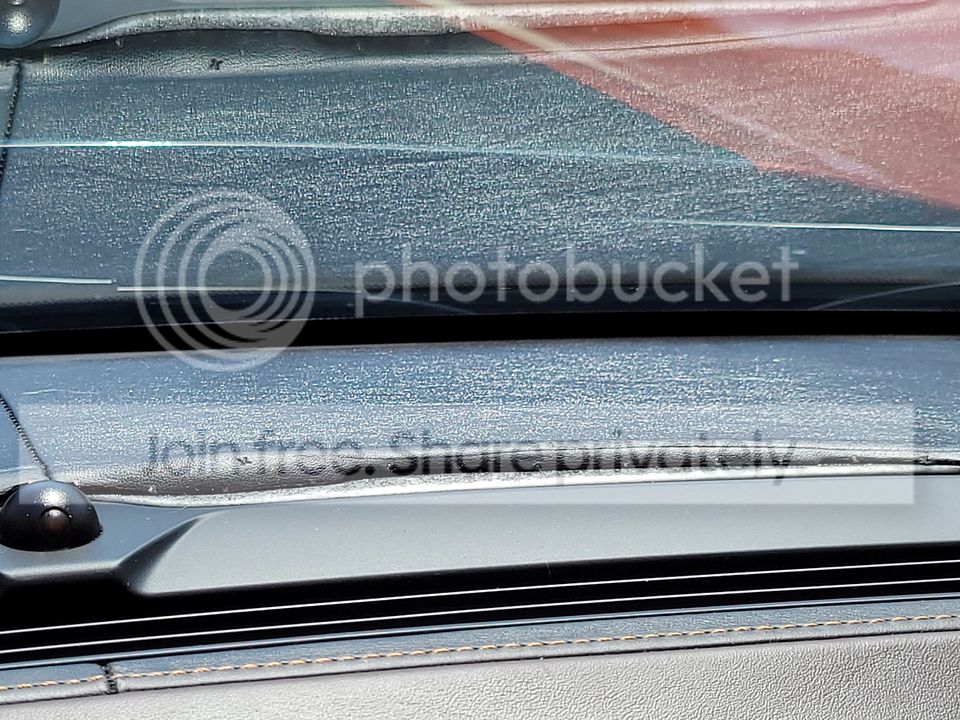

Just a few pics of the dash from GM, wow no way I would pay the same money for a repair to my existing dash. Also I was surprised how bad my section by my hud was. Nothing like the picture below. That alone was almost worth it for me. Good luck to all those out there that are still dealing with this issue. Anyone who gets push back from their dealers should try another place until you find one that will provide GM assistance in replacing the whole unit. Clearly GM is still offering some assistance with a issue that they should have recalled and fixed everyone of them from the start. Good luck.
