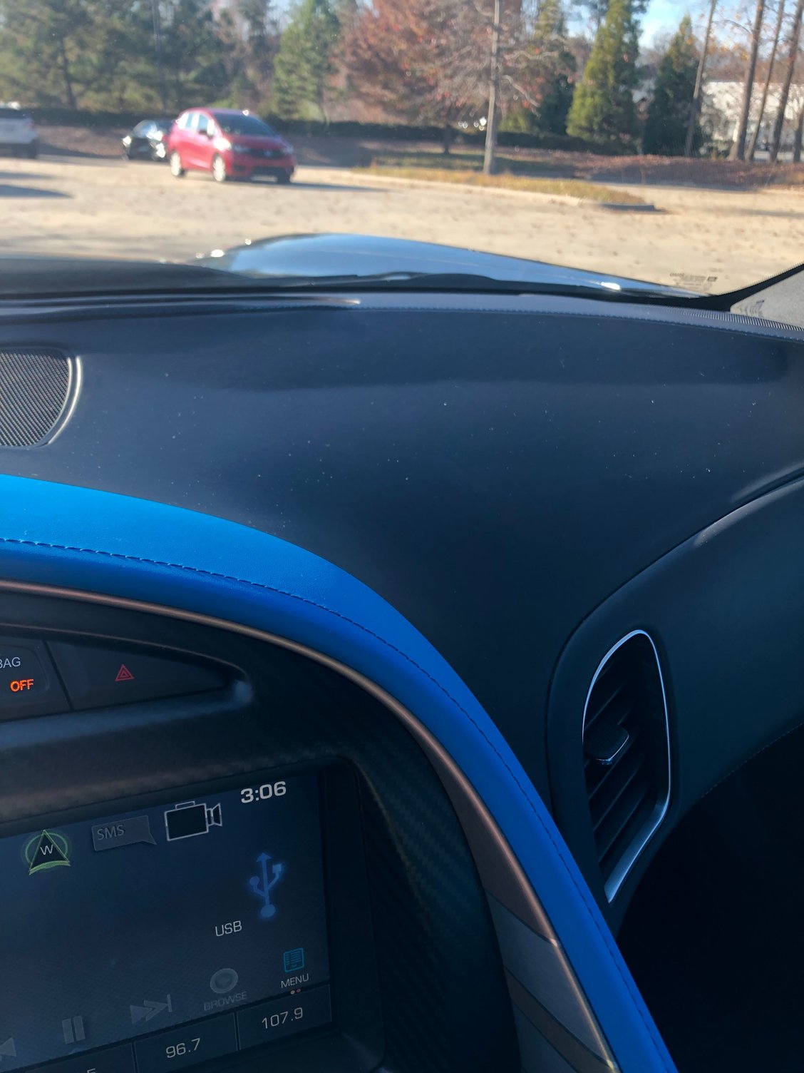

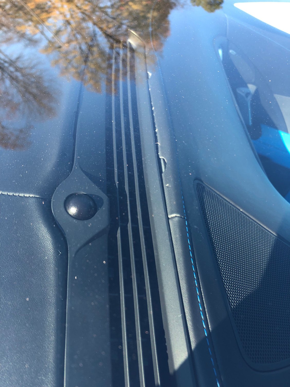

I would say you should look at the multiple pictures on this forum that clearly show shrinkage in addition to glue issues. here's mine. Be aware you have glue issues today but maybe not tomorrow as many have seen both (I have too). Also you can get a brand new GM install factory dash pad for less than you are getting that repair. Mine is less and already ordered on a 2017. Let us know what you do but I hope you slow down a minute to check other options (hoping that is why you posted this to start with). Good luck and tell us how it goes. I'll do the same.
Mine looks like the bottom picture with a small bubble in the HUD?
No cracks no peeling just the bubbles.
If I go for a GM replacement what is to keep it from having the same issue? iie. The GS/Z06 wheels.
I have not seen a TSB on this as mentioned above??
I'll check with my local Chevy dealer and see what they say?
My dash issues were identical to yours. I had it replaced with a new dash at the dealership under warranty. So far, so good. The dash was dismantled and the windshield was not disturbed. For the OP, the GM process doesn't call for removing the windshield for a dash replacement. Removing the windshield is exclusively a leather repair shop short cut. Also, my service manager refused two flawed dashes from GM before accepting the third.
