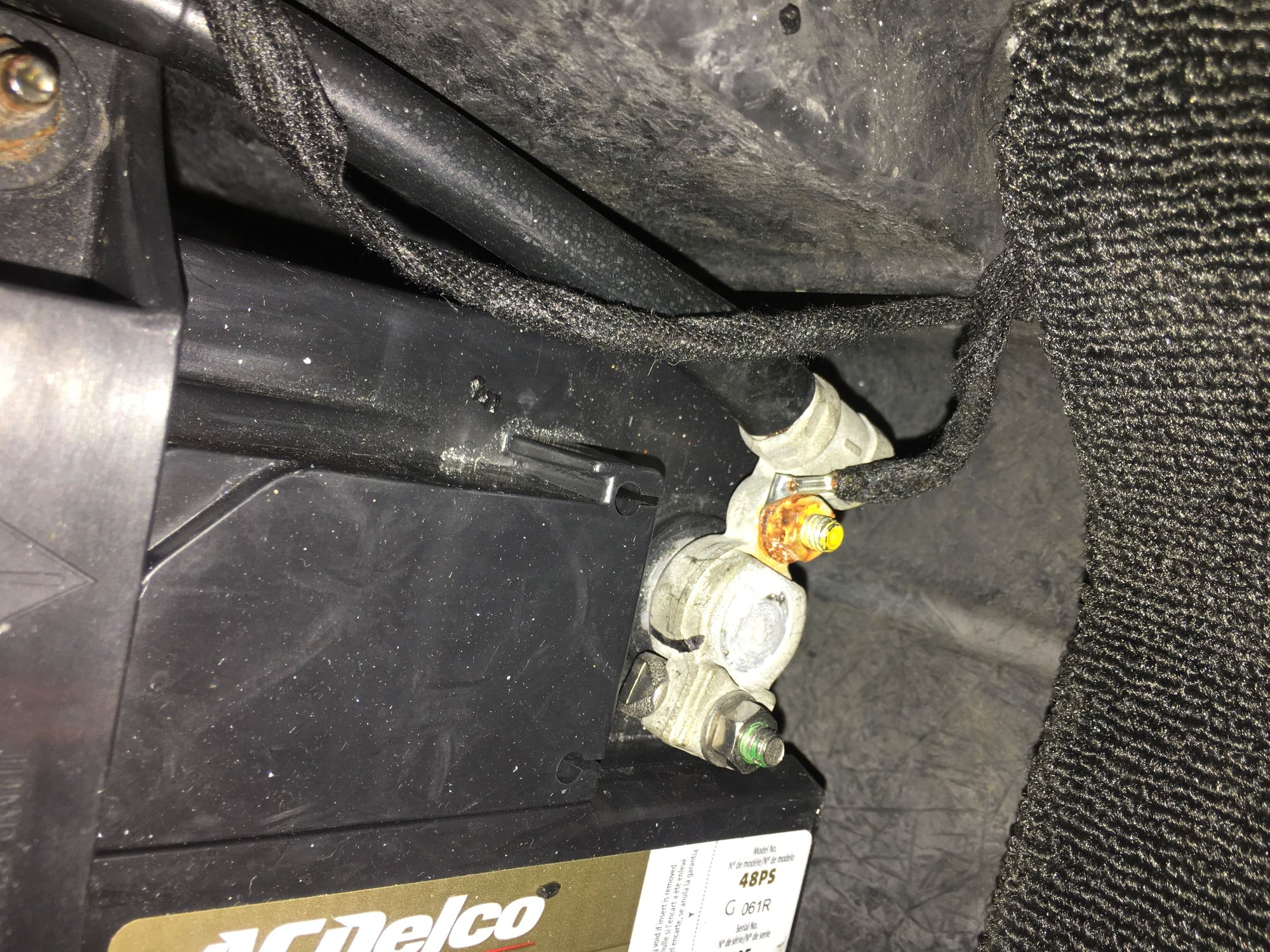

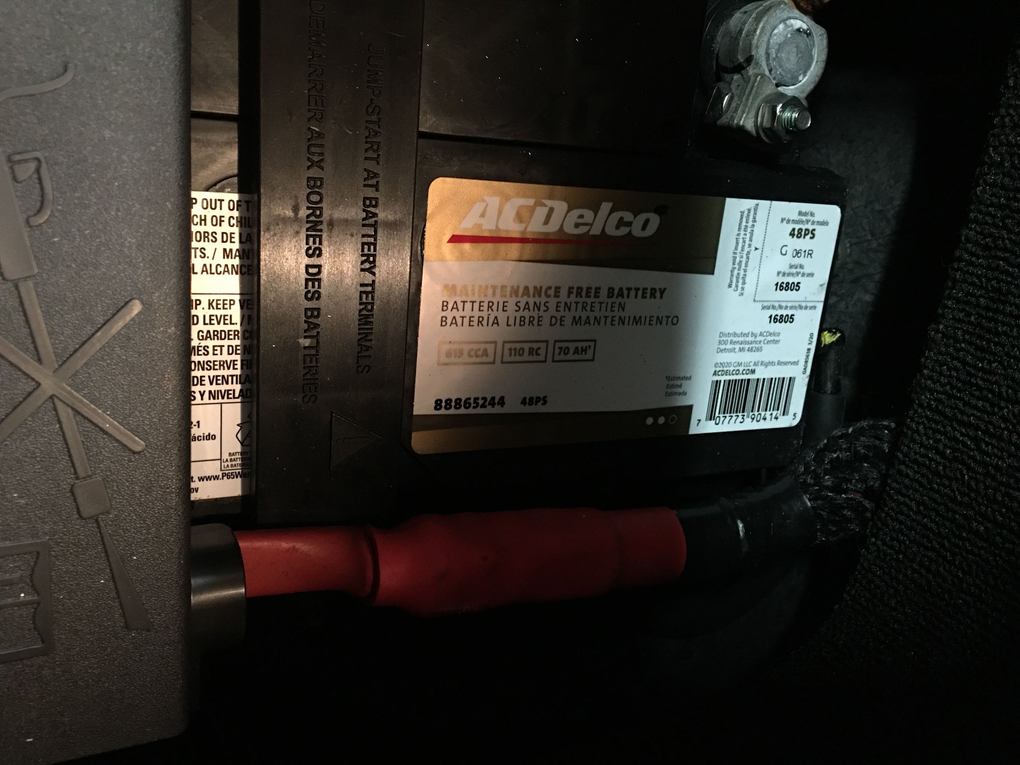

Here's a pic of my dealer replacement battery from June 2020 and it looks like the same model/part number, but sticker just looks a little different. I recommend cleaning the rust off the neg battery terminal though.
Yours is a Professional Grade AC Delco Battery, 42 months, and that is why the Sticker is different.
I always put the felt pads with the gunga on them when they are new.
As, has been said, I would get rid of the corrosion on the terminal and check to make sure the vent tube and elbow are there.

Not only is there noting wrong with them, they are excellent batteries. I literally bought, sold, warrantied thousands of them through my auto parts. In fact, I sold Exide, Deka and Delco, which all are good batteries, however Delco had the lowest defect ratio. A battery that matches or exceeds power requirements specified by the vehicle's manufacturer, vehicle's charging/starting system has been and is in good condition, battery trickle charged (battery tender) when stored, installed in a vehicle used/stored in a moderate climate should last 5-6 years. As I stated earlier, I'd be more concerned with the corrosion on the ground stud/nut than the battery.

I've cleaned the corrosion from the stud on the negative cable terminal, and I've found that I have a vent hose in place and attached. I didn't know to look for that when I checked out the battery the first time. Since it's a 30-month battery dated 2020, I suppose it could be as old as 23 months, or as new as 1 or 2 months. I don't plan on buying a replacement just now, but I'll be ready if the need arises.

Both the year and month of manufacturer will be stamped into the battery casing someplace, typically on a side.

Noticed the corrosion on a nut on the ground. There is a hose and fitting om the battery vent and a plug on the other end that vents to the outside of the vehicle. It may not be hooked up.

FWIW, went to the dealer today to get a battery and this is the ONLY one in their system for the C7. Maybe it has changed over time but this is the one I bought today.

As a follow-up to my original post, just the other day I received copies of some records from the prior owner's service station, and the battery was installed last July. I should be good for a while.

It is my understanding that the datecode is the 061R that you see on the label. 06 being the month and 2021 being the year (last digit). IF that is true its a June-2021 battery. : )

That would be good news!
