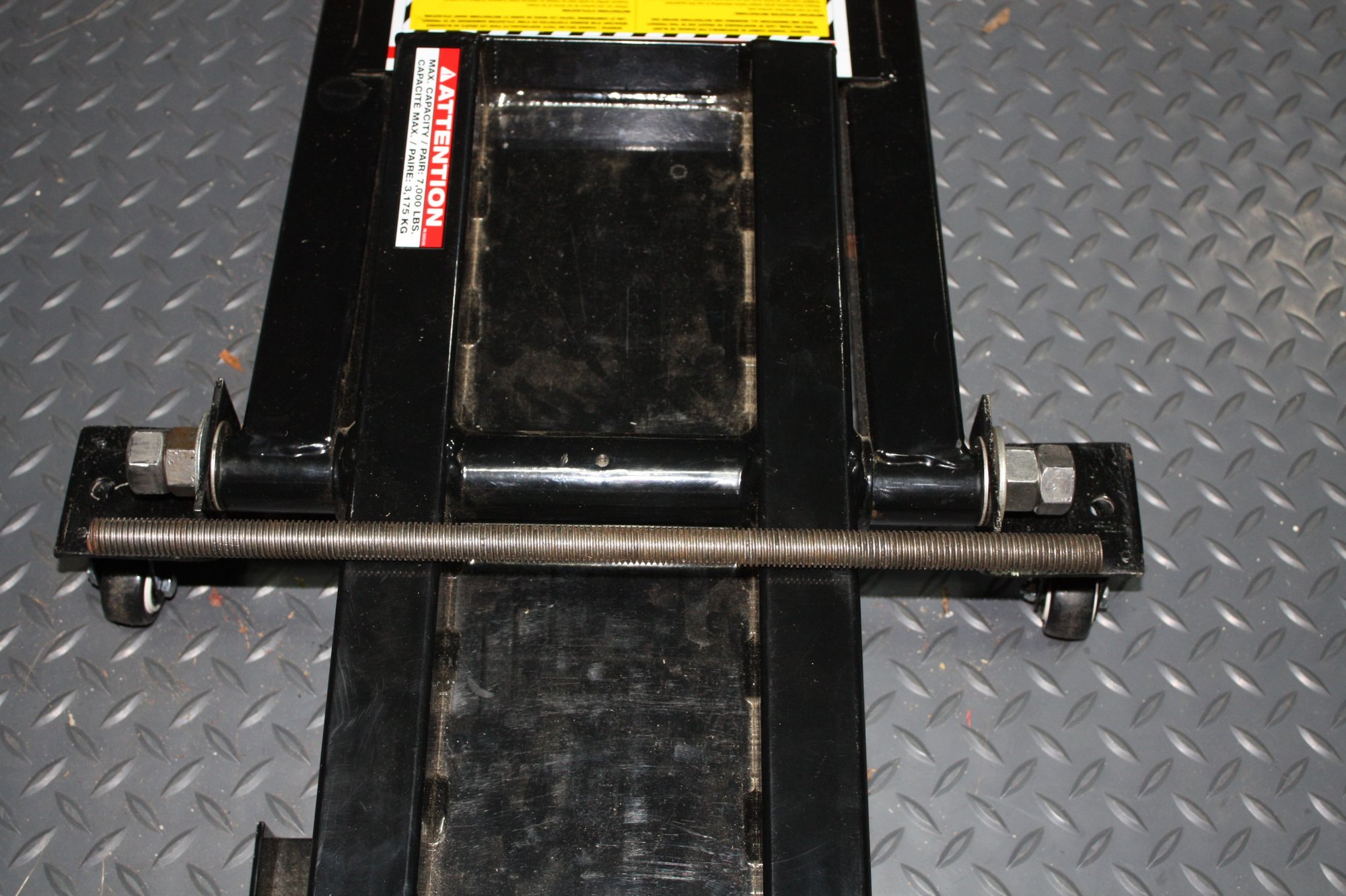

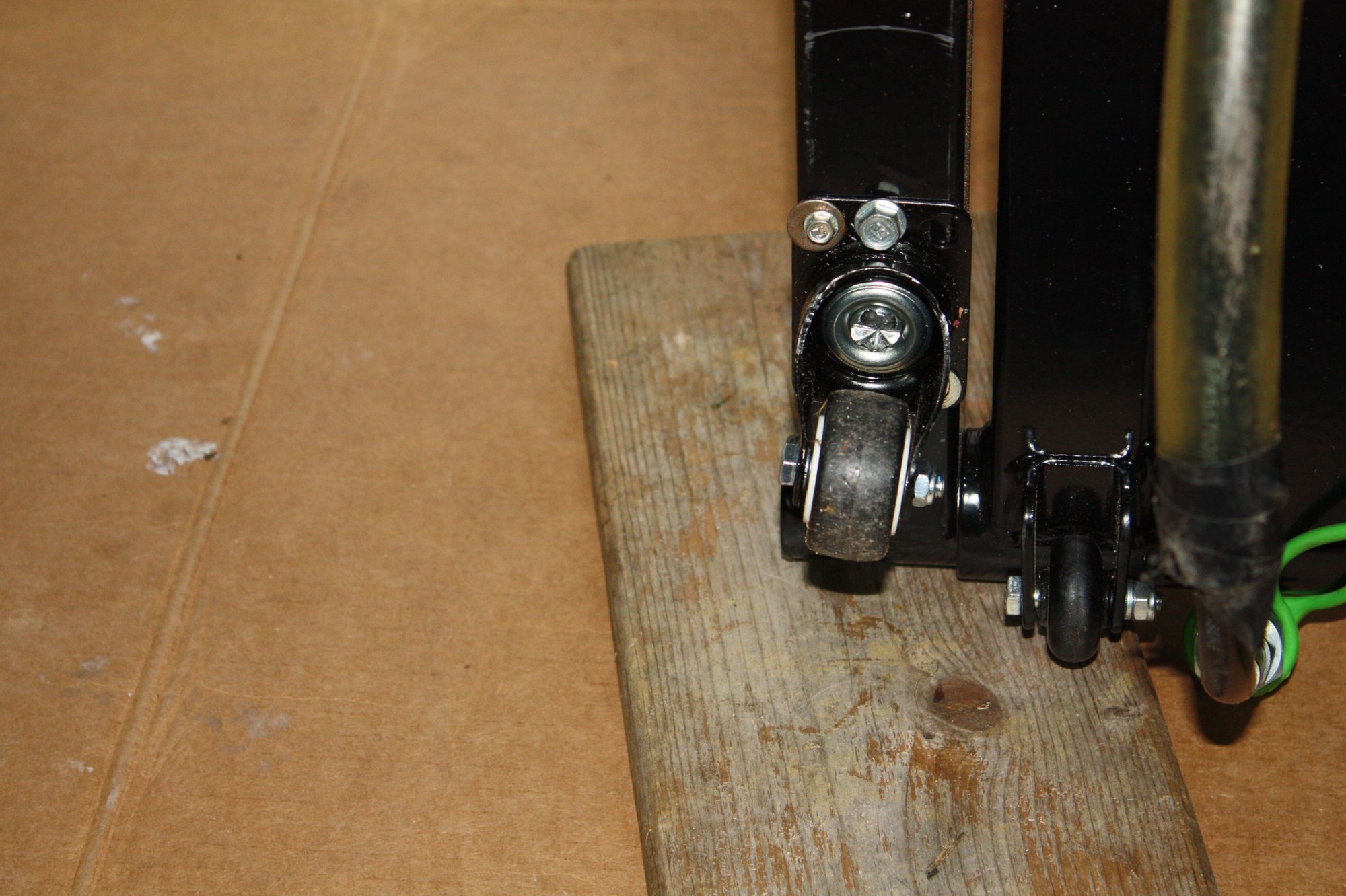

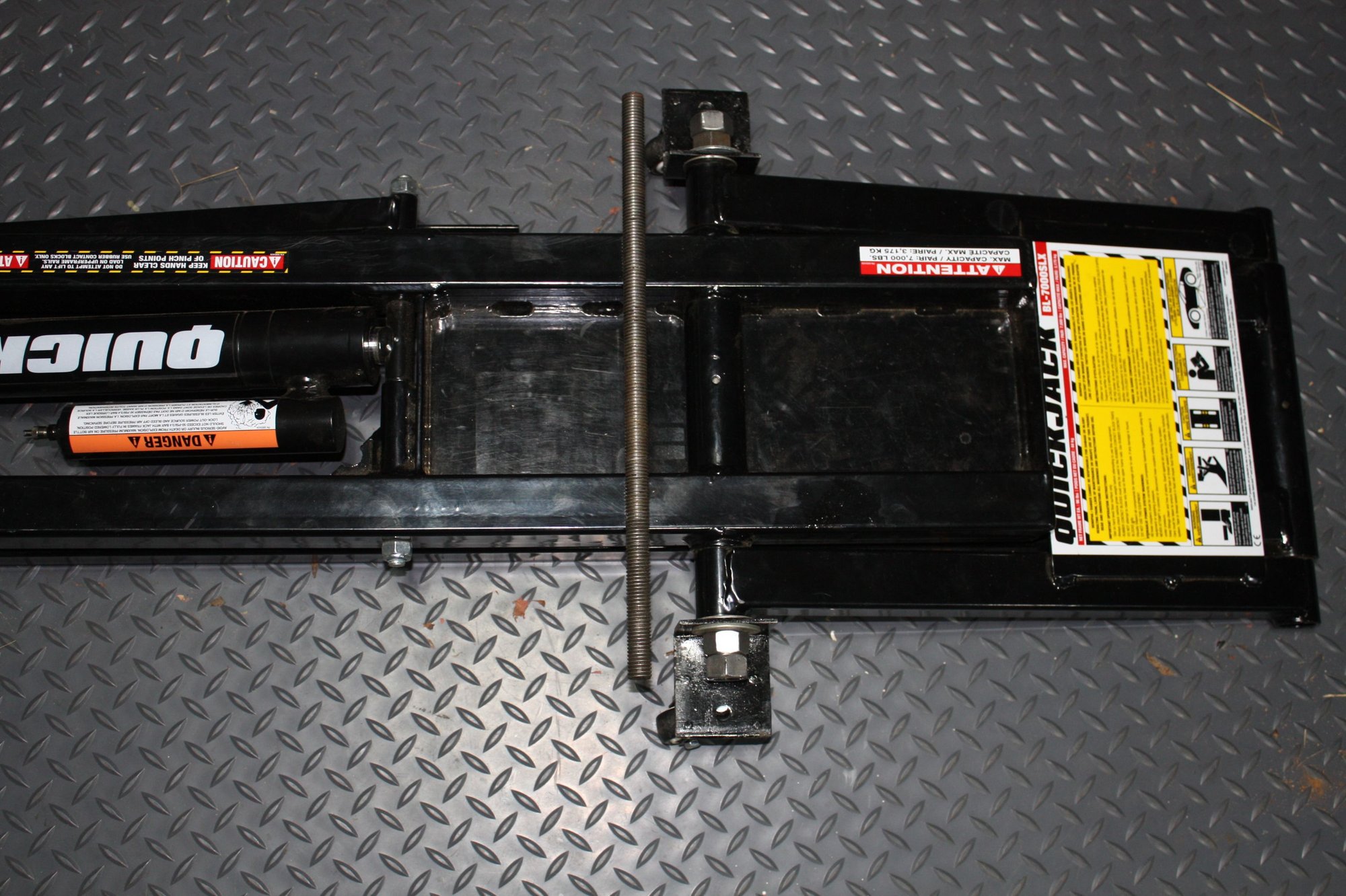

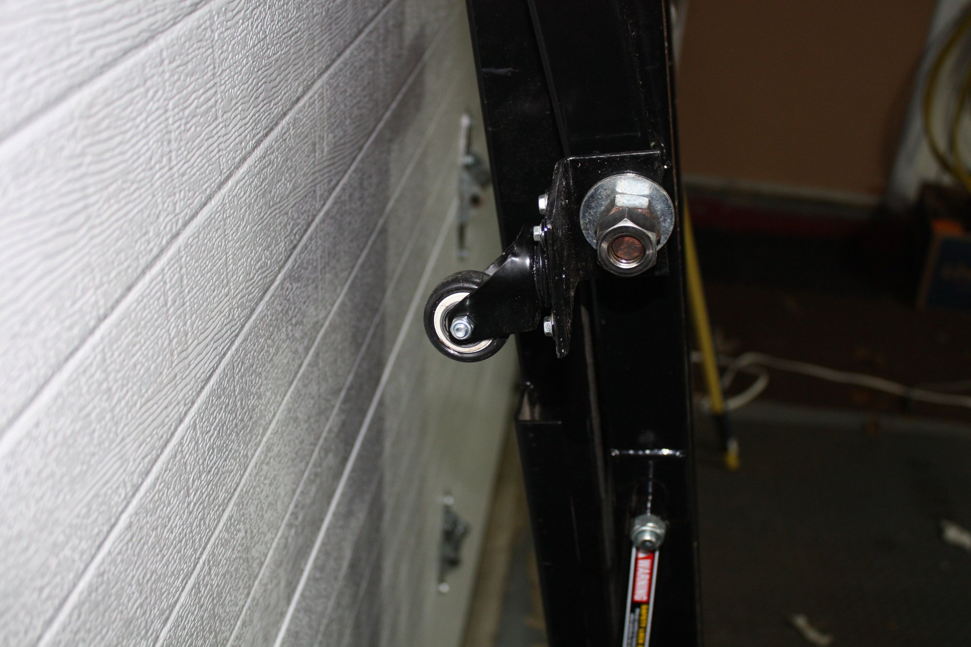

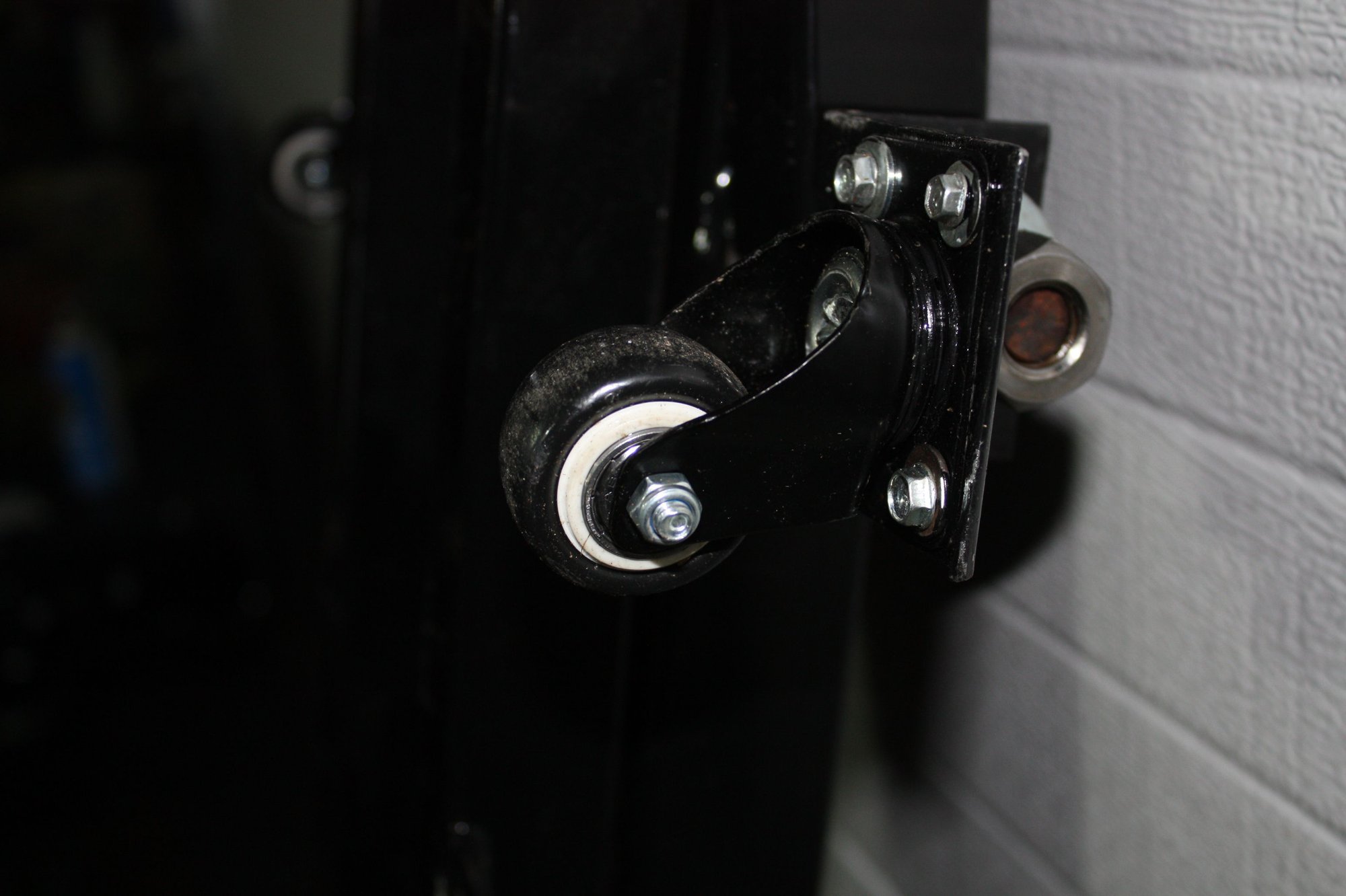

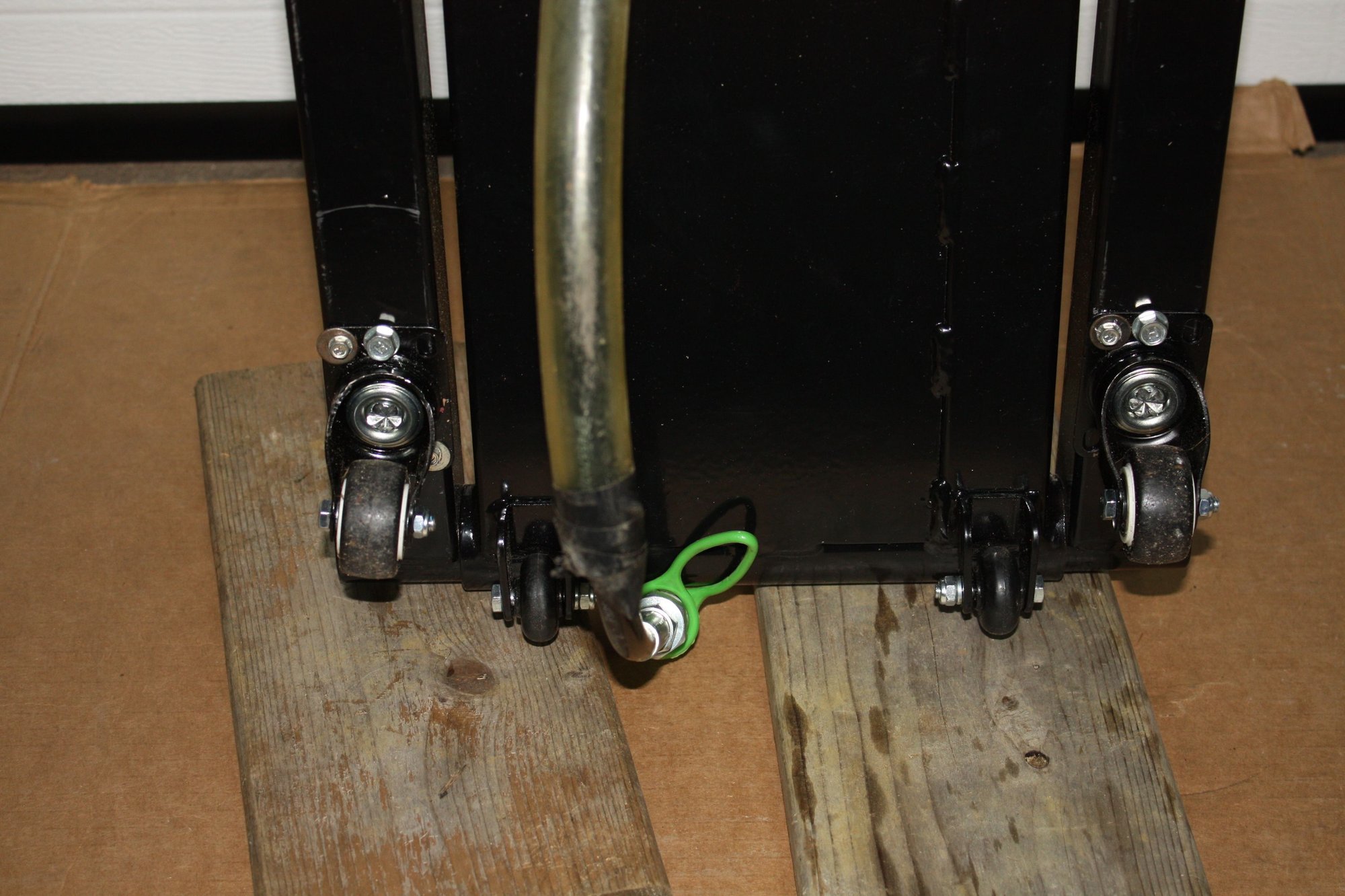

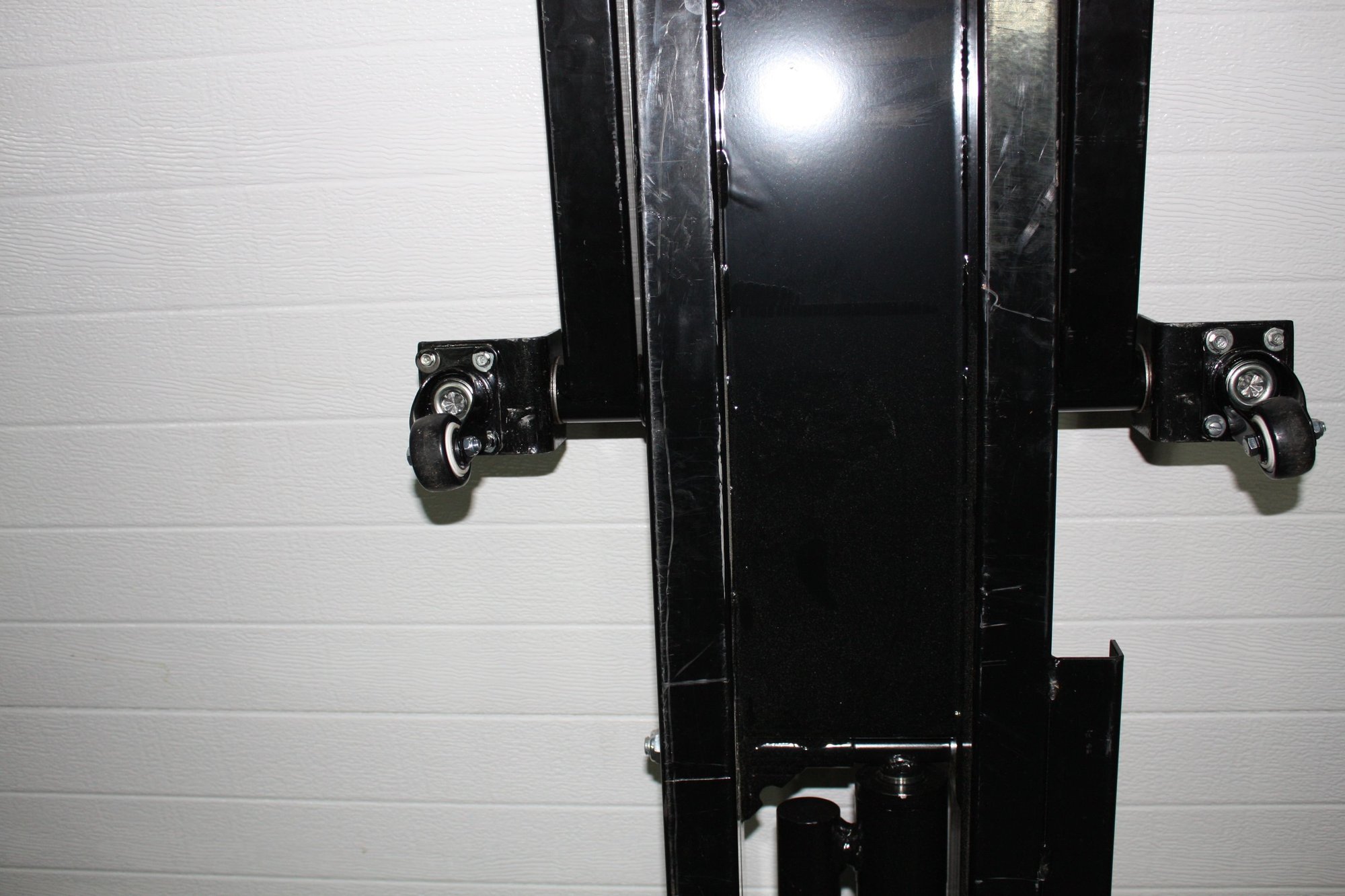

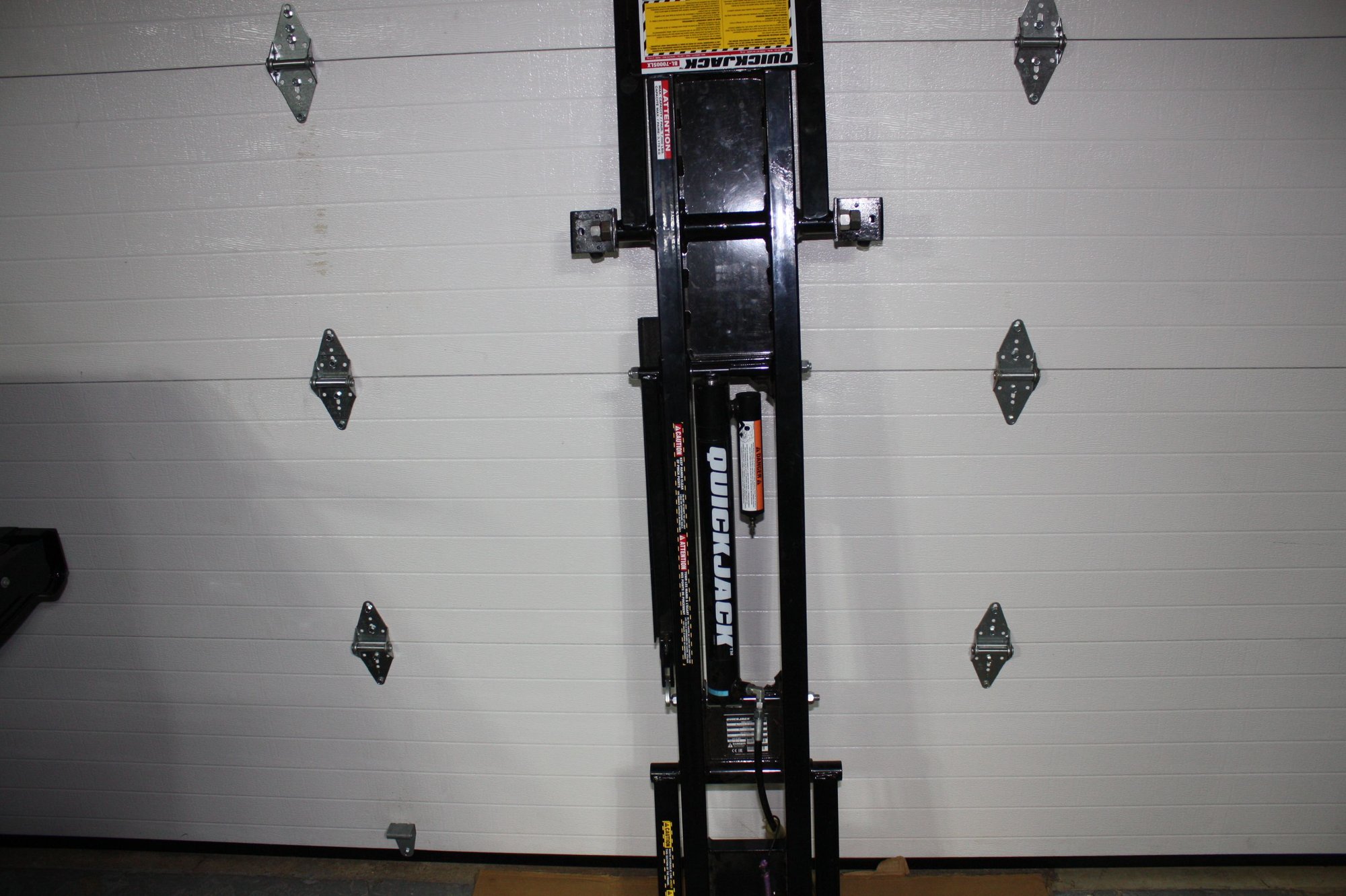

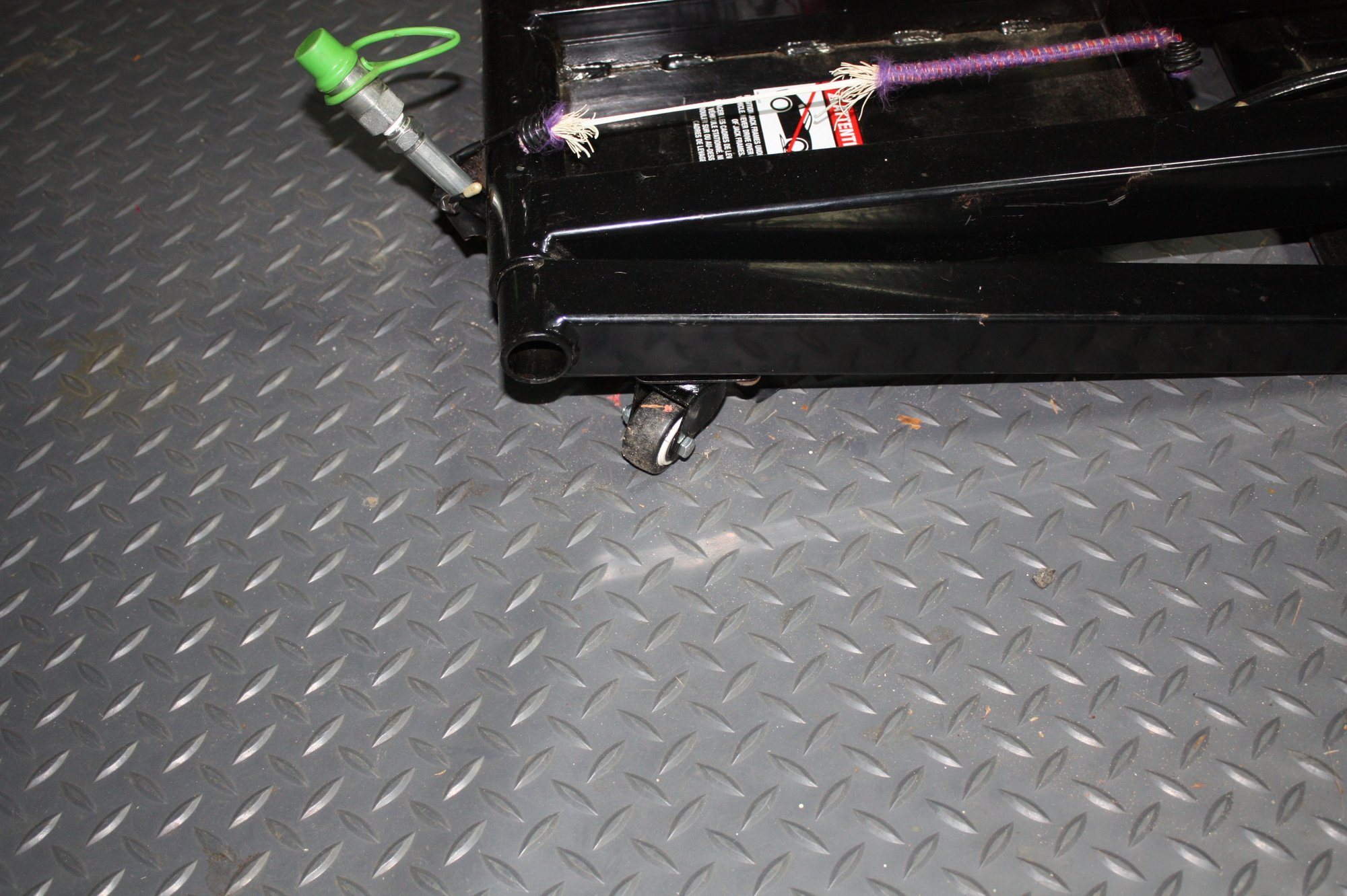

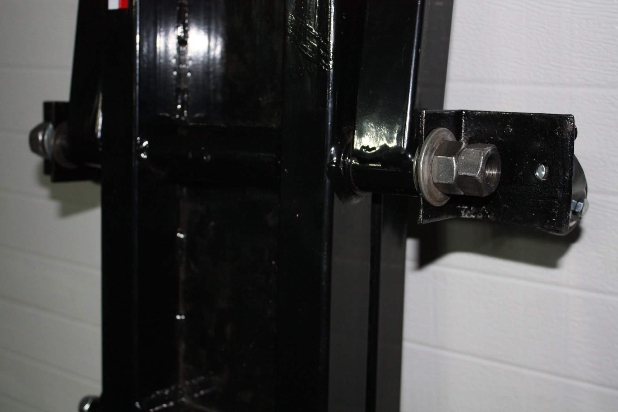

Can you post a picture showing how/where you added wheels to your QJ? TIA…
Old Dec 19, 2021 | 08:58 PM
Vette Ski's Avatar
Vette Ski
Joined: Jan 2019
Posts: 2,769
Likes: 1,116
From: Howell N.J
This was a mix of what you see on you tube and my own creation. I used a 5/8" threaded rod ( overkill ) 1/2" would suffice, 15 1/2" long . I just happened to have the 5/8" laying around. I used 1/8" steel and bent it 2 3/4" long for the wheel mounts and 1 3/4" long to mount to frame. I purchased the wheels on Amazon
I mounted the ( 2 1/2" ) high wheels 2 1/2" from the end by drilling into the frame and using self tapping heavy screws.
Hope this is helpful,
Rich
