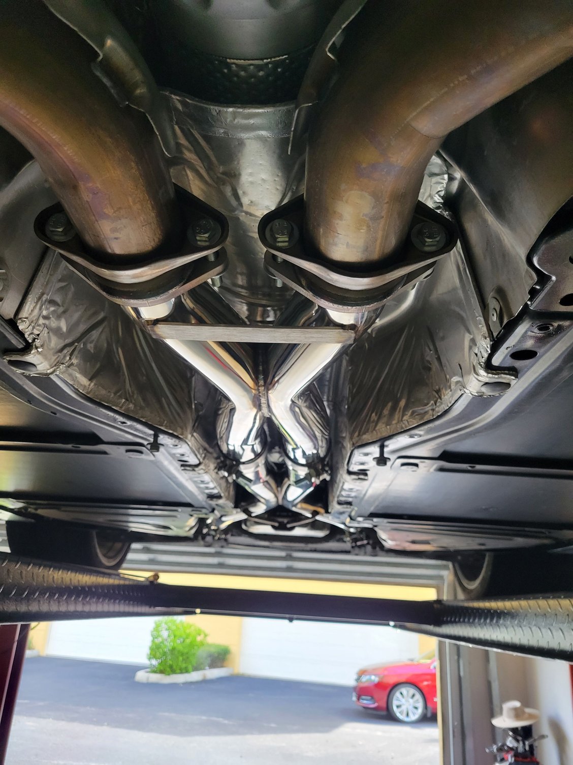

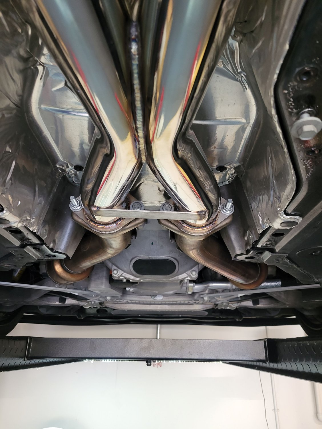

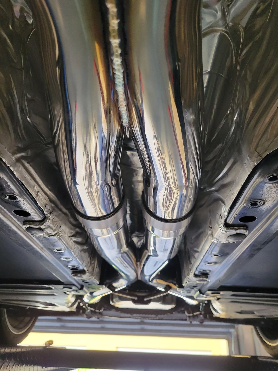

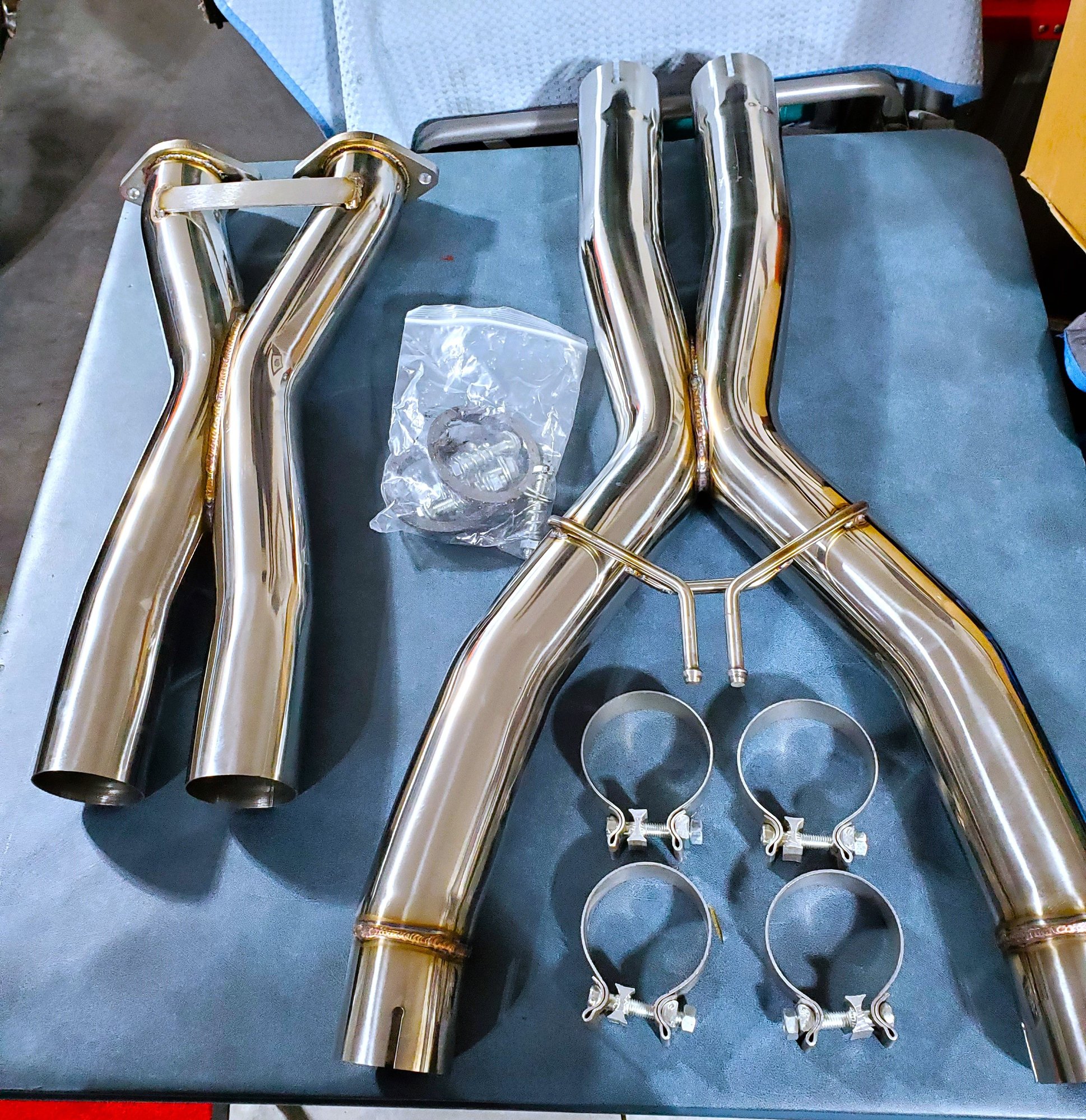

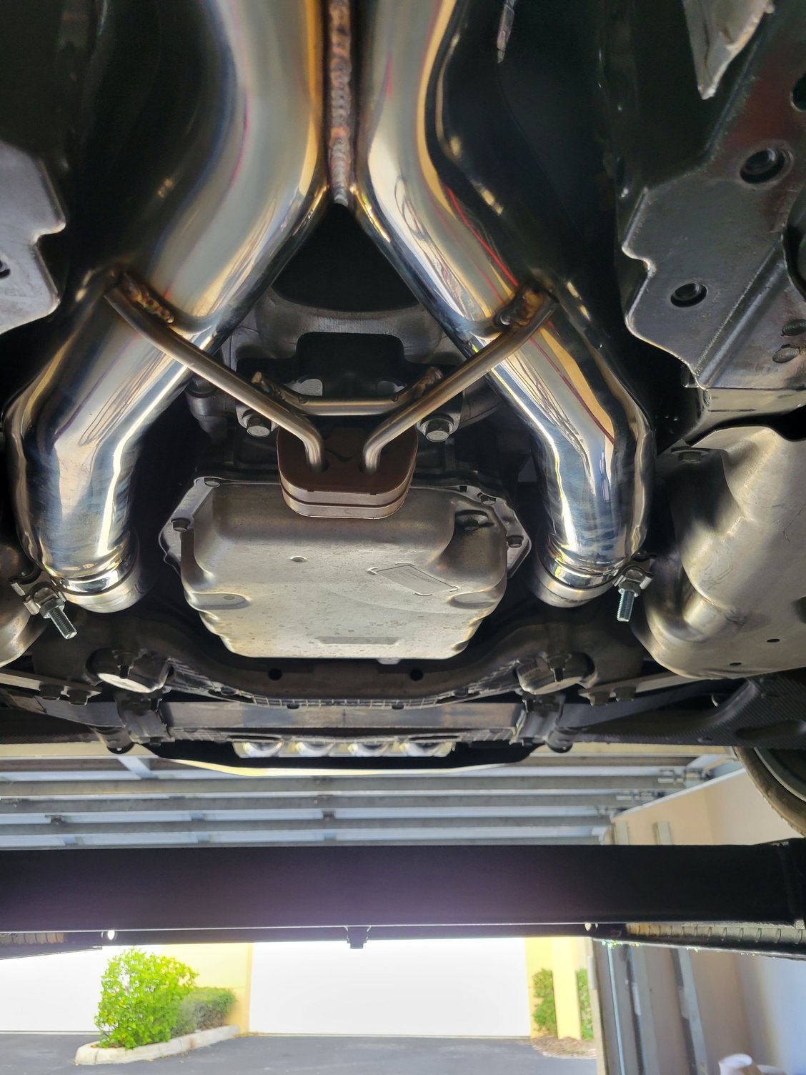

I installed the EOS X-pipe today. The parts came in a good size box and were wrapped in bubble pack to protect everything. It comes with everything you will need including all clamps, bolts and 2 new donut gaskets. Taking the old exhaust off was easy as I have a lift in my garage. I sprayed some W-40 on all the nuts and they all came of without any problem. The only negative is that it came with no instructions, not that I really needed them but I did run into a few things and I will explain as it may help someone else putting this on.
The front pipe has a brace welded to it that connects both of the pipes. I really don't think it matters if the is on the top or bottom as it can go both ways but I have it on the bottom.
The next thing is they give you springs that I think are supposed to go on the bolts that attach the front pipe to the front cats. I bolts weren't long enough so if you tried to use the springs you couldn't compress them enough to get the nut started on the bolt. If the bolts were a half inch longer it would have solved the problem. After looking at it I decided the factory setup didn't have a spring on the nuts and bolts so I figured it really wasn't needed. I guess we will see if it loosens up over time but I did crank the bolts very tight and will check them after a few heat cycles to be safe.
The clamps that hold the two pipes together will hit the tunnel brace plate if the adjusting nuts are on the bottom of the pipe. There isn't enough room to have the clamps on the side of the pipe as they will hit the sides of the tunnel so they must be on the top. The problem is you cannot tighten them if they are on the top as I couldn't fit a wrench or my hand up above the pipes once they are installed. I had to install the pipes and tighten the clamps that were on the bottom but than I removed the whole exhaust and moved the clamps 180 degrees with the exhaust laying on the ground so the clamp adjusting nuts are now on the top of the pipe while making sure I wasn't moving the pipes. I used a marker to mark the position of the two pipes so I knew if I had moved them. I then put the exhaust back on and tightened the front bolts first with the donut gaskets in place and than tightened the rear clamps.
I don't have time to drive the car today but I will post again on how it sounds once I take it for a ride. Let me know if you have any questions.
John
These are all the parts that come with the pipes. You can see the bolts with the springs on them but I couldn't use the springs.
This is with the center clamps facing down but they would hit the tunnel plate when I reinstall it and I didn't want a banging sound.
Front bolts installed without the springs, I think it will be fine.
Center clamps have the adjusting nuts on the top in this picture. It did not have enough room on the side of the tunnel for the nuts so they had to be on the top.
Rear clamps are tight and install is done.
You can see the front pipe brace is installed facing down, it could go either facing up or down and I think it will be fine. I ended up putting the bolts with the donut gaskets in two different directions as it was easier to tighten them with the sockets and wrenched that I had.

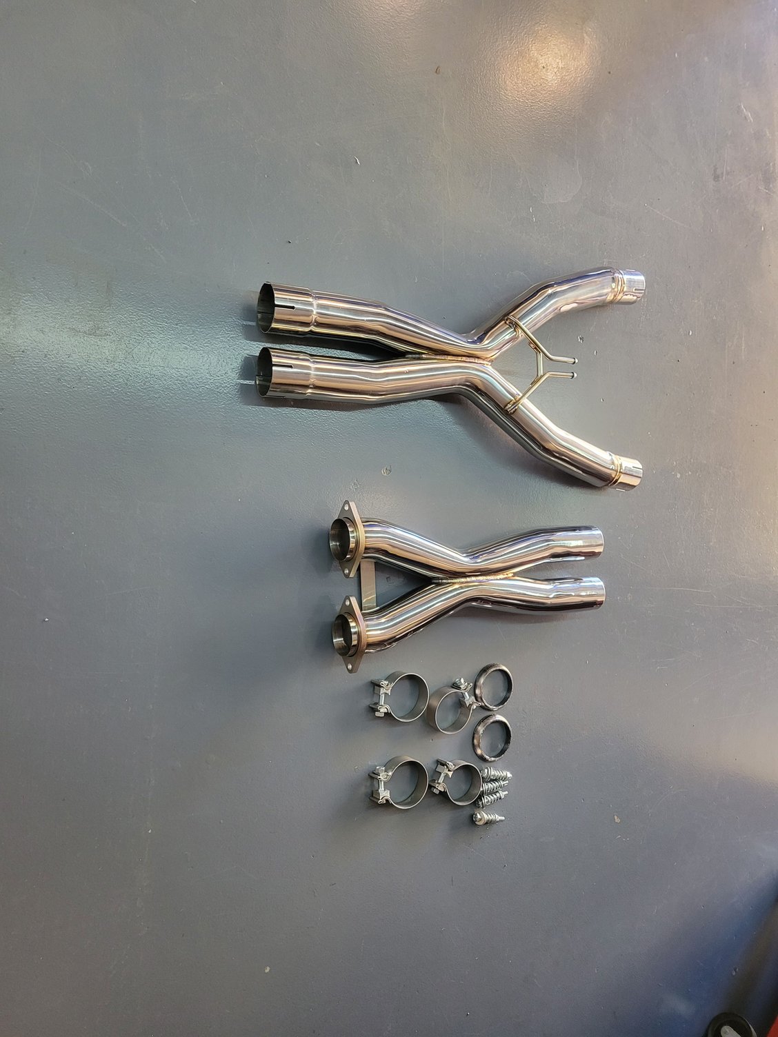

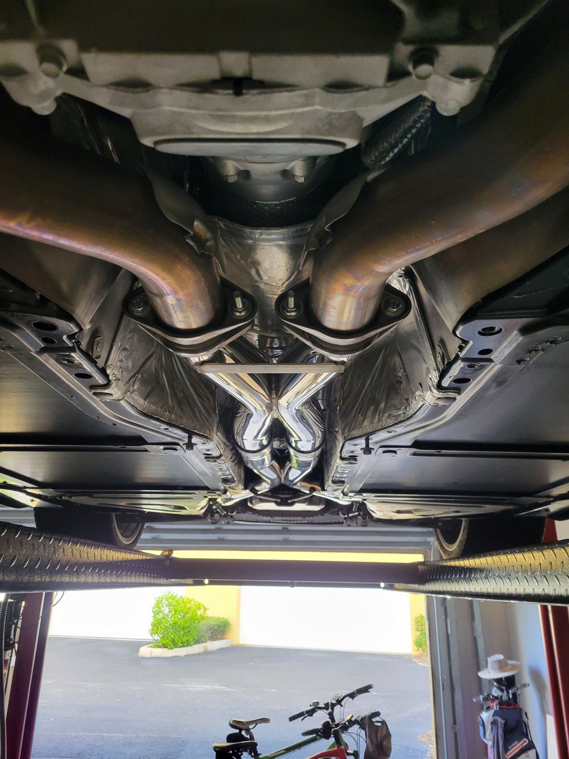

Well, I FINALLY installed my EOS X-Pipe this past Saturday. With the help of a real good friend we were able to knock it out in about 2.5 hours.
I also recently purchased the QuickJack 5000TL and it was a game changer over using jack stands. I am a pretty big guy and I was able to roll around on a creeper and still have plenty of height to work.
The one thing that we did different (than mentioned above) is when we took off the stock pipe, I measured the length from one end to the other on both pipes. On mine, the stock pipe length was 54.5". We put the two EOS pipe sections together pretty snug and found that the length was about 55.25". We stood the EOS assembly on the outlet end on a padded rug, then took a section of 2x10 board laid flat over the inlet pipes and used a heavy hammer to pound the two sections together. We were able to get the overall length to 54.75". I decided to try it at that length because I didn't want to be too aggressive with the hammer! .
(REMINDER: As mentioned above, make sure you install the middle pipe clamps so the the bolts are positioned on top of the x-pipe assembly when installed. This prevents them from coming into contact with the tunnel plate.)
We slid the outlet end over the existing rear axle pipes as snug as we could and the inlet end (w/ donuts) fit up to the existing flange perfectly snug! Bolted everything up and torqued to spec (maybe a little extra grunt or two on the hose clamps! ). We checked for exhaust leaks before installing the tunnel plate and didn't detect any issues with any of the connections.
Again, I was impressed with the quality of the EOS X-pipe. The T-304 stainless appears to be more than adequate for the application and the welds were very nice.
I used a decibel meter to get a before and after cold start measurement. Based on an average reading over about two minutes, the EOS X-Pipe only measured about 3-4 decibels higher than stock. But there is definitely a "throatier" tone to idle. I drove it about 20 miles. I was able to notice a better (to me) sound at high RPMs. No drone or any negative sounds throughout the RPM range. Overall, very happy with the upgrade. Definitely worth the $260 and my time!
