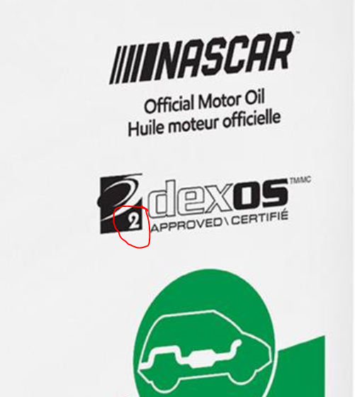

I decided to start changing my own oil. I see different versions of the Mobil1 0-W40. One even says European car formula. Which one specifically should I buy? Should I buy the one pictured below? Thanks.

This is what I use, not the European formula. I heard they are re-branding the 0w-40.

Yes, that is the correct one. That one has a "2" under the crescents before the dexos.
Don't use the European Car Formula, it is not ESP.
Or you can now get this;
https://www.speedwaymotors.com/Mobil...SABEgIG3_D_BwE
M1 0-W40 Super car is the new M1 0-W40 Dexos2 ESP.

That is the one if you have a warranty. Beyond that, it isn't that important unless you are tracking it and don't want to switch the oil back and forth. Is it better than the 5W30? I think so. Significantly better? I have yet to see proof of it other than "Daddy GM said so.". European Formula is more for MB, Audi, etc.

Has to have he Dexos label. The oil in the picture is correct type. I believe that 0W-40 is now recommended for all C7's.

Weird but I don't see a '2' as in Dexos 2 on the new label.
This might help.
"Mobil 1 Supercar 0W-40 may share the same name as Mobil 1 0W-40 but these two blends aren’t the same and are not interchangeable. Mobil 1 says that while the viscosity is identical, the formulation of Mobil 1 Supercar 0W-40 is the result of 24 months of grueling tests and precise engineering, and it’s specifically designed to guarantee it meets the strict dexos-spec required for all C7 and C8 Corvettes."
