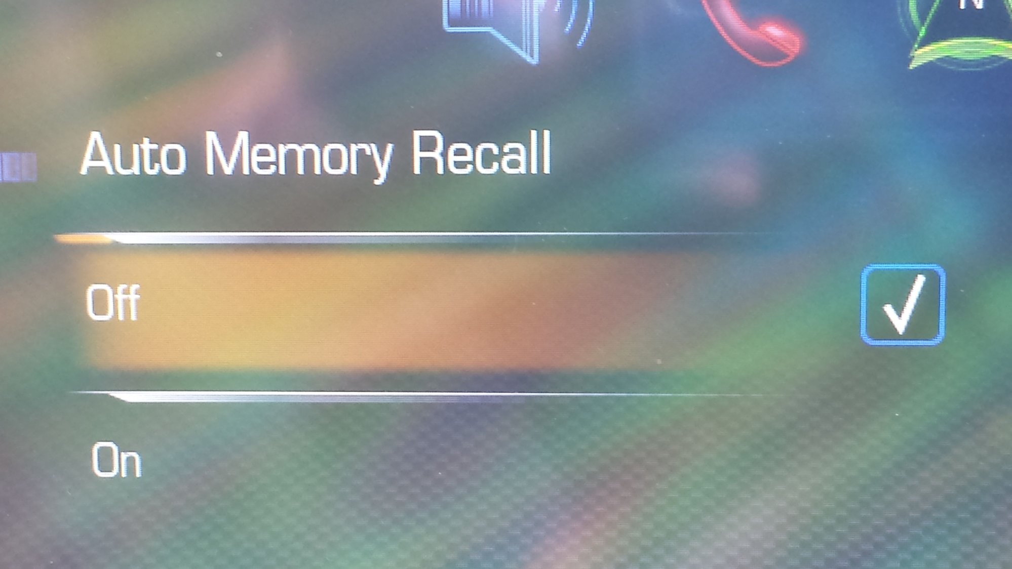

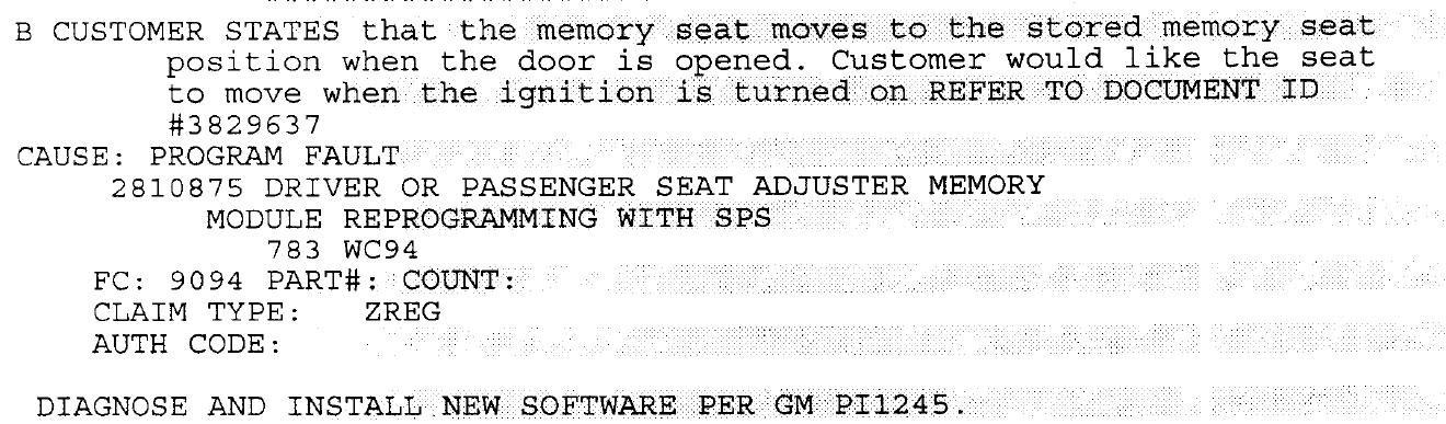

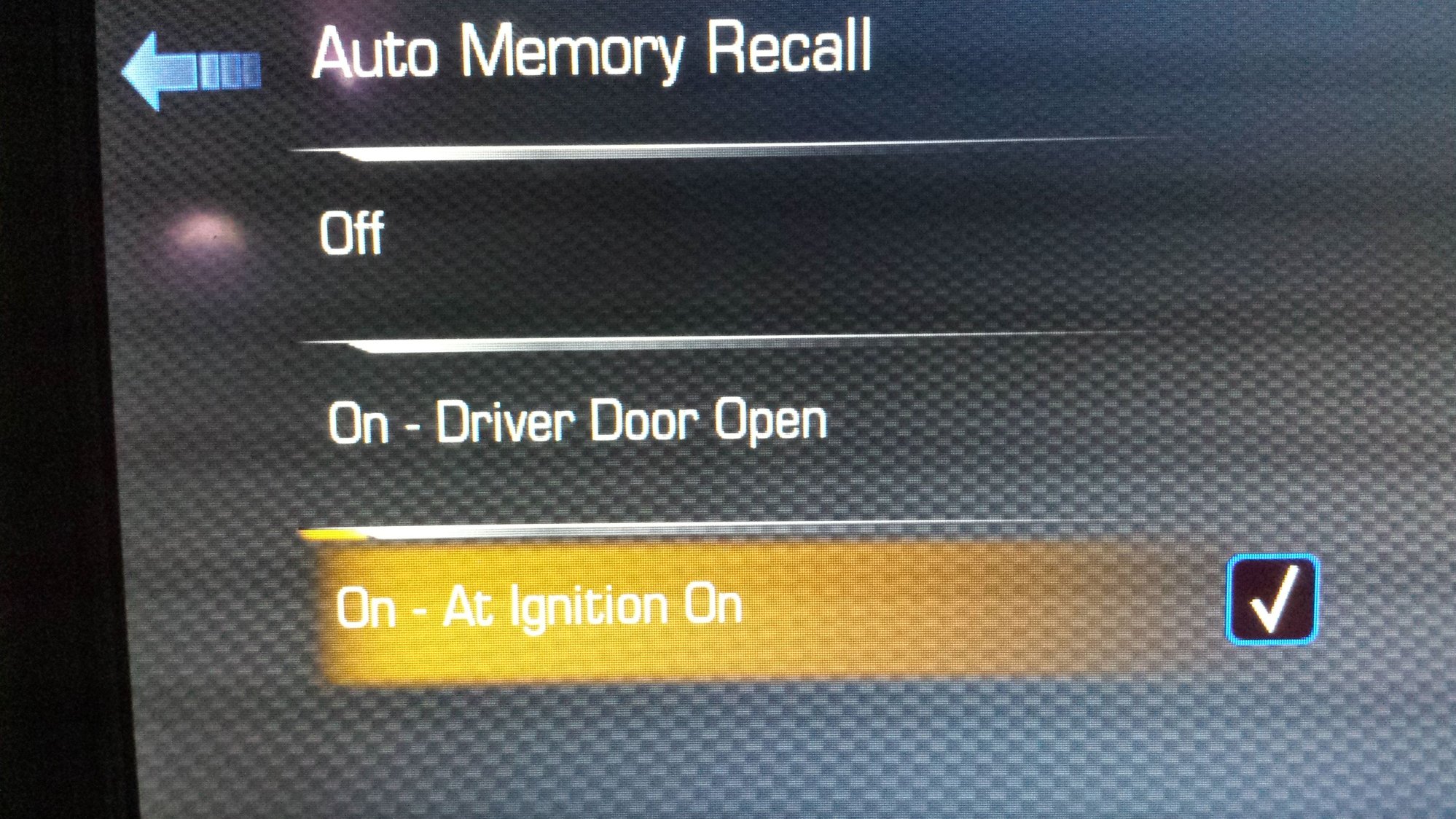

Default 2014 M7 seat memory
The 2014 M7 seat memory ON was AT DOOR OPEN so the seat would go to memory position when you opened the door to get in. There was a software fix to add ON- AT IGNITION ON which is how later years work.
Does your memory recall screen have choices ON / OFF or OFF / ON - AT DOOR OPEN / ON - IGNITION ON?
If only on/off it functions as OFF / ON - AT DOOR OPEN. There is a software fix to change to the 3 choices. You want ON - IGNITION ON. 2015 and later ON is the same as ON - AT IGNITION ON. See image of service ticket below for the doc # and PI #. The software update was free when under warranty - I expect they will charge you now.
2014 M7 as delivered - built April 2014.
2014 M7 with seat memory software update:
Software update applied to 2014 M7 see Doc# and PI# in the writeup:
Ron
