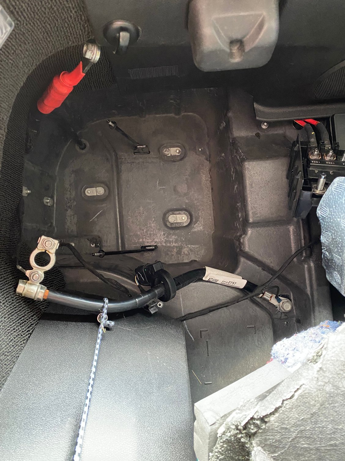

Like I said, the handle is not obvious. When I brought the old battery to the store for recyling I pulled the battery out of my car with my rubber strap that attaches to the posts and set it down and took the strap off. The store employee then reached down, pulled up the handle(s) and walked away with it. Sure surprised me.
old thread I know but I just replaced the battery in mine - didn't have the strap talked about here so I ran a piece of insulated wire under the battery (there's a recess) and made a loop to lift it.
It was still a pain in my opinion. The replacement battery DID have a handle and I left it on there. BTW 4years and the OEM battery was starting sluggish sometimes, that's why I replaced it.

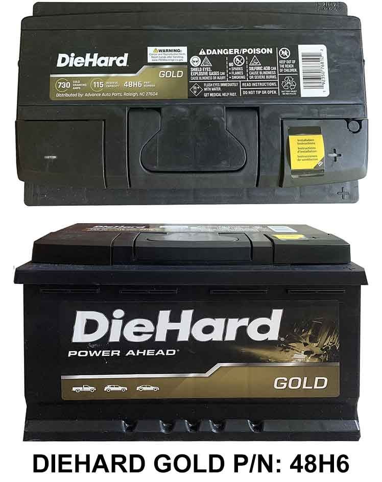

From: South Carolina
The OEM battery on my 2016 C7 passed away after 7 years. Not too bad and it served me well.
I purchased a Diehard Gold / Part Number: 48H6 from Advance Auto Parts. Cost was $214.
Recommended replacement specs for a C7 are at least 615 Cold Cranking Amps.
This new Diehard exceeds the requirements at 730 Cold Cranking Amps.
The replacement was somewhat easy except trying to remove the old battery from the deep well. No handle.
The usual minor replacement issues I encountered were:
o Horn alarm blaring when connecting the new battery
o Windows needed re-indexing
o Programmed radio stations were deleted
o The clock date/time had to be reset
o No tire pressure readings (however, the tire pressure readout eventually returned after driving around for a while)
The two important tips I can pass along are:
1) Be sure to remove the small plastic plug located on the right side of the old battery. It's needed for the new battery
2) Don't forget to reattach the small black PVC vent tube on the left side of the new battery

If you do not have the handles put a vice grip wrench on each of the posts and lift out the battery. A battery strap will also enable you to pull the battery. If you have a check engine light unhook the positive battery cable for a few minutes and reconnect it. I am not a mechanic and it really wasn't that difficult to change the battery. As far as the windows and the radio that part was an easy fix. I don't remember even having to re-index the windows. I did go with an AGM battery too. My battery was good but about 4 years old and I changed it because I didn't know how old it was but was able to find a date on it. I keep the old maintainer on it and will put it in my boat when that battery goes bad.
