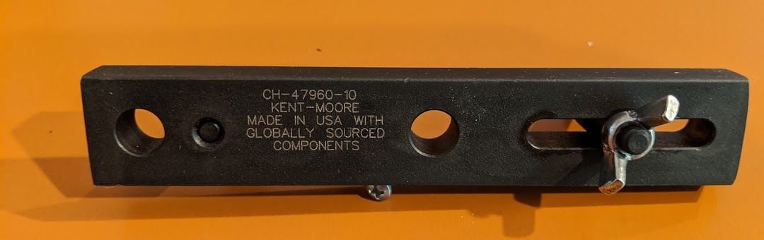

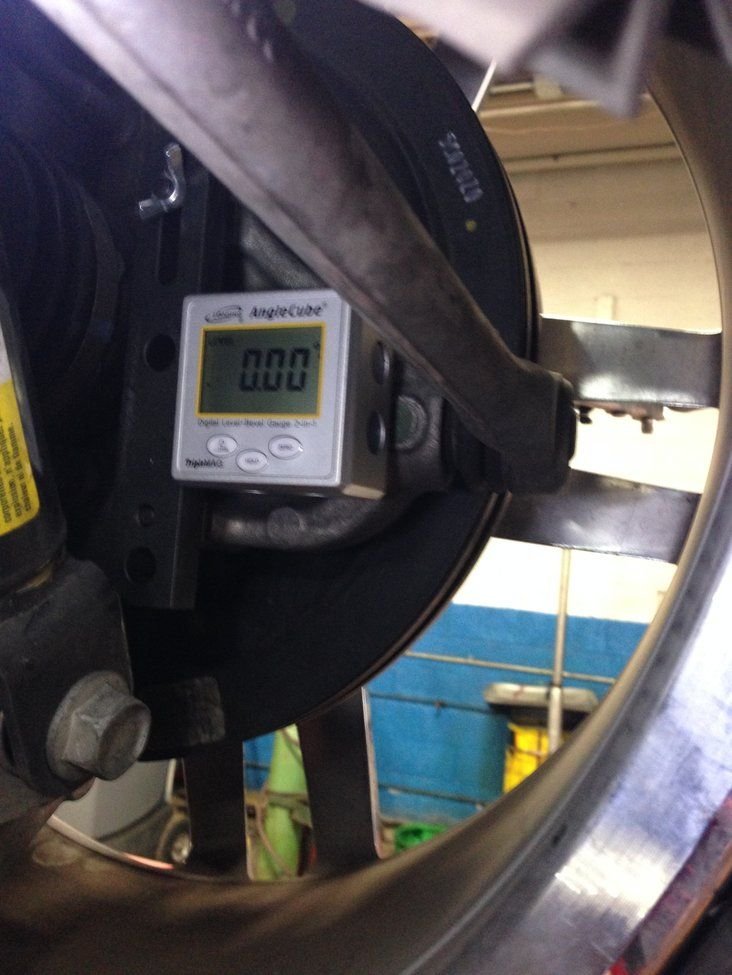

Alignment Machines cannot measure or display rear caster. If rear Camber is adjusted rear Caster will change They must be adjusted together.
The Block needed to mount the Angle Gauge.

Yes I agree. My concern is the quality that you can get when a guy at a tire store works on a Vette, especially a C7 w/ the rear caster being adjustable and needing a specialized tool to measure it. I do my own alignments and I can say that you have to be really dedicated to spend the extra time to get it right. The temptation is to say that isn't perfect but it's close enough. Then there is the usual alignment machine that prints specs out in green depending if they are within a large window. That window is way larger than I allow myself on my cars.
