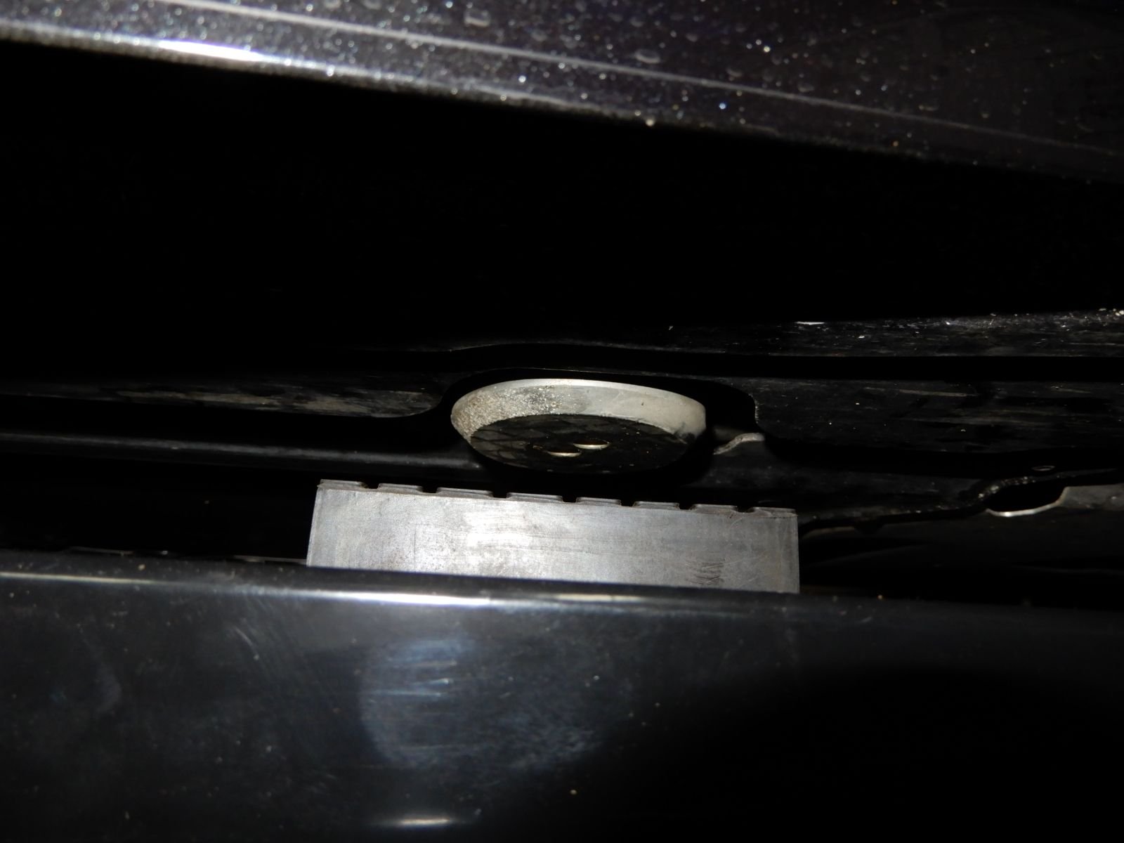

Ok guys I think I’ve come up with a workable solution. For the rear, attach the puck and use the shorter block, for the front use the shorter block but on its side. I can now get the jack lifting points aligned with the puck attachment area, see photos. Thoughts?
The first photo is obviously the rear.

First photo is how the (shorter) blocks are set in the QJ trays. I use the blue tape to mark where the blocks sit before sliding the unit under the car.
This is how the front block lines up with the puck.
Rear block & puck.

Have 5000tl and jack points dont align with puck locations. Curious as to how yours do. Any pictures?

[QUOTE=NortonCO;1606003446]I took delivery of my QuickJack after storing my fun cars for the winter, so I haven't used it on the C7Z yet. That said, have you tried rotating it, so it's perpendicular, rather than parallel, to the frame?
I used them sideways. Better than parsllel to frame. Use shortblock and pucks. Pucks lineup with lift points fine.
I've since used my QJ this way on mine as well, and had the same experience - it works well.

I space em out 28 3/4 and put the blocks against the outside of the trays. They Stay solid and u can access front and back of the car easily. Parallel to the car approach you can not get the pucks under the blocks on a 5000. Risky business.
