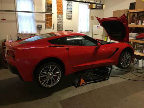

For me - I use the circle lifting point pucks that you just slip into the slots and give a half turn....and the rubber blocks that come with the QJ.

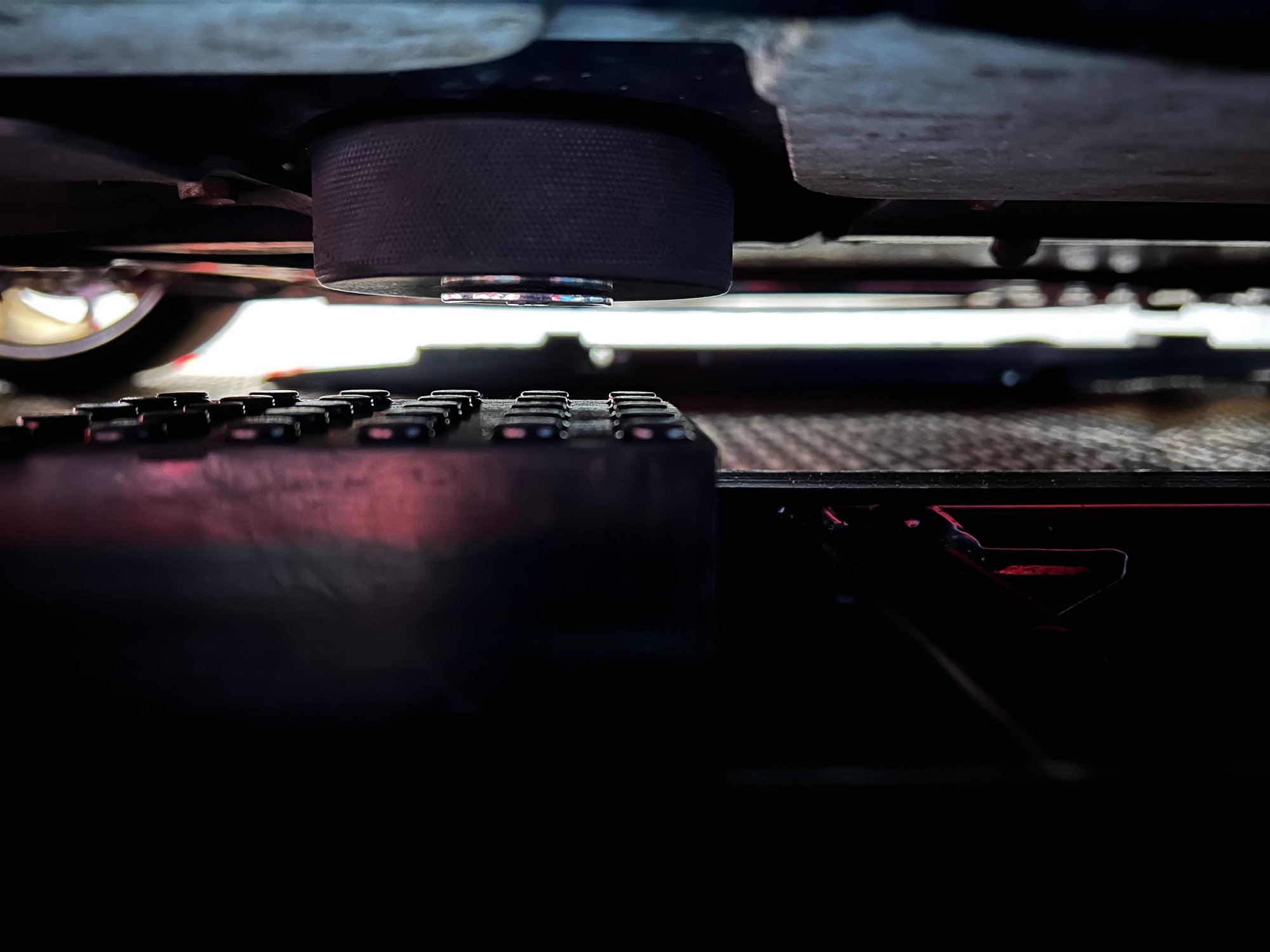

Ok, added the pucks with the blocks, they won’t line up no matter how I move the blocks or jack, see photos what am I doing wrong? The first photo is the front and second rear.

If you have jackstands, consider placing them as shown here. Just as backup.
