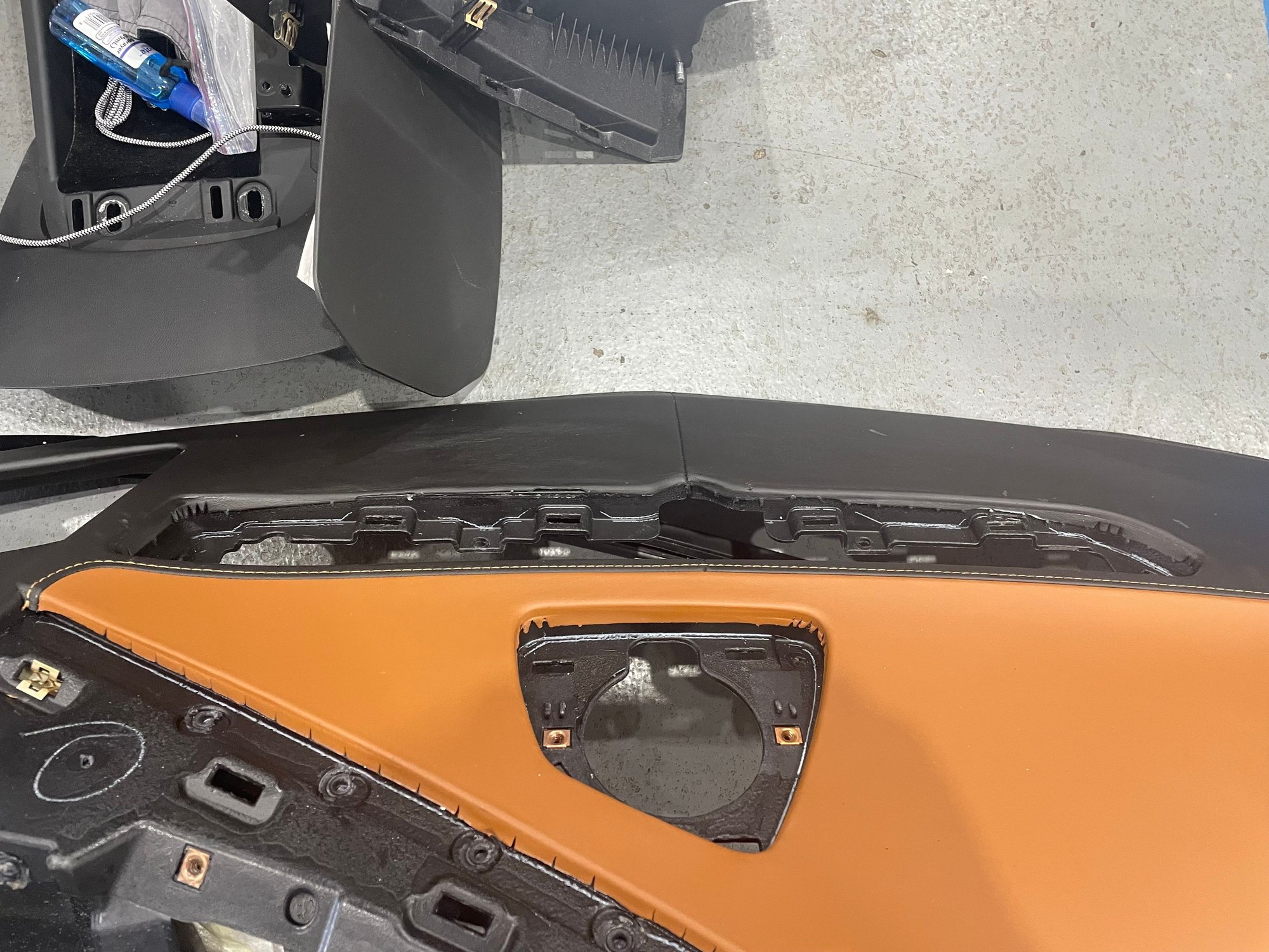

‘Here’s what a new dash looks like. Notice how much more material they added under the vent and speaker.
Update:
Making an attempt at stretching the leather back. Trying a combination of leather conditioners like mink oil, etc. It has stretched about 3/4” so far. My plan is to take it to an upholstery shop eventually and have it glued and stapled. I’ll either keep it as a spare or put it on the market.
