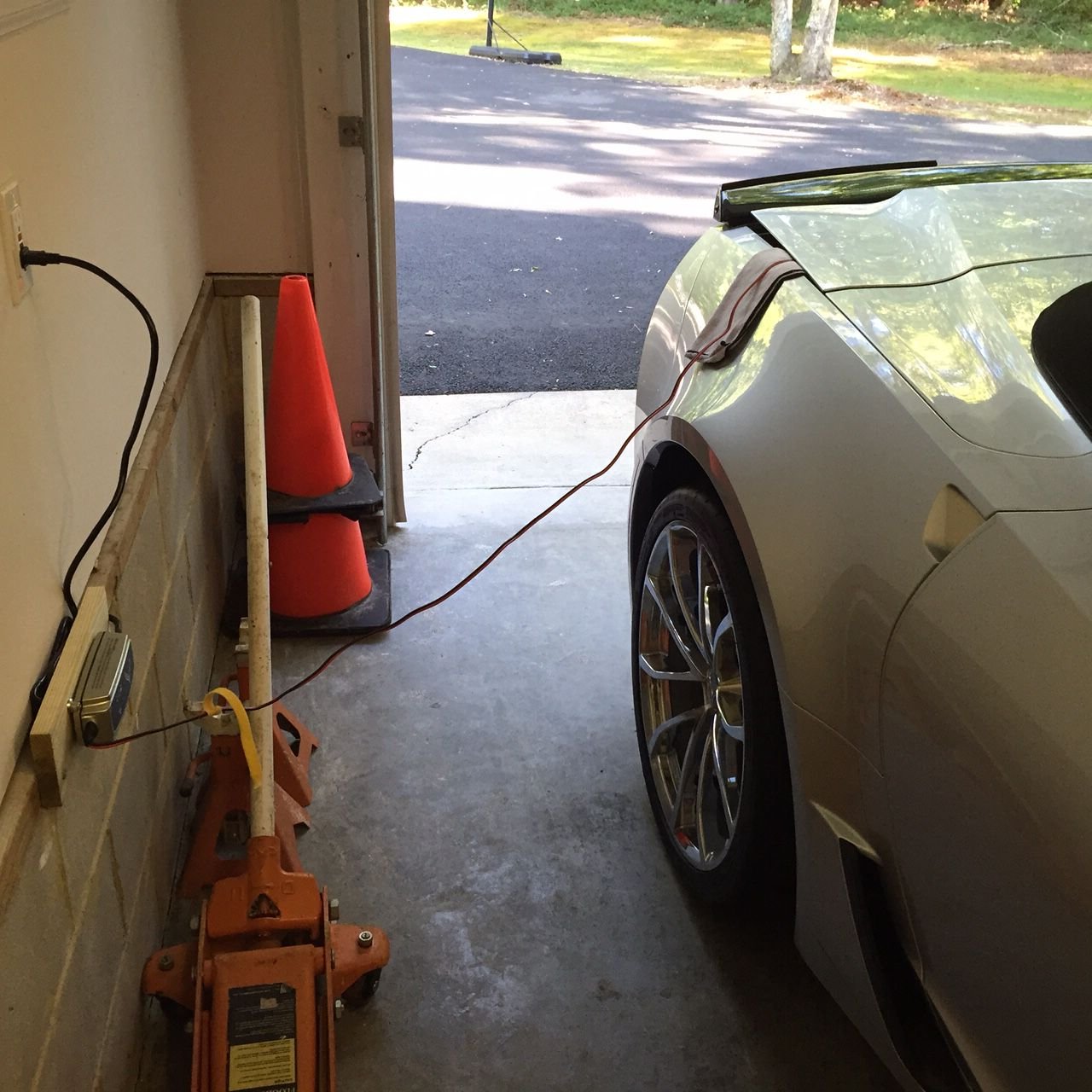

Yep the maintainer plugs in the cargo areas of both C7 (rear) and C8 (front) are very handy:
That looks like a trip hazard. Hope you have good health insurance for the broken hip.
jk
obligatory
Actually a very nice setup.
I run the cord through my cracked passenger window.
Naaah, no one can miss that OSHA compliant yellow caution flag hanging from the cord.

Tipp:
Buy an extension from CTEK. So you can close the hatch complete. There is enough space that the cable will not be damaged.
Reason: the car will not fully shut down when hatch ore engine hood is open (sensors!)
