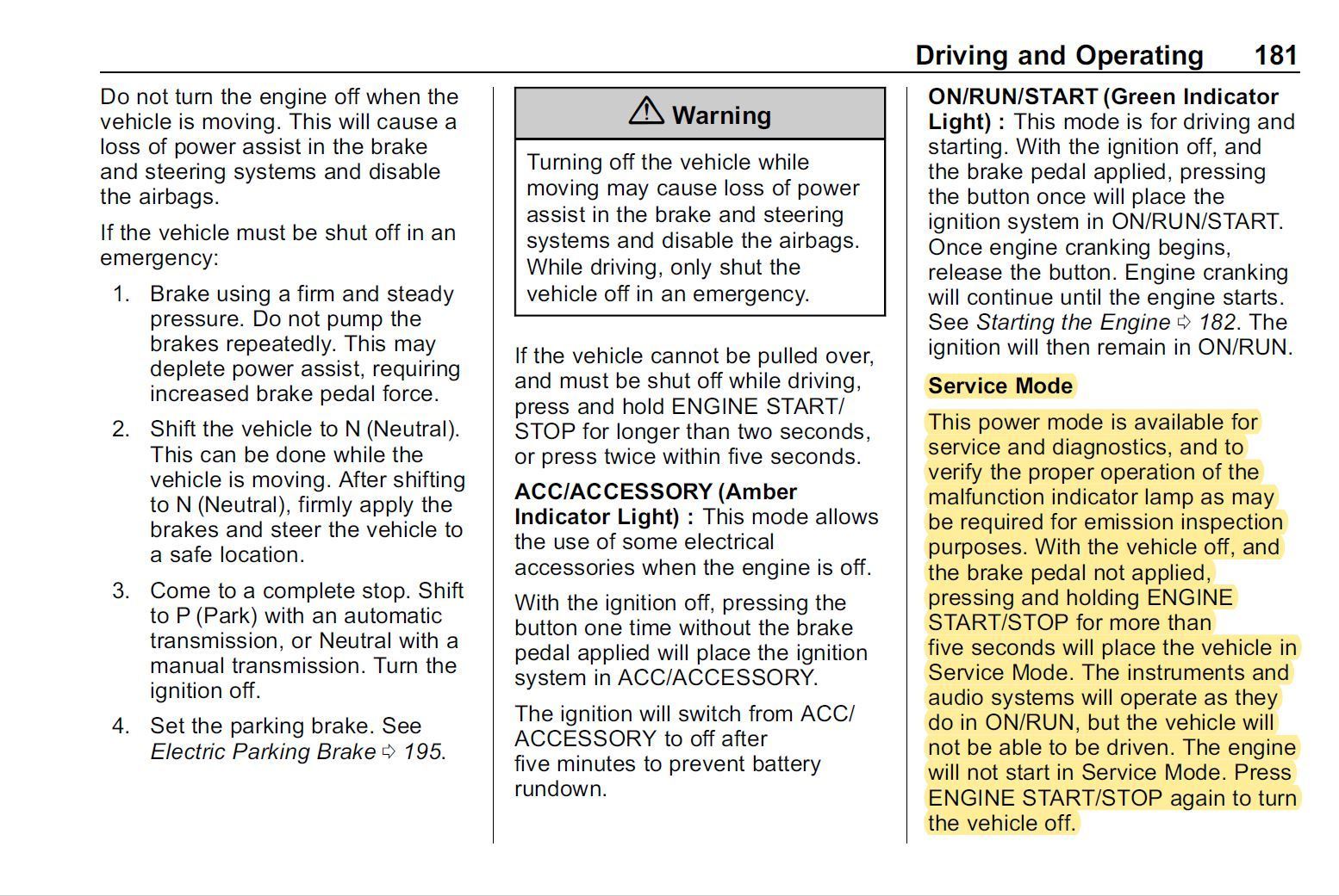

This is correct BUT...
I've found putting the car in Service Mode (described on pg 181 of my 2019 Owner's Manual) while connected to a battery charger (e.g., CTEK's MUS 7002) in Supply mode works equally well without having to leave the car idling for so long.

I don't doubt the service mode is an attractive option, but FWIW the nav update instructions caution against that procedure - "IMPORTANT - Vehicle must remain running and in PARK during the entire installation"

I see nothing in what you quoted about Service Mode or use of an external power source. The caution's emphasis on remaining in PARK, combined with Extended Parking cautions in the Owner's Manual, indicate it's more about ensuring the car doesn't move while idling than it is about actually idling. Speaking of which, I find the need to babysit the car while it idles an unnecessary annoyance.
In my experience, your inferrence against Service Mode is valid only if attempting it without an external power source, since doing so risks the battery dying and the upgrade failing. Having used Service Mode and an external power source for multiple upgrades, I'm as confident in this method as you are in yours.

You're exactly right. Using an external power source is GM's required process when doing control module reprogramming at the dealers. The only reason the owners manual says to do it with the engine running is because most people don't have a suitable charger in their garage.
Service mode is just fine if you know what you're doing. Everyone else can run the engine.
