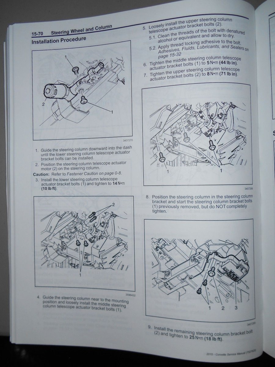

this is from my 2015 service manual

Great to include those diagrams @raisinjack Dave, if you use these diagrams, ignore the top 3/4 of that first page. You do not need to remove the "steering wheel spoke cover" to replace the telescoping motor. Just clarifying because I tried to remove that spoke cover from a used steering wheel I replaced and it's super thin and bends very easily. I ruined the spoke cover trying to remove it - hope I never have a need to actually do that. Guess destroying it would be ok if your intent was to replace the spoke cover.
