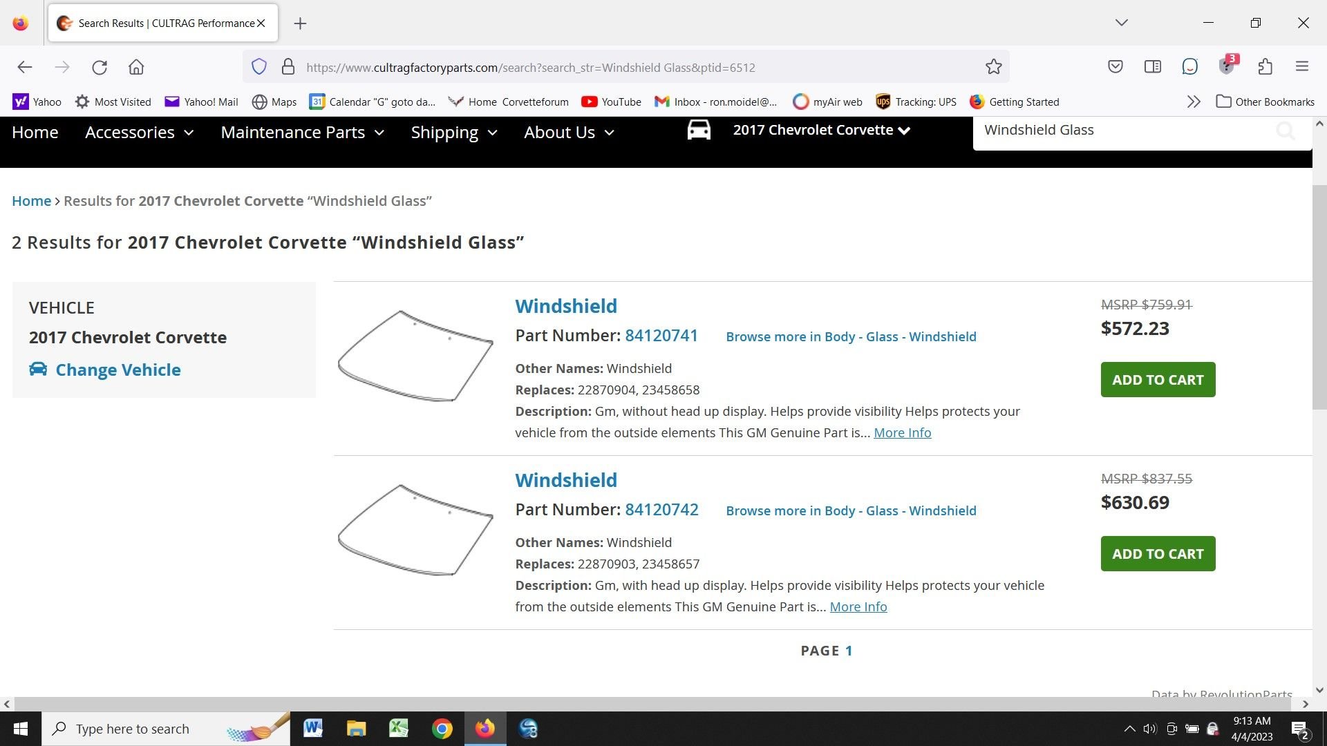

So, anyone got the part number for the Windshield (W/Third Visor Frit, Rain Sensor, W/HUD)?
Stingray?
Z?
That would give this thread a very happy ending.

Default ✅Solution ✅
Cultrag lists the same part numbers for Stingray and Z06. The only choice is HUD or no HUD.
Ron
