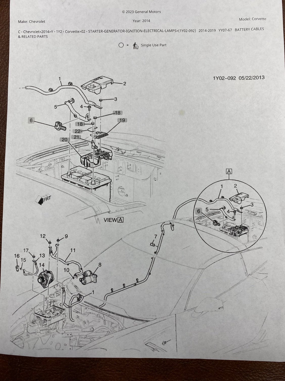

Originally Posted by RonC7
That is a fuse block on the positive terminal. 350 amp fuse to front fuse panel, starter, alternator, and power steering.
100 amp fuse to the rear fuse panel. Another 100 amp that I think goes to the convertible top.
Ron
Excellent pic there is another positive lug that isn’t shown and it is striped out. To recap there are two main positive lugs and the one where the positive battery terminal should be is striped out so the lug just spins when the nut on top is attempted to be removed to enable me to move the positive battery cable to the correct location

A hot wire from the battery to the starter and other electrical loads in the front that is NOT fused at the battery? You need to connect a 350 amp fuse at that point to feed the front of the car. Currently you have an unsafe fire hazard.
Get a new bolt?
Replacing the fuse block (disconnecting power) won't cause major issues:
- you will need to reindex (reprogram) windows
- you might need to reset radio and other settings depending how long of a power outage
- emissions sensor status will reset. If you are in an area requiring emissions check you will need to drive the car for multiple ignition cycles over several days before they show OK or READY with an ODBII reader.
Ron

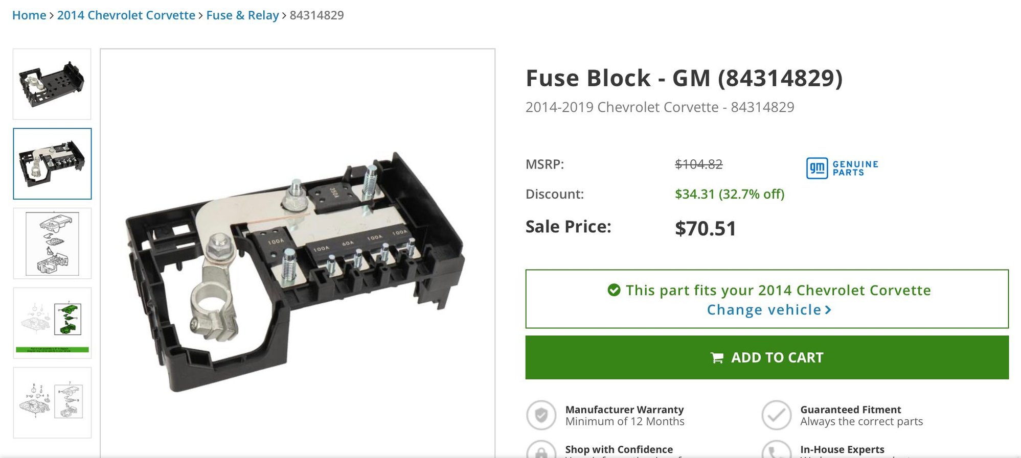

This fuse block is what it looks like I am going to need. Is it okay to just disconnect battery to replace this piece or will my electronics go bananas? I know by just having my battery be low when I got it charged enough to start I had a message to roll drivers window down and back up, then a second message to roll the passenger window down and back up.

Dude - see Post 6. Always disconnect black (ground) cable first, then positive from battery posts. Reconnect positive first, then ground.
Rolling the windows up and down is "indexing."
Ron

Were I doing it:
Buy the part shown in post #7
Remove the negative cable (Be nice to the thin black wire on the negative cable(don't break it!!!))
Remove the positive cable
Replace the fuse block with the stripped post
Attach the positive cable
Attach the negative cable (Be sure you were nice to the thin black wire on the negative cable or repair the broken wire with SOLDERED connections)
Index the windows. (All the other things in memory are just fine and will still be there)
Elmer
