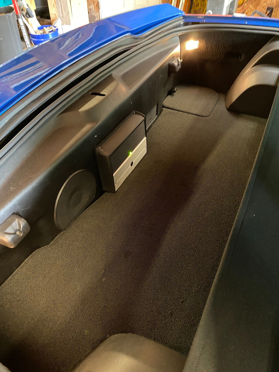

Great Point , maybe with the demand from the two JBL amps and a 6 yr old battery maybe it’s my cars cry for help. 😂
I guess I posed that question with hopes of someone saying “Oh Yeah, my battery was bad and XYZ was happening” and the new battery cured it all because I am tired of throwing money at it and haven’t even driven 200 miles since I got it home.

Unfortunately it was me that backed into my own car with my truck, car was off and I was barely moving. All electronics were 100% prior to that. So my thought process was if I had to take the front end off to get to the light I would go ahead and have the front end repaired and painted. Add all new speakers, two JL Audio amps and new HMI and radio module all while the front was being repaired.
