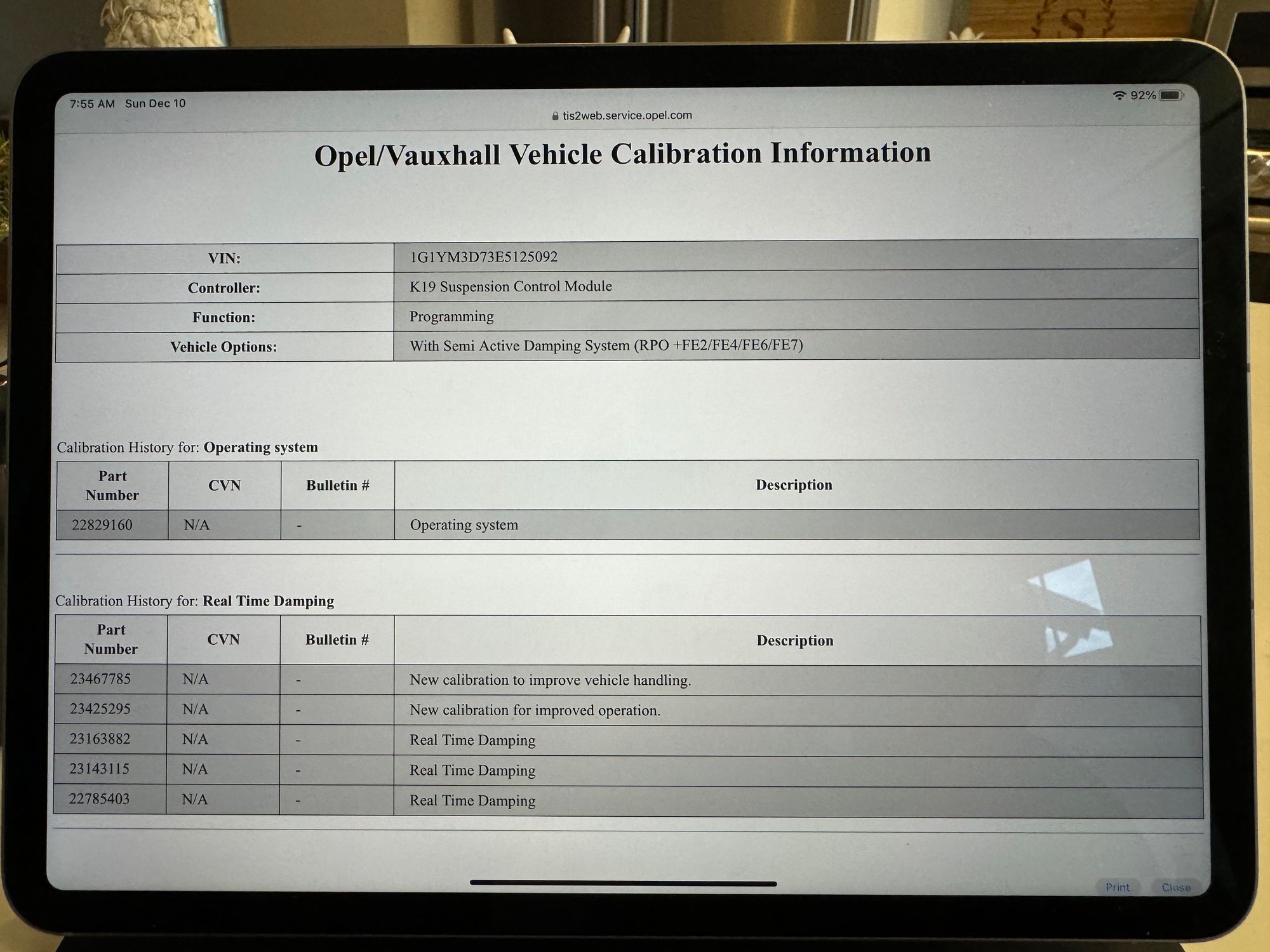

Originally Posted by hiltsy855
Put in VIN > Get Cal ID > With Semi Active Damping > Complete History
No, my update doesn't show up.....
Do you know if this means mine was done?

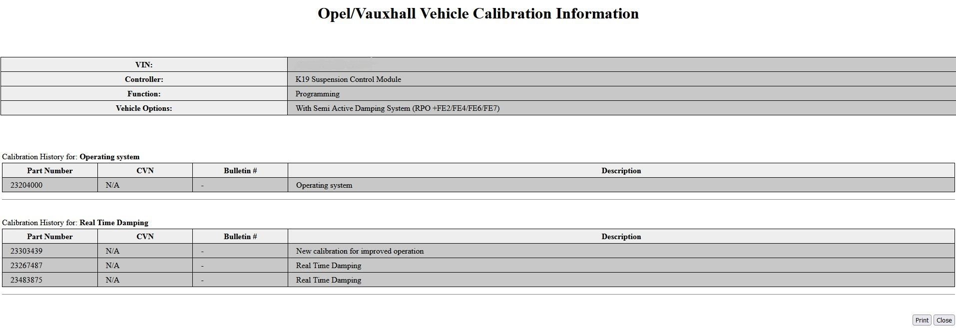

Mine looks just like yours.

This is what mine shows. Does this mean it was done? Wish it had dates because I thought the updated calibration was only available on 2018/2019 models. Also I was just going to do the module swap with Jim Mero but I think mine has been lowered. If you see post #31 this caused major problems unless you do a ride height re-calibration. ACDelco website on 2nd screen capture below shows same exact information.

The reports are quite confusing ofc
Here's mine

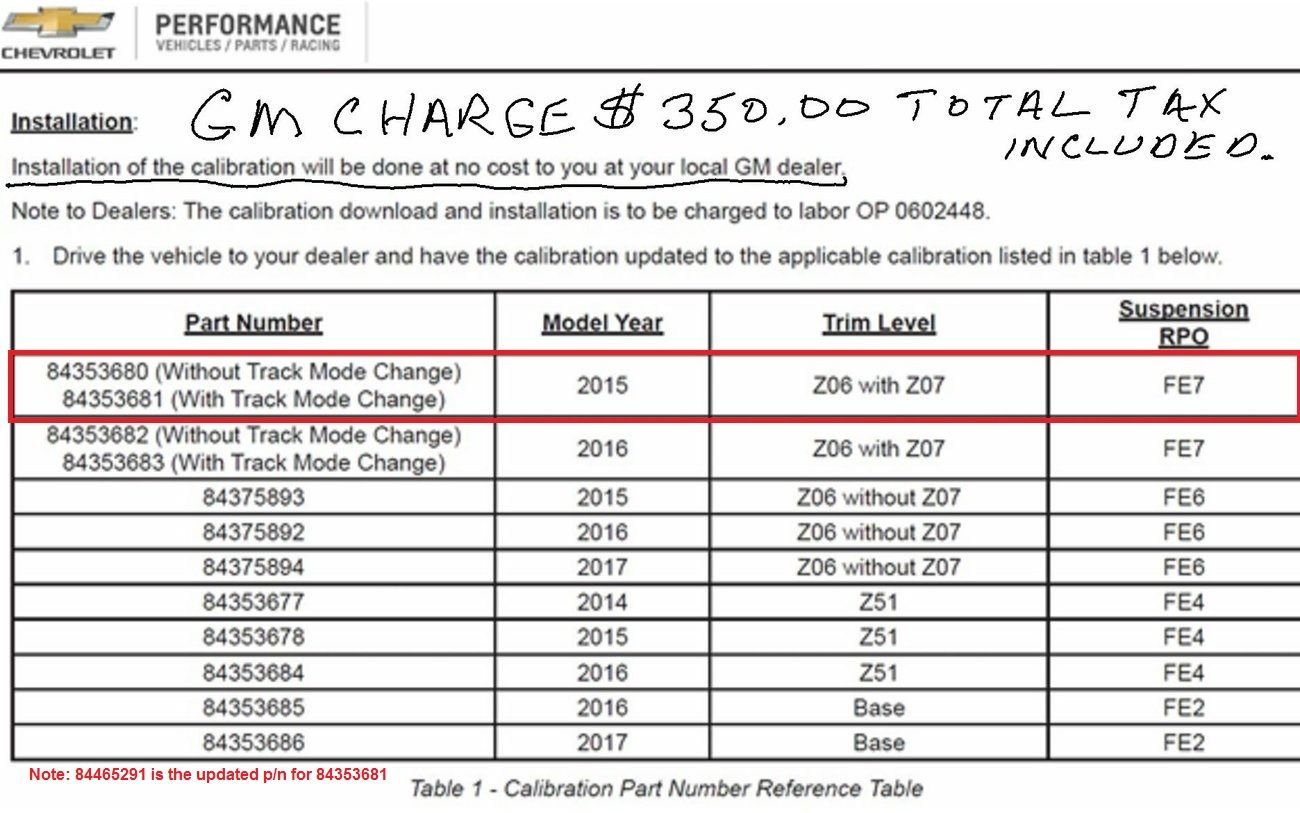

I don't think mine was updated. See below for part numbers (some may be superseded). My 2 options are boxed in red below below and it does not show up on either of my history reports.
See link below. Confirms the 2 options were available for my 2015 Z06 with Z07 (FE7). Only 1 available now (Tour,Sport,Track)
https://www.lsxmag.com/tech-stories/...-ride-upgrade/
