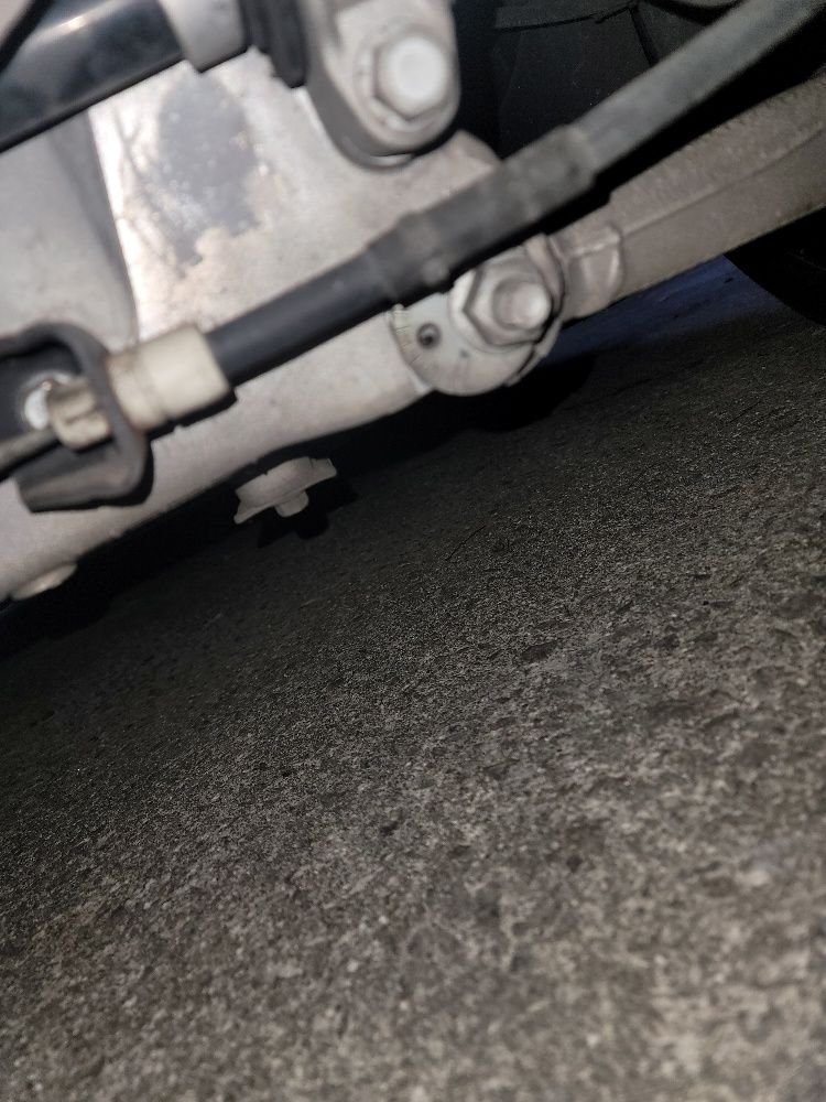

No need to jack up the car. Visible with a slight crawl underneath. This is the right side. Looks fine to me.

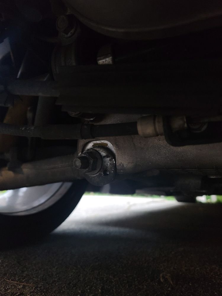

This is the left side. It is clearly off at least from where it used to be. Looks like he chewed up the nut a bit as well.

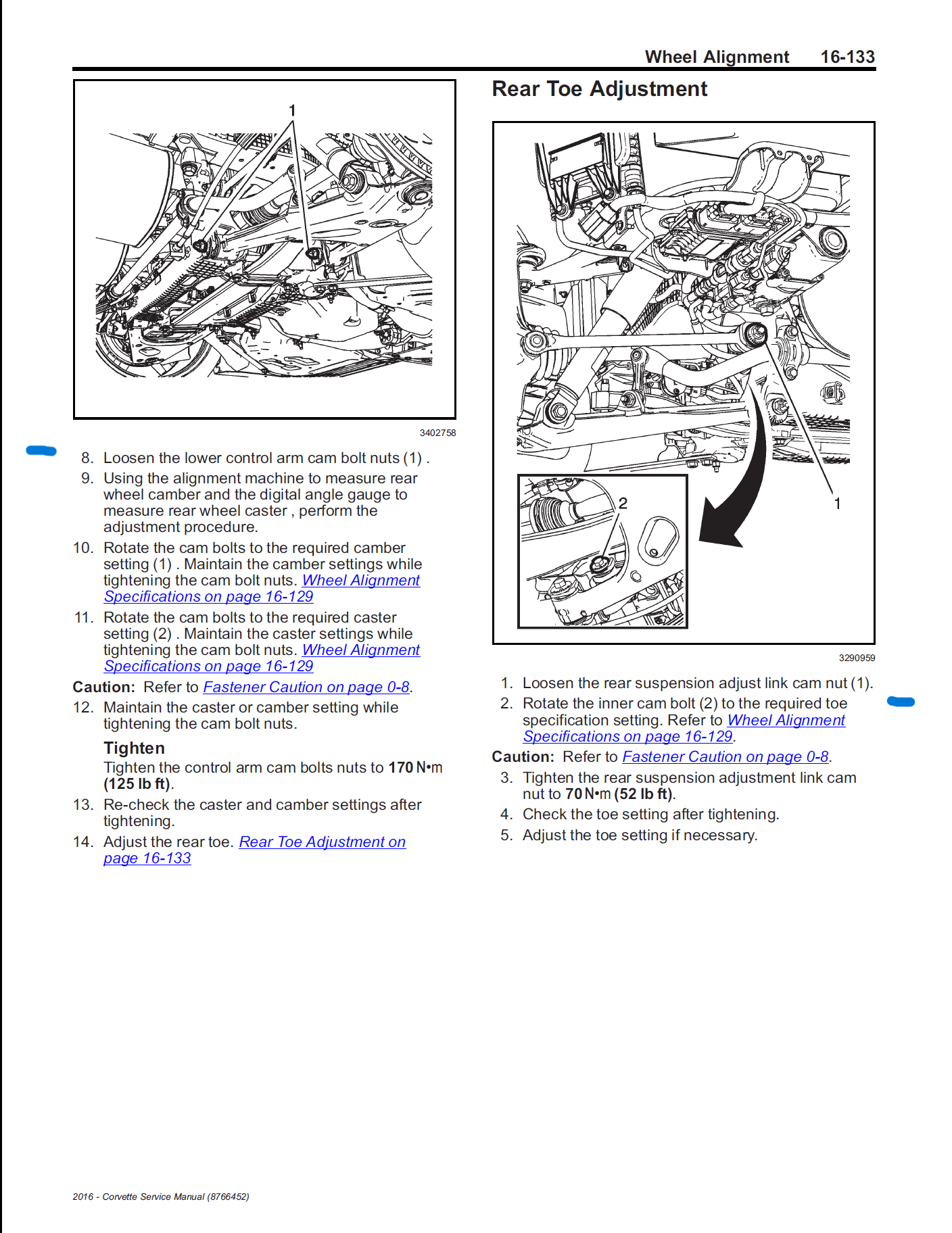

The bolt is called a cam bolt and has two cams on it. One in front of the mount and one at the rear (shown in your picture). To adjust you loosen the nut and turn the bolt which turns the cams. It would take one hell of an impact to bend those bolts so I suspect the bolt isn't bent. Based on your comment that you need to turn the steering to 11 o clock to make the car go straight I suspect the rear toe and thrust angle are screwed up. Thrust angle is the direction in which your rear wheels are pushing the car. If the thrust angle is pointing toward 11 o'clock you will need to turn the steering wheel to compensate. This means the car is driving down the road sideways (dog walking). All it takes is for the rear toe on one wheel to be messed up and the thrust angle is messed up. To compensate for the thrust angle some mechanics will adjust the front toe to set the steering wheel angle so the wheel will appear straight while the car is driving sideways. This can result in weird behavior when going over different surfaces.
There are two cam bolts for each lower control arm, to get the proper adjustment both bolts may need to be adjusted. Once finished the bolts need to be tightened to 125 lb ft to prevent them from coming loose. If they come loose then the camber, rear caster and rear toe/thrust can all change while you are driving. The C5 and C6 only had one adjustable point for the lower rear control arms, the other mount was not adjustable. If the person adjusting the rear suspension isn't familiar with C7s they may not know that both control arm mounts have cam bolts Vs the one bolt that C5 and C6 had. The rear toe link also has a cam bolt adjustment and it needs to be tightened to 52 lb ft. If it isn't adjusted correctly that can cause a thrust issue.

Took the car to a tire store today, so here is the update:
- The bolt is not bent. It's just out of place.
- right rear wheel was cracked and repaired at some point on the inside lip. They told me to reject it and have CarMax replace the wheel.
- The left rear axle had been replaced and done poorly. there is play in the wheel/ axle. They think the whole left rear axle will need replaced again.
- The axle will need replaced before an alignment is attempted on the car.
I am going to talk to the sales person on Monday. It may be that this car just needs to go back to CarMax for good. Seems like it was tracked or abused somewhere along the way.
Tech said it was definitely fixable but it depended on whether I was willing to give CarMax a chance to make it right, or if they are willing to do so or just say " bring it back". We'll see.
