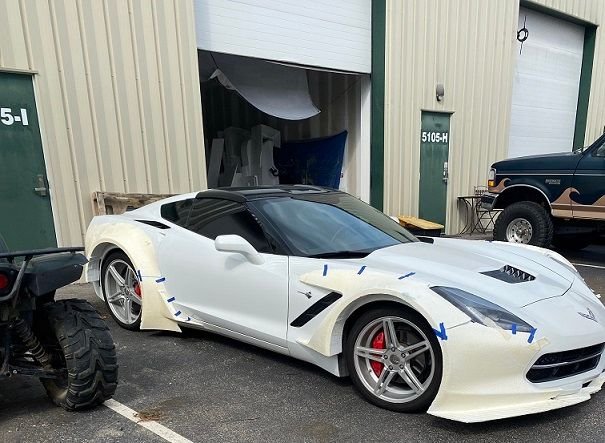

So nonchalant just 3D scanned my car, flipped milled parts, molds of car, fabricated the kit and 10 months later voila. Are you kidding me sounds like quite a lot and quite the PITA. Good going very industrious. Looks sick by the way.

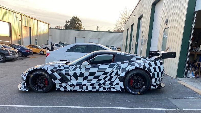

Before the yellow C7.R, there was the test mule! I plan to make more of these, this is the first one and it's the "Test Mule!"

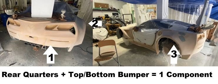

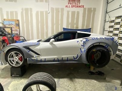

Originally Posted by PhantomGhost
I made the body panels myself. I bought my car specifically for this....I 3D scanned my car, used a 3D model from a racing simulator, subtracted the model from the scan, flip milled the parts, adhered them onto the car, took multi-piece molds of car's altered body panels with the factory mounting points, fabricated the kit and 10 months later...voila! One day I'll make an all carbon kit, but this will do for now. It is epoxy and fiberglass, plenty strong

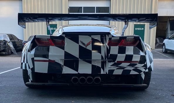

What wing is that??
The House Special haha! It came from the 3D model. I directly machined the two part closed mold for the wing + the 2 winglets, and resin infused them with epoxy. The spoiler has a polyurethane foam core. Machined the brackets out of .25" aluminum. I had to hand trace the design of the brackets because Pratt & Miller updated the C7.R's aero due to some IMSA rule changes. 2016 came canards, extensions to the sideskirts and a wing + diffuser that hung past the length of the car. My 3d model is for the 2015 C7.R where the wing and diffuser is flush with the rear, but with altered spoiler brackets to make the spoiler sit off of the rear of the car like the post 2015 car. Sorry to bore you with that info
