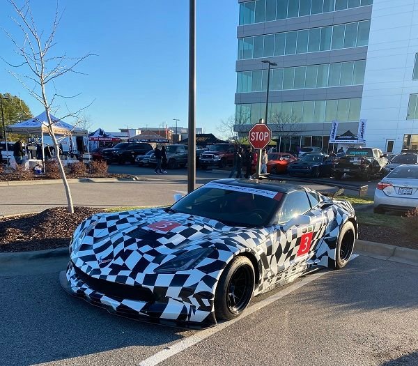

Hello, just sharing pictures of my car. I transformed my base 2014 Corvette Stingray C7 into my one of my dream cars....the C7.R racecar.

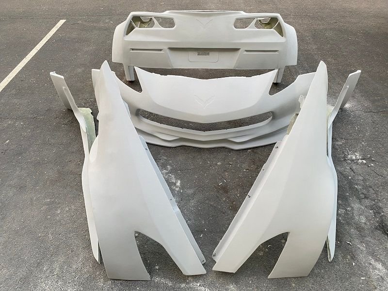

I made the body panels myself. I bought my car specifically for this....I 3D scanned my car, used a 3D model from a racing simulator, subtracted the model from the scan, flip milled the parts, adhered them onto the car, took multi-piece molds of car's altered body panels with the factory mounting points, fabricated the kit and 10 months later...voila! One day I'll make an all carbon kit, but this will do for now. It is epoxy and fiberglass, plenty strong

Looks good. So freaking WIDE. What size tires fit under those flares?

Thanks! Same wheel size as C7.R racecar, totally different offset. 18"s all around...12.5" wide in the front, 13" wide in the rear. Same exact michelin (wet) race tires 65/30, 71/31

That is so cool. Where did you find the body panels?

Did you buy the kit somewhere?

Thanks, EVERYBODY, for the vote of confidence! I just remember when I got the chance to see the C7.R race car live in action at VIR in 2015, 2016. I have some old youtube videos with over 100k views under "ProtoFabLab" of the C7.R... that thing had a presence and attracted spectators like a magnet. So, 8 years later this is what I have. It is 1 foot wider than the stingray, has coilovers, BTR cam, tune, DOD delete, borla s type exhaust, 7 speed manual, 450hp at the wheels, which is plenty for me. It's quite fun to cruise around in...long distances...nope haha Thanks again for the support!

So nonchalant just 3D scanned my car, flipped milled parts, molds of car, fabricated the kit and 10 months later voila. Are you kidding me sounds like quite a lot and quite the PITA. Good going very industrious. Looks sick by the way.

Car is amazing. The wrap actually hides the amazing work however. I would of gone with duplicate of the actual racecar.
