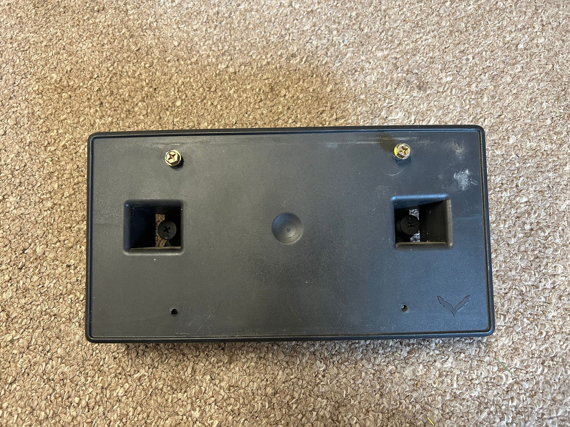

This is the aeroplate that you want, part # 22830069.

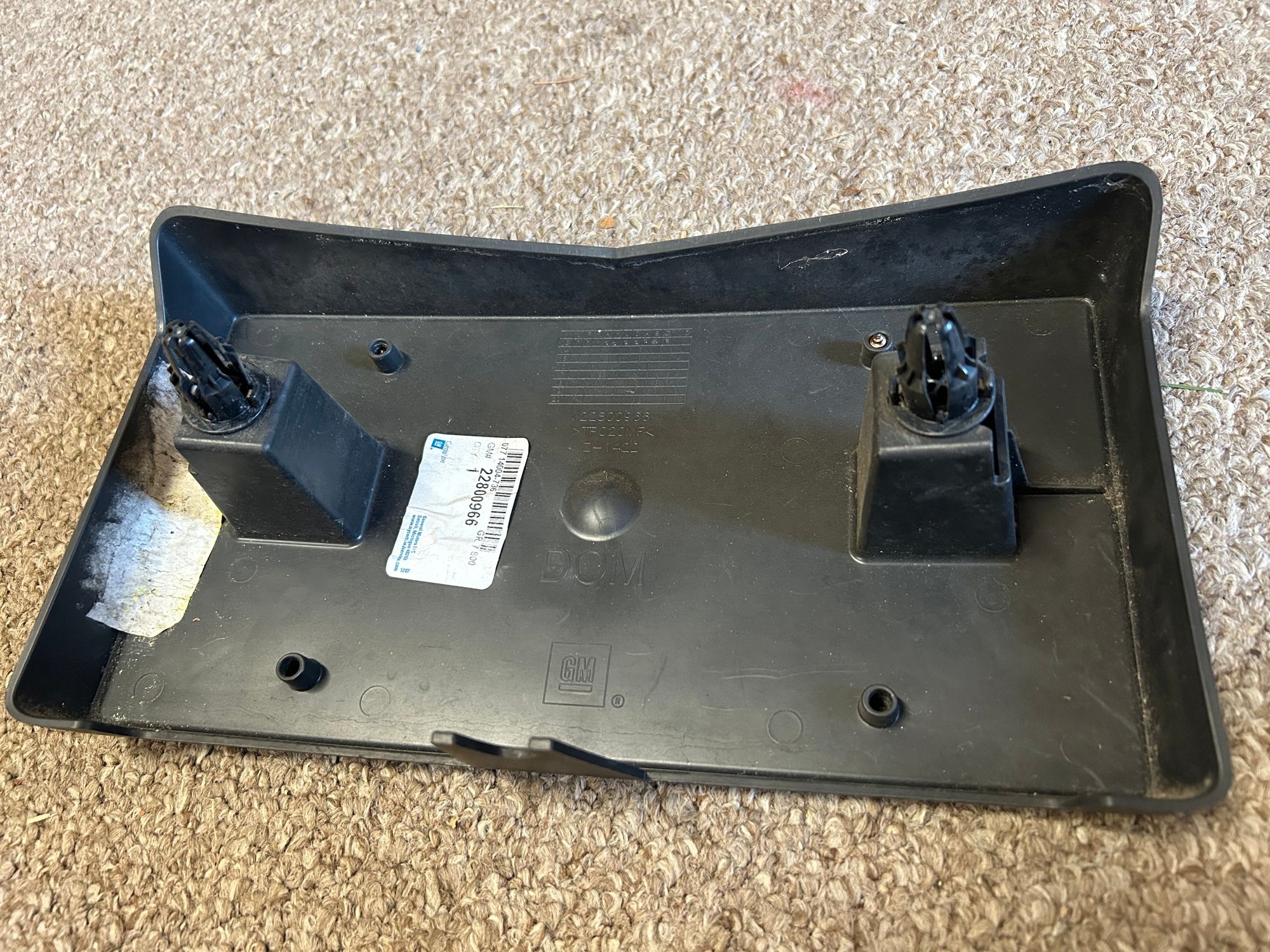

This is the license plate bracket that you do not want, part # 23111885.

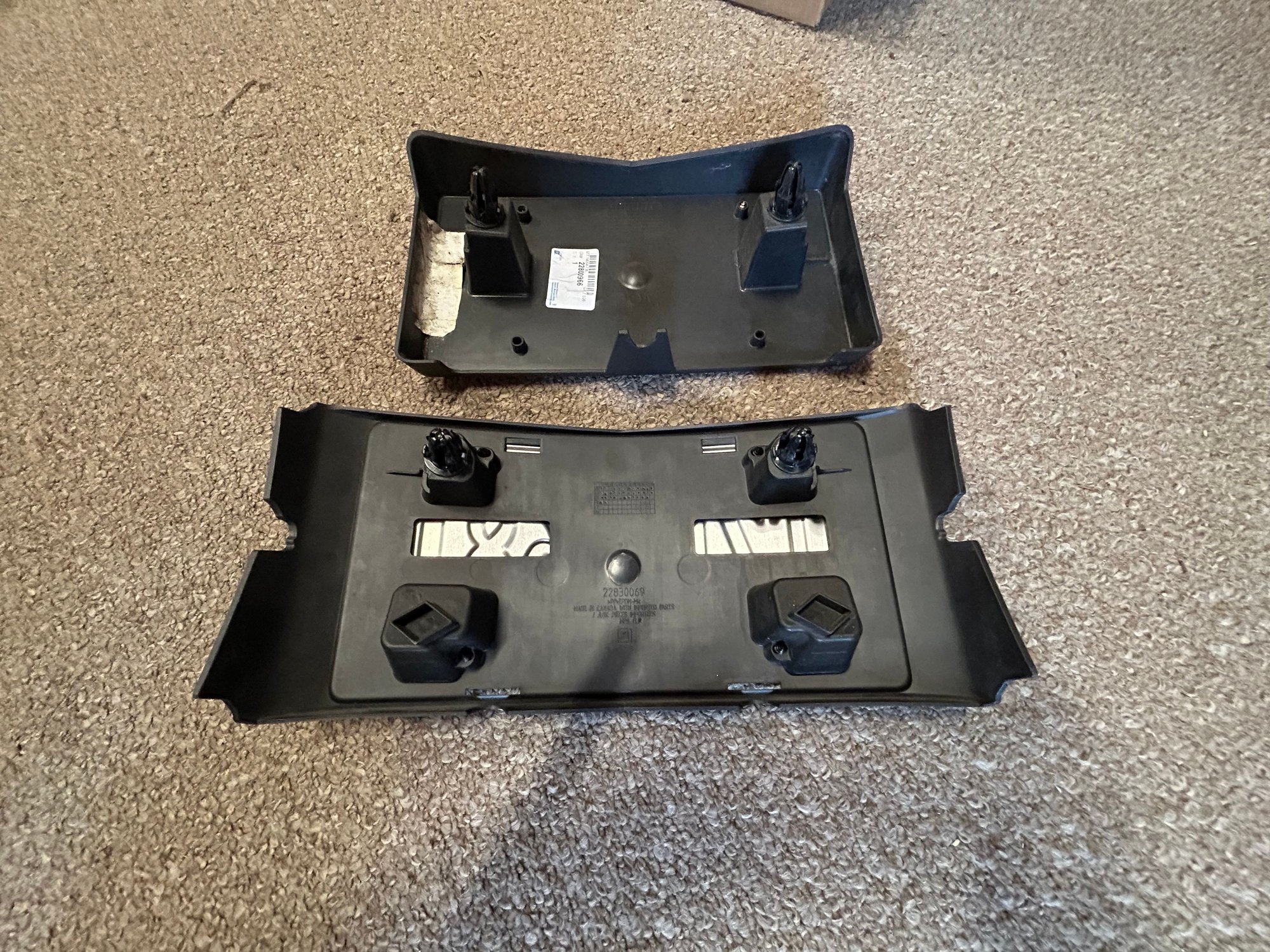

License plate bracket on top; aeroplate on bottom.

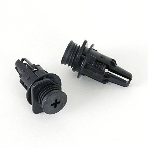

You'll need two of these expandable fasteners, part # 23129614, easily available on ebay.
