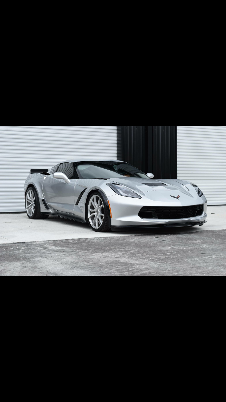

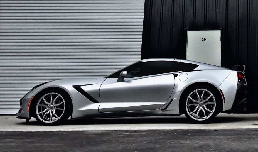

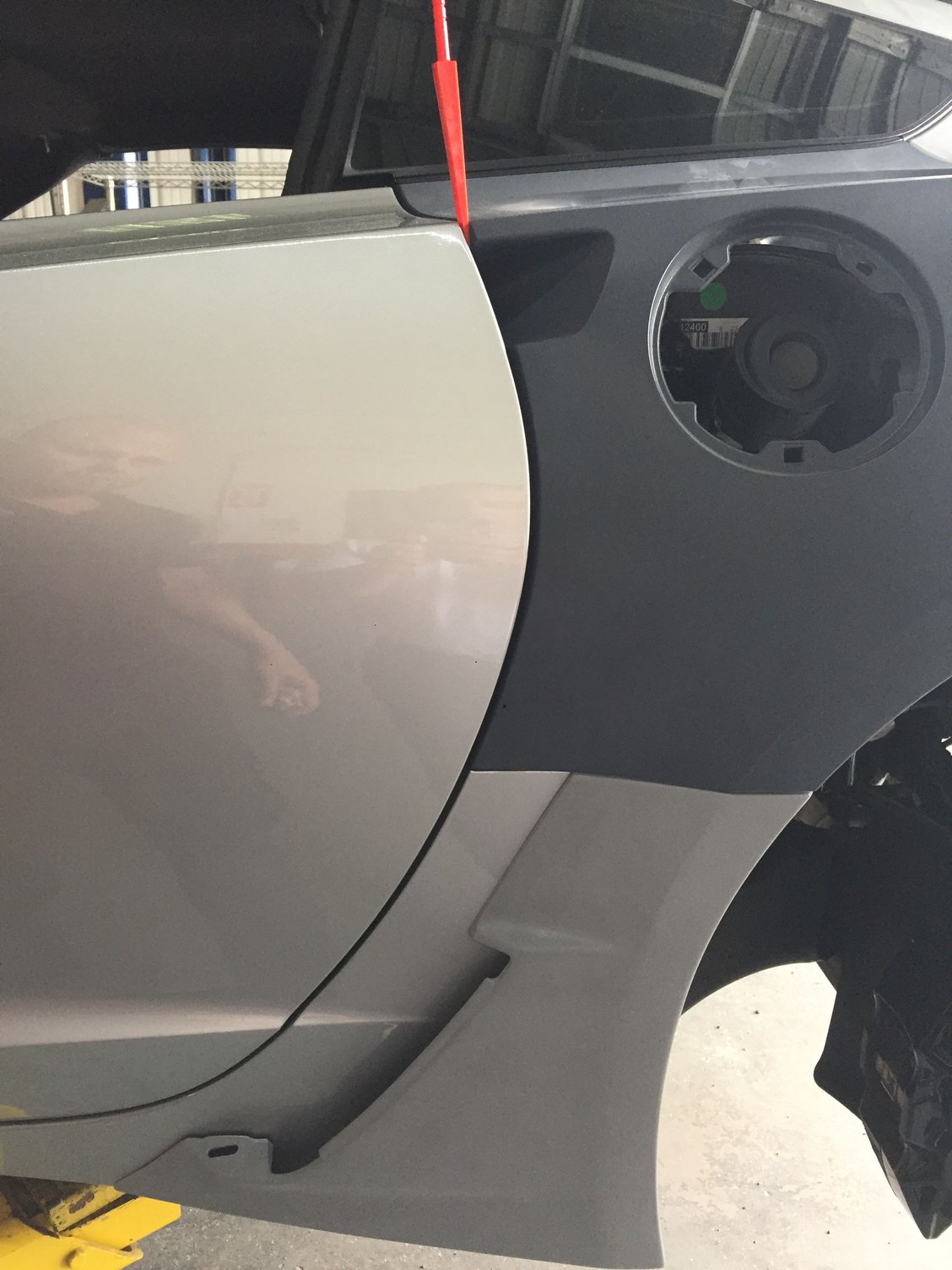

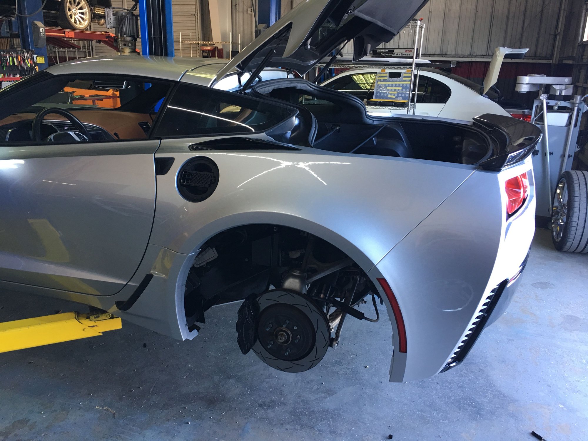

Late to this thread, but I did the rear widebody. You'll also want GS/Z06 rear wheel liners. Make sure the fenders have the metal support bracket for rigidity, and of course the orange retaining clips 3 per side. You will also need the GS/Z06 wider rear vents. The black lower valence is reused. You'll also want wider rear wheels/tires, or spacers. Get the ACS lower scoops of you care about those.
Have fun and enjoy!
Old Oct 26, 2024 | 11:17 AM
stevettec7's Avatar
stevettec7
Joined: Jan 2015
Posts: 2,104
Likes: 949
From: Fleming Island Florida
I used ACS when I did my rear widebody. I thought it turned out great. Of course later I wound up doing a full widebody conversion with all factory parts.
Rocker filler is the only part not from GM. I also cut the opening for the rear brake cooling ducts.
