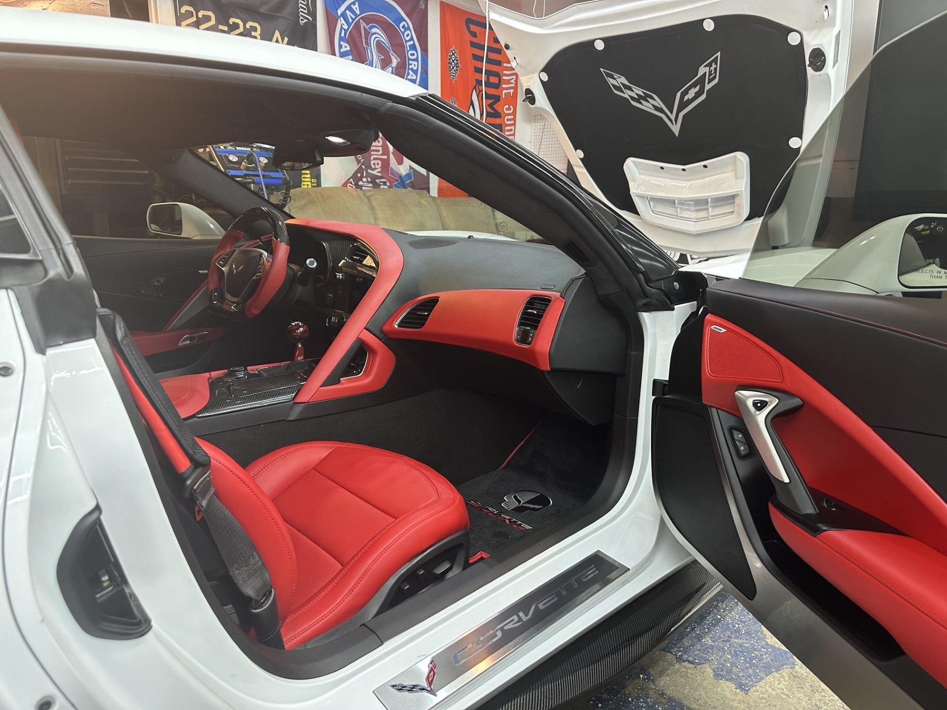

I know there is a history of threads on this but I would like to ask a question for the experts. I recently purchased a 2014 3LtT, I took it to my local dealer for the dash leather separation and was told GM doesn't offer the replacement part any longer. Can this be true?

Bought my 2016 in January 2018. First thing I looked at was wheels for curb rash. Second was the dash. Both were perfect. (Car had 18,500 miles, was a lease car from California the dealer had bought at auction).
Car kept in garage and always put sunscreen when parked outside. 9 months later dash was repeating at the HUD and defroster vents. I never used anything but a moist chamois to clean it.
Missed my 3 year warranty by 2 weeks. Dealer called GM and I ended up having to pay 1/3rd, GM 2/3rd. My end was around $950.
