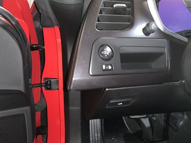

I think I’ve seen this here before but I haven’t been able to find out how to remove the switch that moves the power mirror. Looks like the panel can be removed but I want to make sure I don’t break anything in the process.
2019 1LT with switch mounted on left side of dash. (See pic)
Thanks for any help!

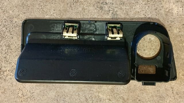

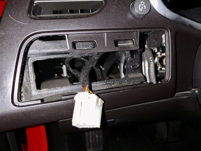

I purchased a new switch on eBay for $18. It fit and worked perfectly and the install was easy.
Simply pull out the top of the panel the switch is attached to. The panel has “hooks” on the bottom edge so you just lift the panel out and you can access the switch.
Pull the wire connector off the switch (there is a release tab at the top of the connector that needs to be pressed down to release the connector)and you can take the panel out to work on it. There are 2 tabs on each side of the switch that need to be pressed in to release the switch.
Remove the old switch and pop in the new switch. Plug the wire connector/harness into the back of the switch, put the bottom edge of the panel in place then rotate the top back into position and press the 2 metal tabs back in place.
The entire job took about 10 minutes.
