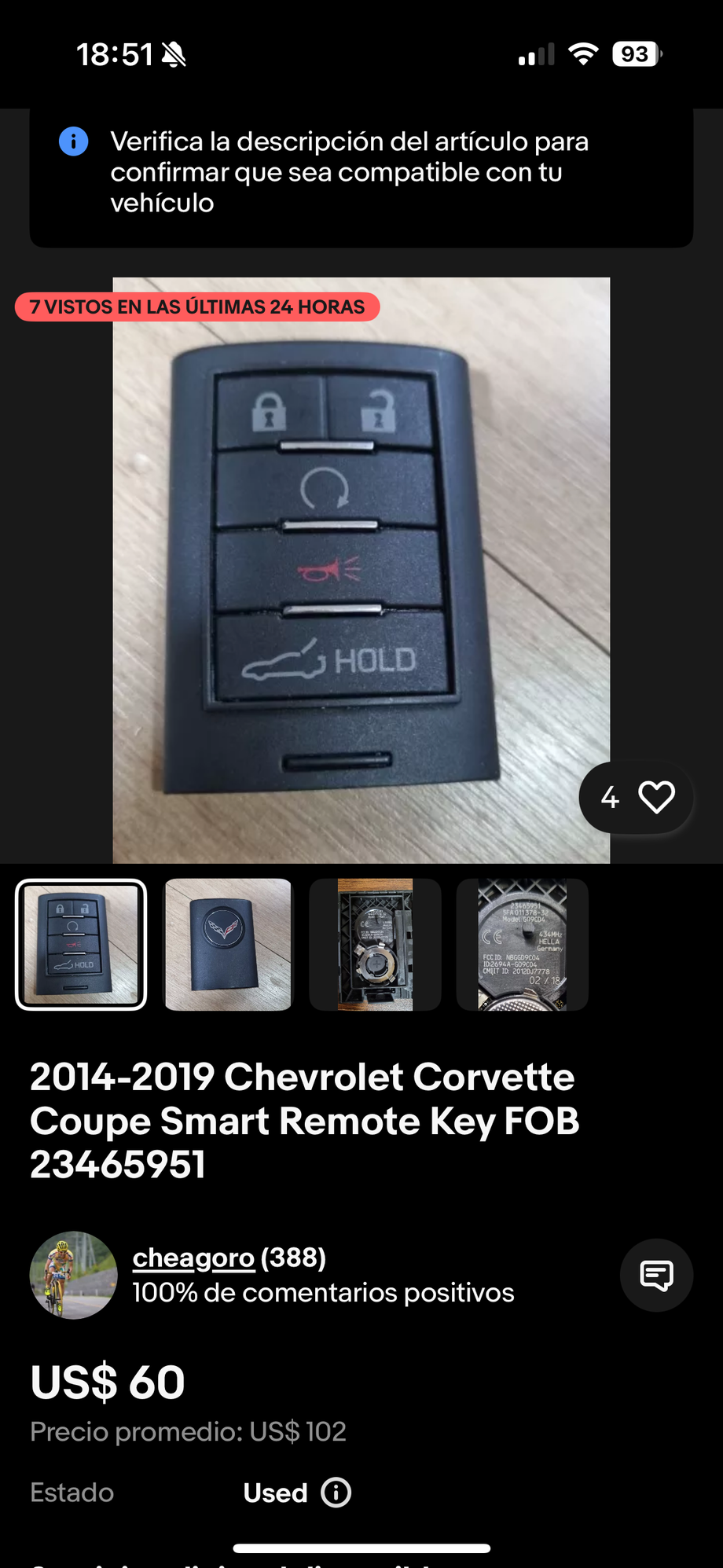

I would like to buy this one and I don't know if it's the right one

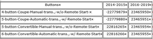

It's in the below thread post #3 which I copied and pasted below. I don't know from your VIN but you can decide from the list. The one you listed in post #2 is the 2016-2019, coupe, automatic trans, w/ Remote Start.
https://www.corvetteforum.com/forums...-question.html
4 button TRANSMITTER W/O REMOTE START Manual 14/15 22779879 16/19 23465950
5 button TRANSMITTER W/REMOTE START Automatic 14/15 22779880 16/19 23465951
5 button TRANSMITTER W/O REMOTE START Manual Convertible 14/15 22816265 16/19 23465954
6 button TRANSMITTER W/REMOTE START Automatic Convertible 14/15 22816266 16/19 23465955
NOTE: Part numbers can change! Always verify part numbers with your dealer!!

One more question, can I buy a used key from eBay and program it to my Corvette? Or does it just have to be new?
Old Mar 11, 2025 | 01:04 PM
aklim's Avatar
aklim
Joined: Jul 2004
Posts: 28,475
Likes: 3,291
From: Hartford WI
You can ASSUMING it is the correct key. After all, when you wipe both keys, it will be assuming 2 new to the car keys. I would not want to use a used key but that's me.

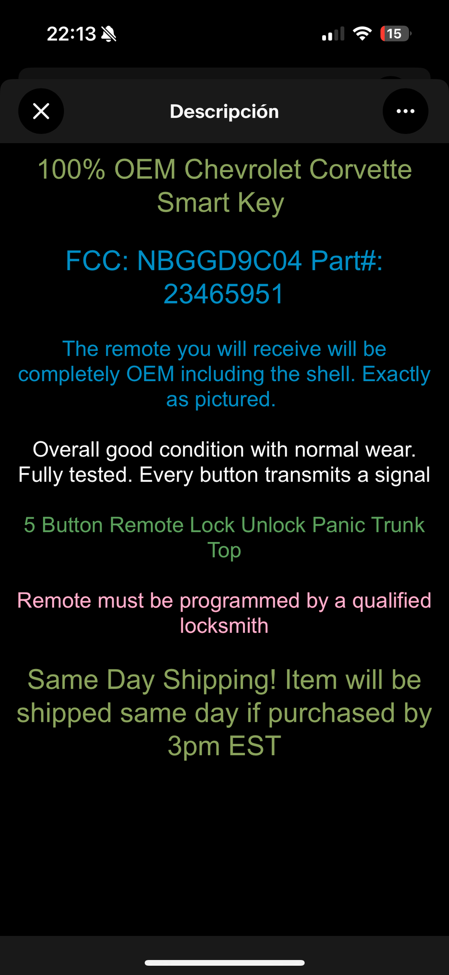

A C7 has both an electronic fob for unlock/start/etc, and a mechanical key to open the trunk if the electronics can't.
Any fob with the correct part number can be paired with an appropriate Corvette, unless something is wrong.
The mechanical key for the trunk is cut to the VIN on the car, they are not interchangeable unless you are unusually lucky.
Exactly. That was my question. If I buy a used remote, without the key to open the trunk.

I bought this now, I hope it helps me
