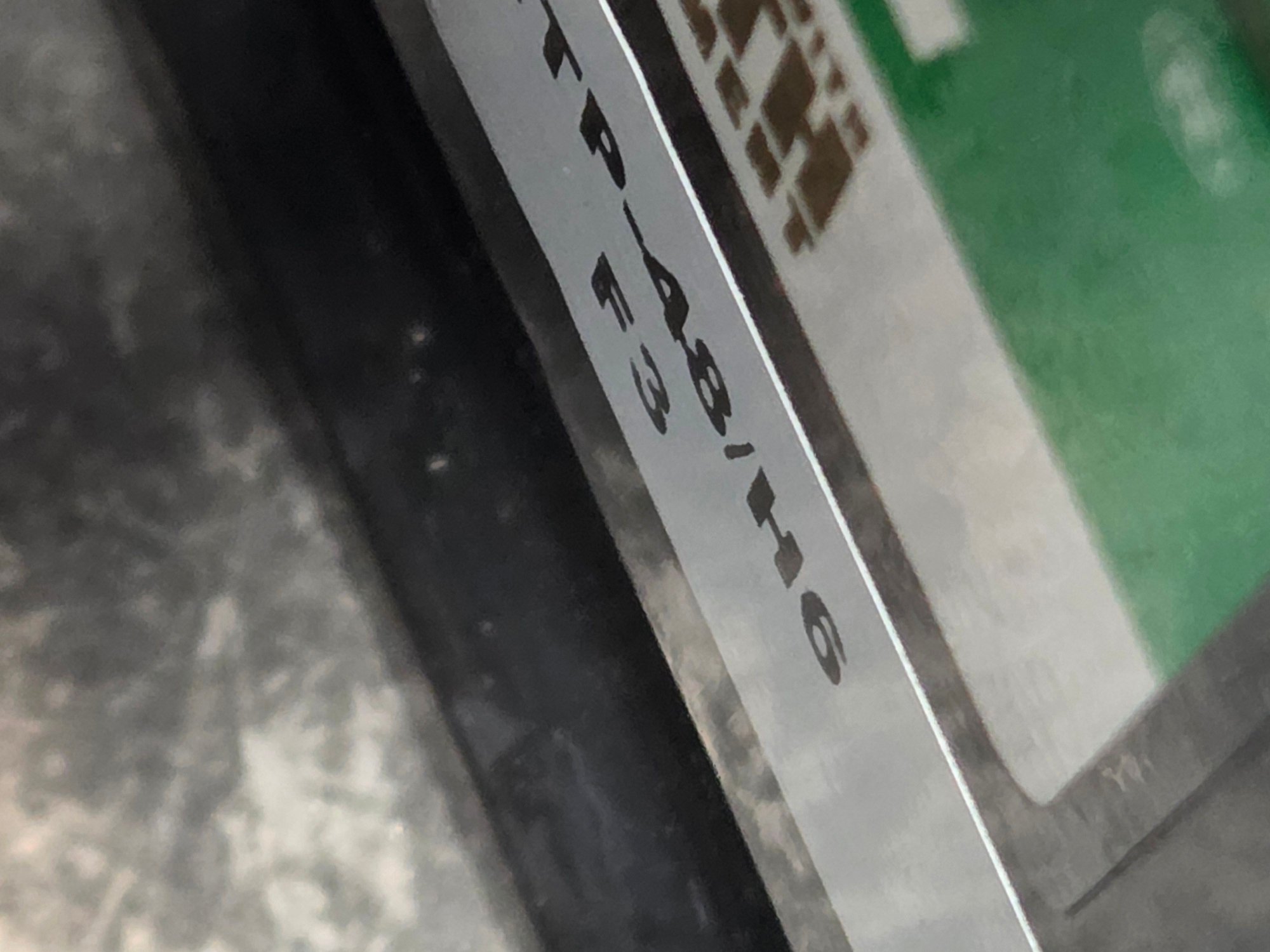

i had a batt check completed at an interstate facility + they took a pic of the hard to look at date/june '23 code for me!!
