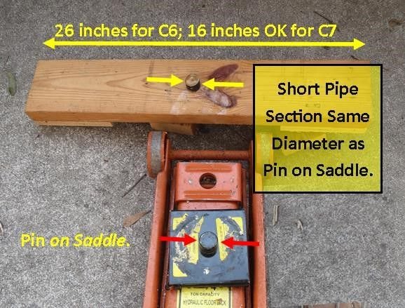

Still need a cross brace on the jack to fit the Preferred GM Lifting Points. I use inexpensive hydraulic jacks on the side with high jack pads to clear my side skirts. Then my larger jack fits the front and rear with a Cross Brace I made from a 2 X 6. Modified the one I used for my C6 since the C7 only needs it to be 14 to 16 inches wide.
Cross Brace Lifting Rear
Cross Brace Made from 2X6 and Short Piece of Pipe That Fits Saddle Hole. Fat, Short Wood Lag Screw and Epoxy Hold Pipe in Place
