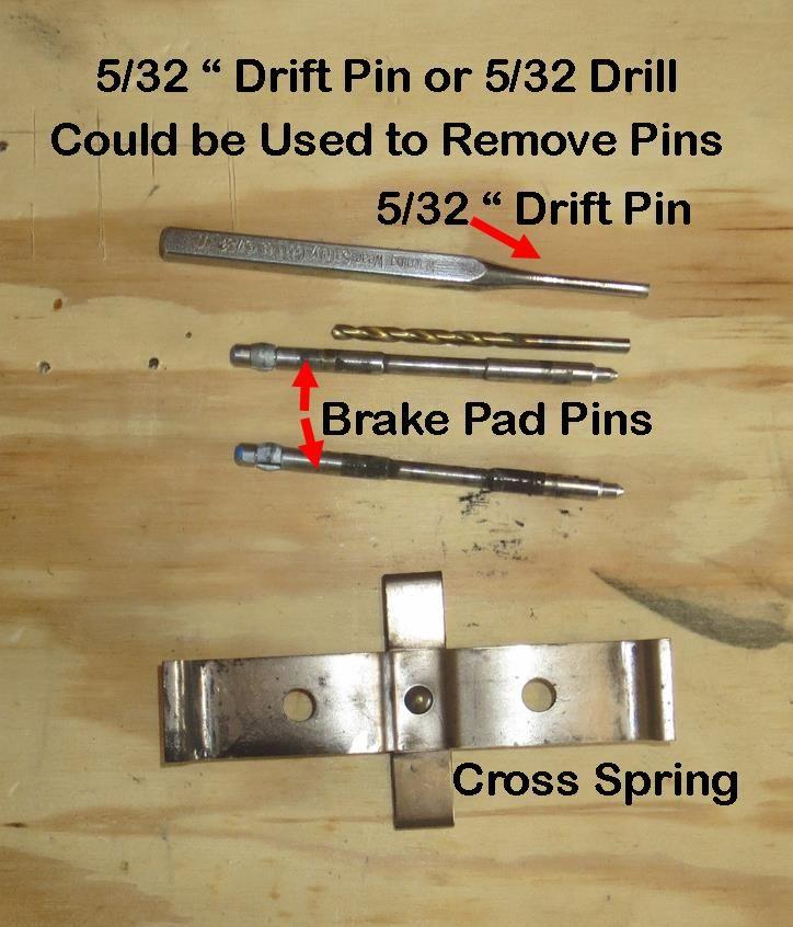

The smooth end of a 5/32 drill bit works as a drift and fits perfectly. I had a long 5/32 drift but you could use a drill bit and hit the fluted side. If you have a 2014 (at least the early build like mine, September 2013) the front pads use a very strong two side tape to hold the pads to the pistions. Apparently common in Europe. Very difficult to remove the pads, you won't do it by just leveraging them out. Been several comments on how to do it in other more recent threads, my PDF install with lots of pics: http://netwelding.com/Ceramic_Pads.pdf shows what I did to get them off Apparently late 2014 were like the rears and all pads on a 2015, they don't use the tape. I changed mine before the service manual was out. However looking at the service manual it says nothing about the tape!

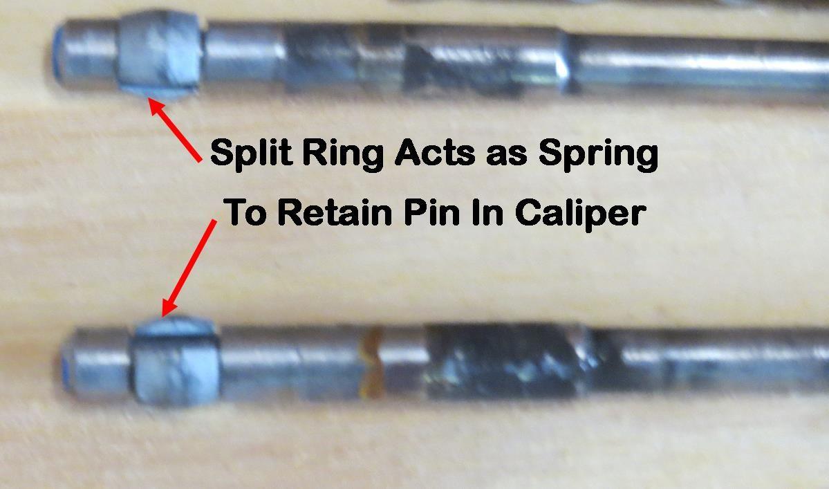

What's the torque specs for the brake caliper pins?
Old Apr 22, 2015 | 11:54 AM
JerryU's Avatar
JerryU
E-Ray, 3LZ, ZER, LIFT
Joined: Sep 2007
Posts: 34,860
Likes: 12,293
From: NE South Carolina
That is an interesting question, had a similar one. The answer is they are not threaded! Below are pics of what they are, they press in and are held in with a spring like clip, similar in function to a roll pin.
Need to look at my install PDF with 15 pics: http://netwelding.com/Ceramic_Pads.pdf
Pad Retaining Pins Are Not Treaded
Split Ring Holds Them in Place

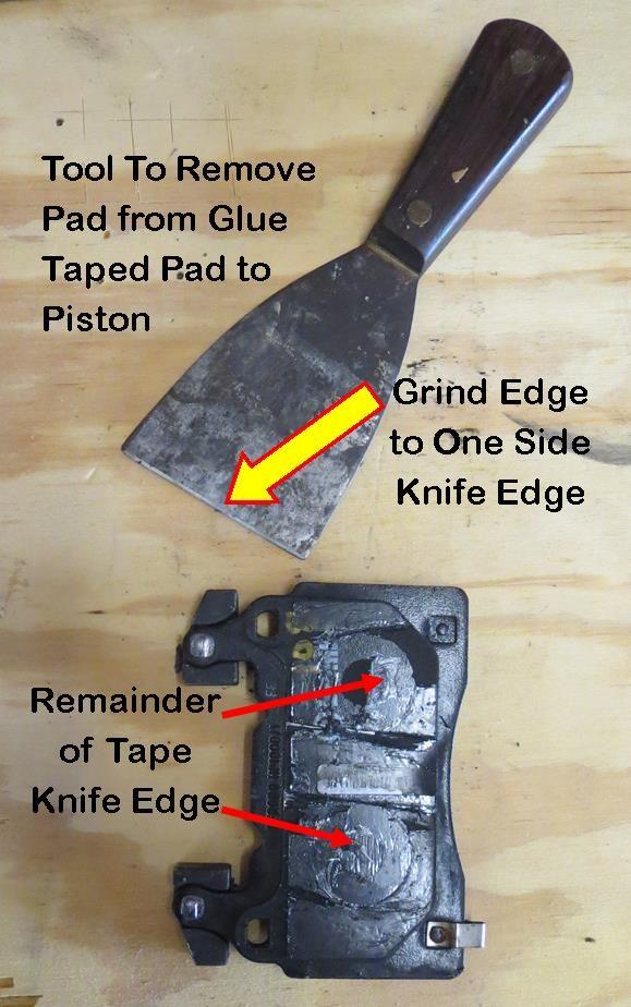

I finally got around to changing my brake pads on my 2014 C7 to the Carbotech and instead of struggling with getting the original front pads off (the dreaded sticky tape) my son and I just removed the calipers. It was so easy to free the pads once the calipers were off and they left no residue on the pucks!
I found a wide, stiff paint scraper ground to a sharp edge along with a hammer made quick work of the sticky tape. This is an 8+ page picture PDF of my install: http://netwelding.com/Ceramic_Pads.pdf
Paint scrapper and hammer made quick work of two side tape. Most of the tape residue stuck to the pad only a little to remove from the pistons
