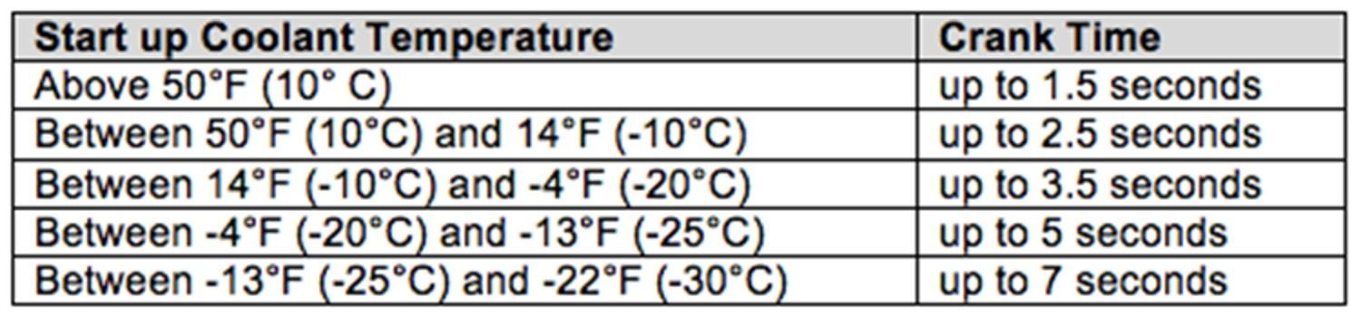

The following is from GM techlink.
Ed
Extended Cold Crank with Direct Injected Engines
February 20, 2014
The 4.3L, 5.3L, and 6.2L (RPOs LV3, L83, L86 and LT1) direct injected (DI) engines available on some 2014-2015 Corvette, Silverado 1500, Suburban, Tahoe, Sierra 1500 and Yukon models may have an extended or long crank time during cold ambient air temperatures.
Direct Injection engines may have slightly longer cold crank times than that of port fuel injected engines. Direct Injection systems run at higher pressures and the mechanical pump on the engine must build up the required pressure before the first injection event occurs.
If the temperature is below -22°F (-30°C), the recommendation is to perform an assisted start (such as with the use of a block heater).
For ethanol fuel, see #PIP5174: Extended Engine Crank Times When Using E85
Following are typical DI engine crank times using gasoline:

the high pressure fuel pump is driven off a camshaft lobe (not the same ones that open valves) so it takes some engine rotations to get it pumping. i can post a screenshot of the table when i get home from work if someone doesn't beat me to it.
Last May, had the opportunity to speak to Kirk Bennion on this and a few other observations. Your response above pretty much described what he said. I personally love to her her roll up to start. Just makes me smile each and every time
