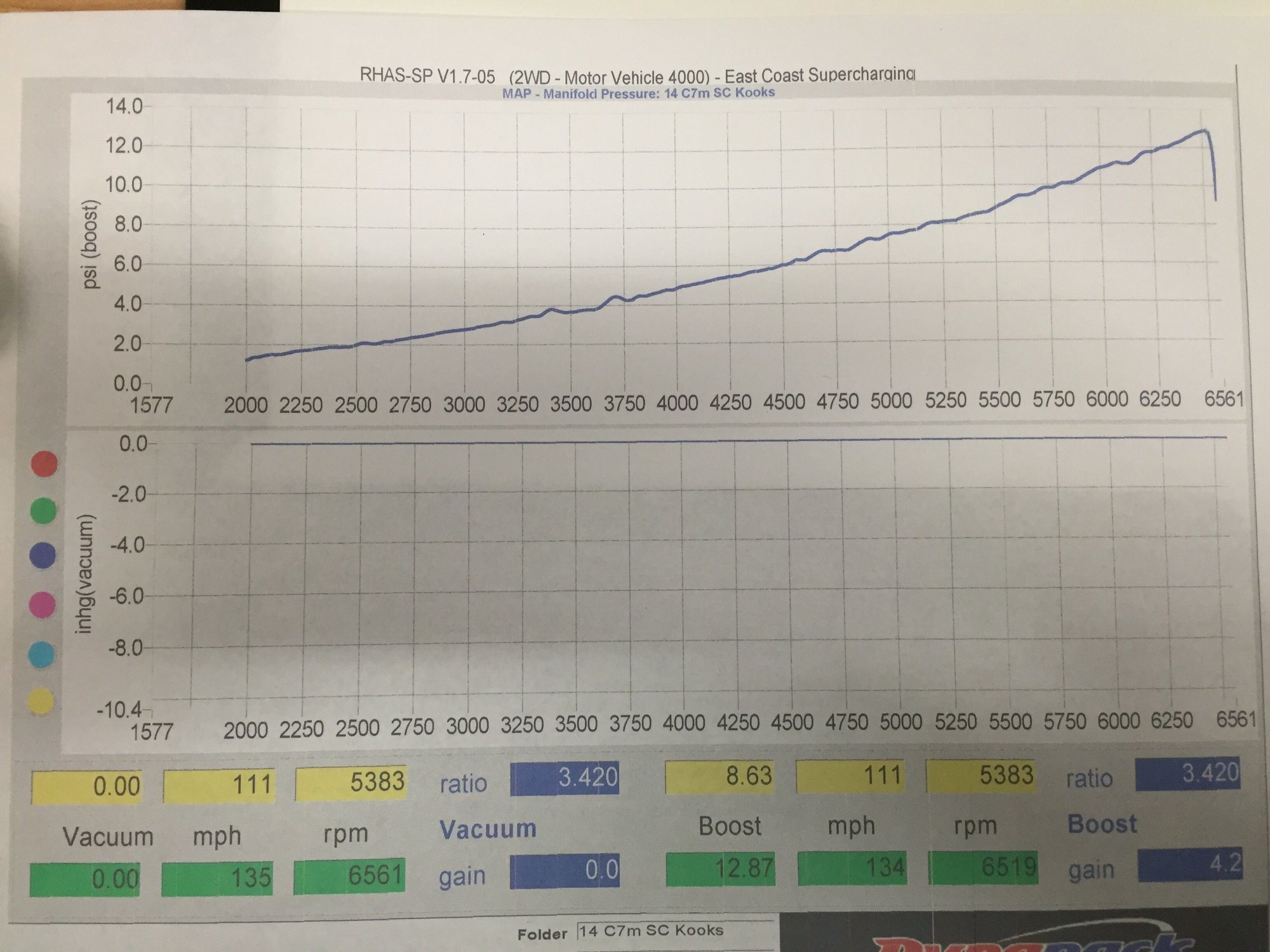

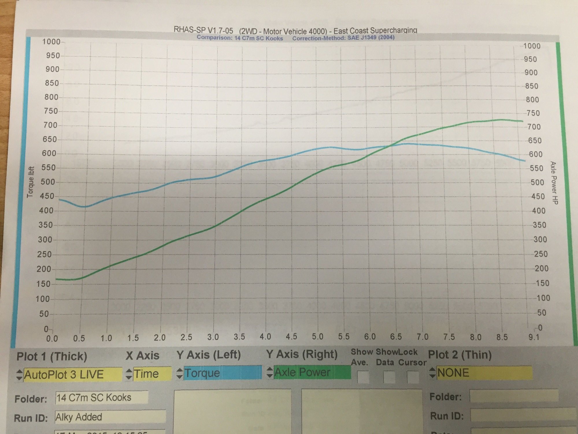

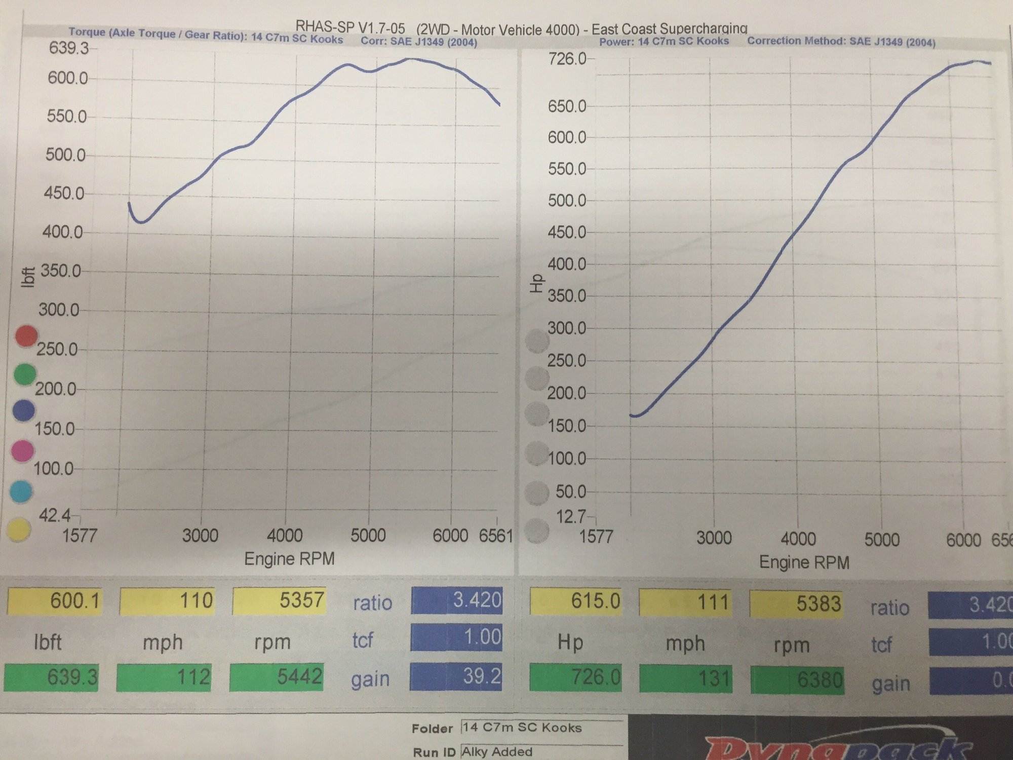

Nice numbers! I'll play too
2014 Z51 M7
ECS 1500 no restrictor
Kooks LT/off road x pipe/Borla Atak
Alky Meth
160 thermostat
Tuned by ECS master Doug

Wow @slesher...Almost 13 pounds of boost from just the restrictor pulled? No pulley change?

Believe me I was pleasantly surprised as well
Maybe Doug @ECS can explain in more detail how this happened.
In the meantime I'm very happy with that result so no complaints here

Typically we do not see that much boost, it was cold out then when we dyno'd your car which will increase boost some. Plus you were one of the earlier kits made, we might have had a slightly smaller pulley on there.
Very glad you're happy with it Fred, thanks for the compliments.

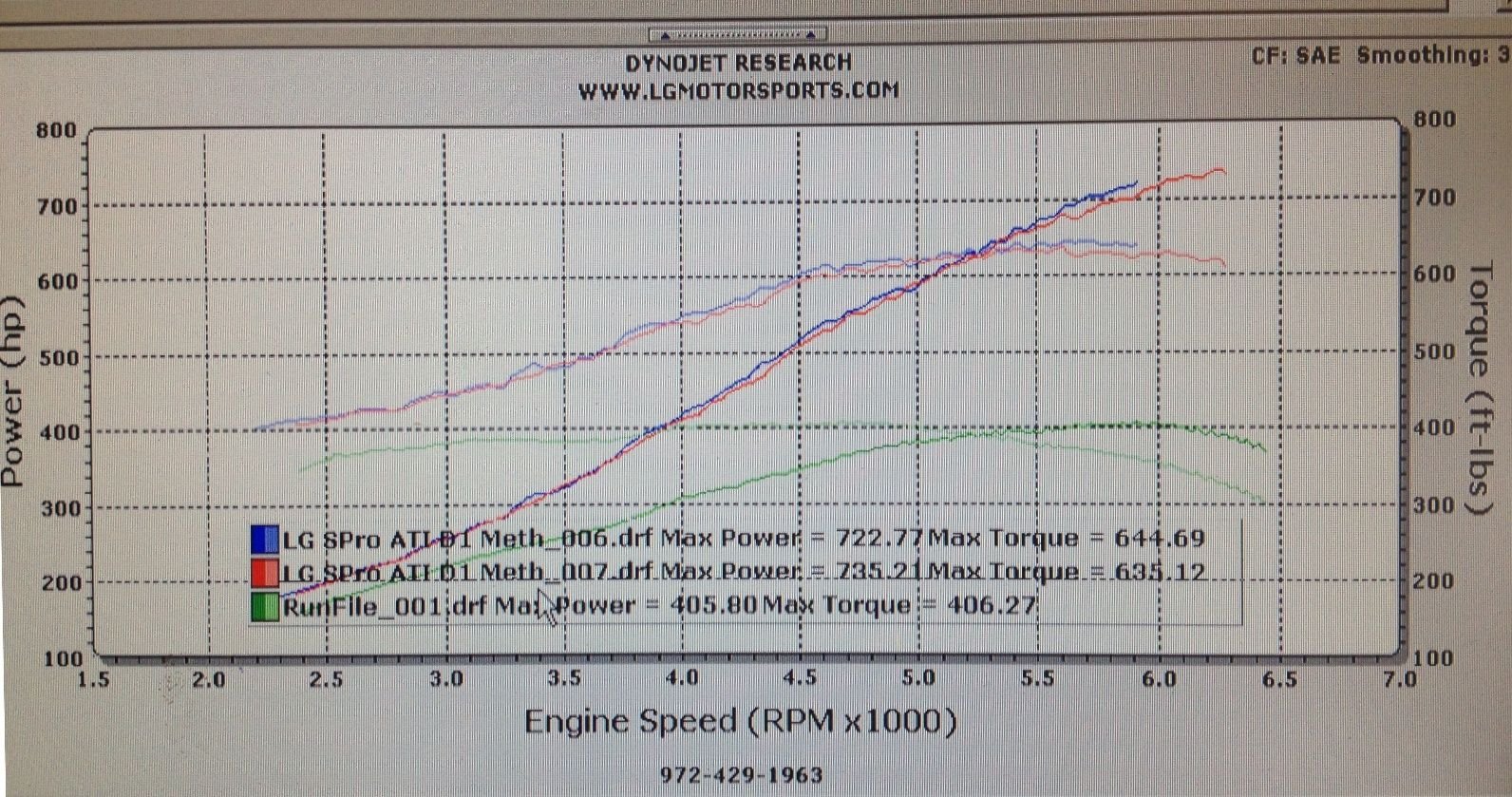

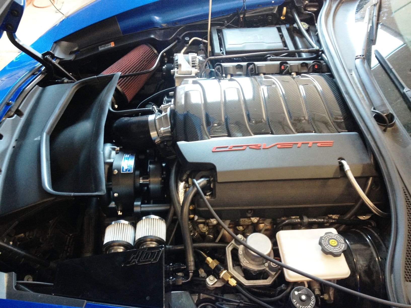

  • 2014 A6 Stingray
  • Stock LT1 with LG blower cam
  • LG stepped Super Pro headers
  • ATI Procharger D1SC (10-11 psi)
  • Alky controls Meth
  • 93 octane pump fuel

Any fuel issues with this car Anthony?

No....when we do a cam swap on them we are running the larger 35% bigger fuel lobe, plus it has meth but no, it does not have fuel issues.
