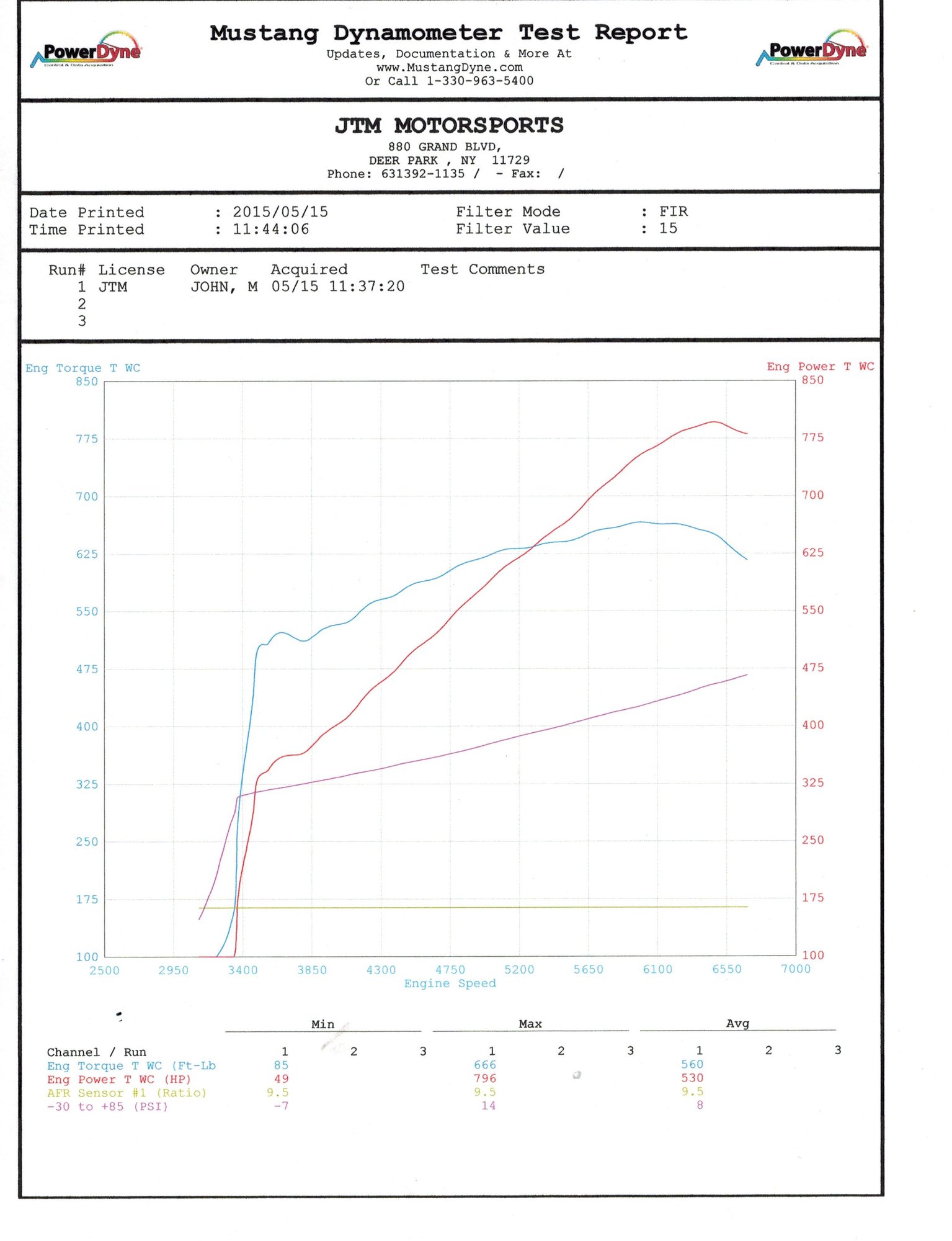

Here is our Shop Car
2015 A8
ECS 1500 13.5#
JTM Stage 1 cam (small for stock converter)
ARH 1 7/8 no cats
Alky control Meth
E85
796/666 On our stingy Mustang Dyno..
9.74 @ 146 1/4 mile..

Very nice
What size pulley and is it a single or dual nozzle alky?

3.75" Pulley & dual nozzle.
