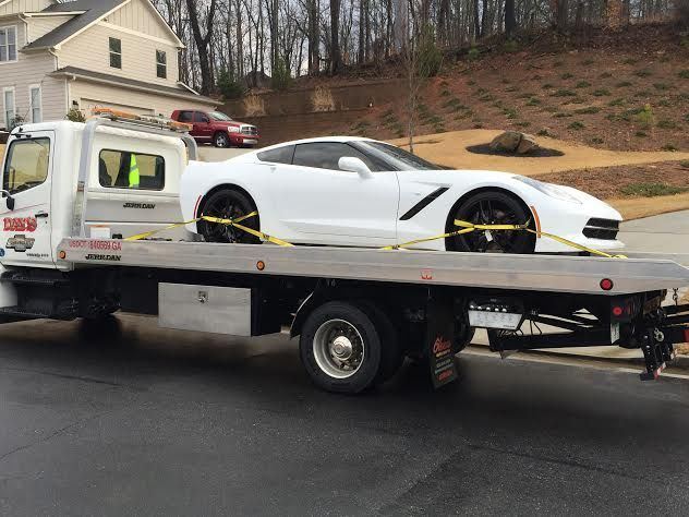

Got her picked up this afternoon. Driver treated the car as if it was his own and managed to get it up without scraping. It's off to Days Chevrolet so hopefully I will know more by tomorrow!

Holy crap that car is broken and being loaded onto a wrecker and STILL looks amazing!!!
