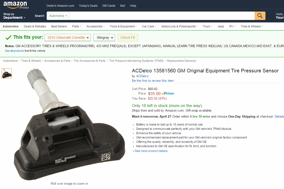

This resource shows that P/N as a viable US version:
http://www.tpms.com/C7_Corvette_TPMS...p/13581560.htm
And Amazon:
Whether it autolearns, not sure, but it should work.

Likes: 499
From: Northern Virginia
I don't think I would rely on Amazon as a final arbiter of applicability.
I agree, but the P/N the OP is now getting from the dealer has relatively few references in CF for the C7 compared to 19119416. It was merely to provide some info implying (at best) it should work. And see below...
