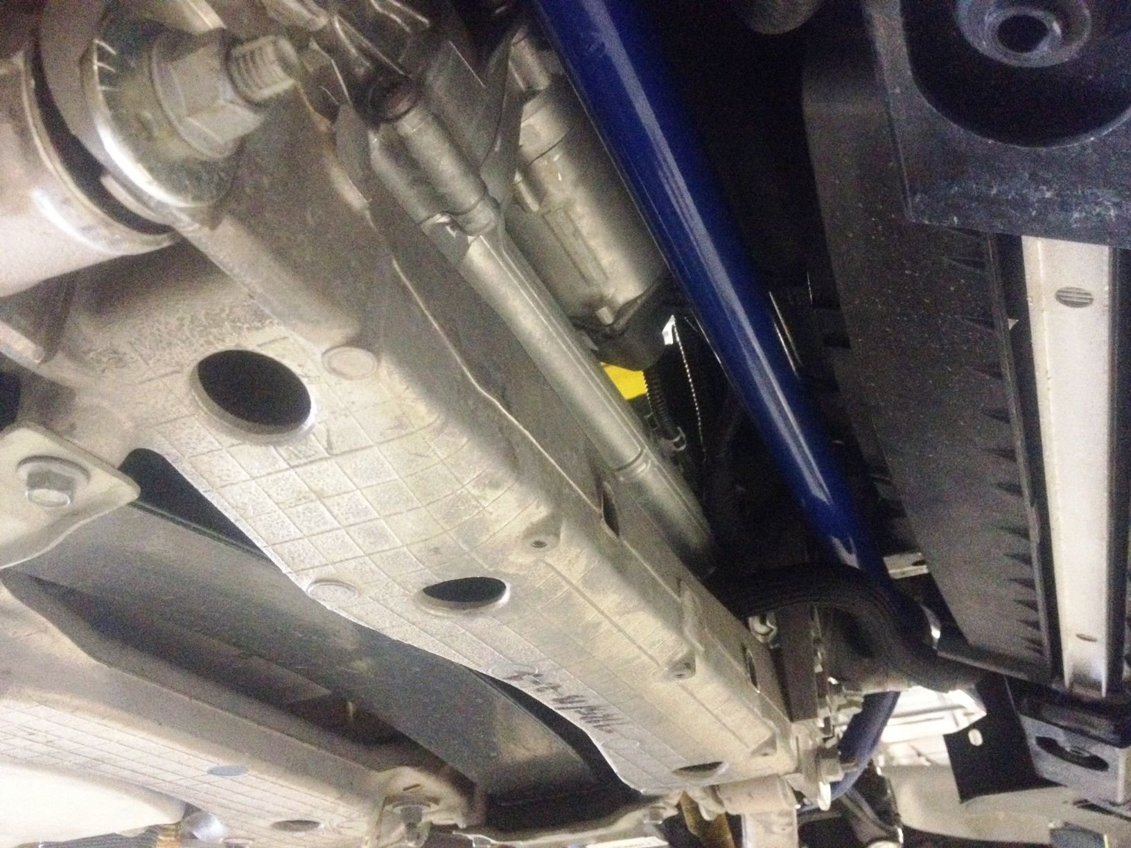

Boost Monkey I know you like pics
Great improvement over the Z51 bars, simple installation - VIR the next day and LG have done their homework A+
Thank you, sir.
I will be adding these to the mod purchase list.
