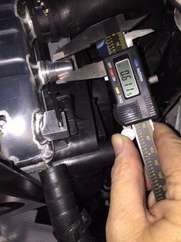

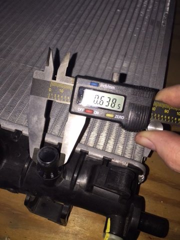

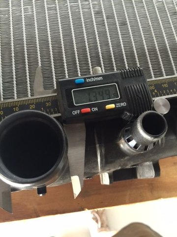

Found the problem!
The large lower hose was leaking, so I repositioned the clamp to no avail.
So I get my digital calipers out and begin measuring everything.
It turns out the new radiator hose neck's are smaller diameters then the original.
Here are the sizes
The large upper and lower OEM is 1.350"
The smaller lower clip-on OEM is .638
The smaller upper clip-on OEM is .375
(measurements are with in +- .005 difficulty getting calipers in there.)
The large upper and lower Dewitt's is 1.250" (0.100 smaller)
The smaller lower clip-on Dewitt's is .611 (0.020 smaller)
The smaller upper clip-on Dewitt's is .375 (same)
OEM neck
OEM Clip-on
DeWitt's neck
DeWitt's Clip-on
I will call Dewitt's tomorrow and see what they say.
Old Aug 9, 2015 | 06:30 PM
Tom@Dewitt's Avatar
0Tom@Dewitt
Former Vendor
Joined: Jan 2000
Posts: 5,593
Likes: 631
From: Brighton
The problem we have is aluminum tubing is only available in certain sizes. You can get 1.0, 1.25" 1.5" & 1.75. With the molded plastic fittings they can dream up some odd ball sizes , like 1.35 and nothing is available to match perfectly so we use the closest thing. We've been doing this for ten years and thousands of radiators and that .100" had never been an issue. In fact, some have told us it makes it easier to get the hose back on. I don't recall anyone ever trying to pull a vacuum before so maybe the issue is only related to that method, I doubt the connection would actually leak fluid. You could dump the gm spring clamp and replace it with a good old fashion worm gear type. That will seal both vacuum and pressure.
