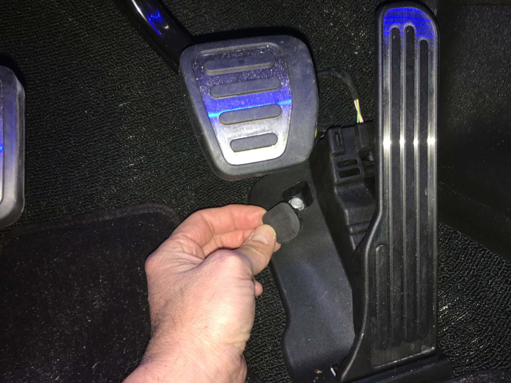

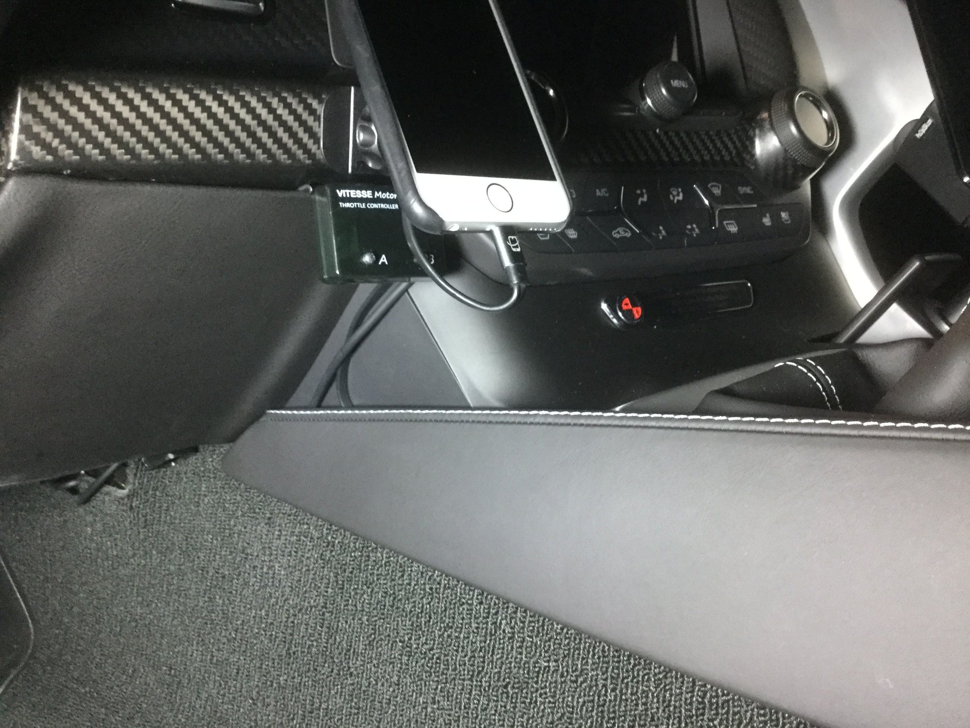

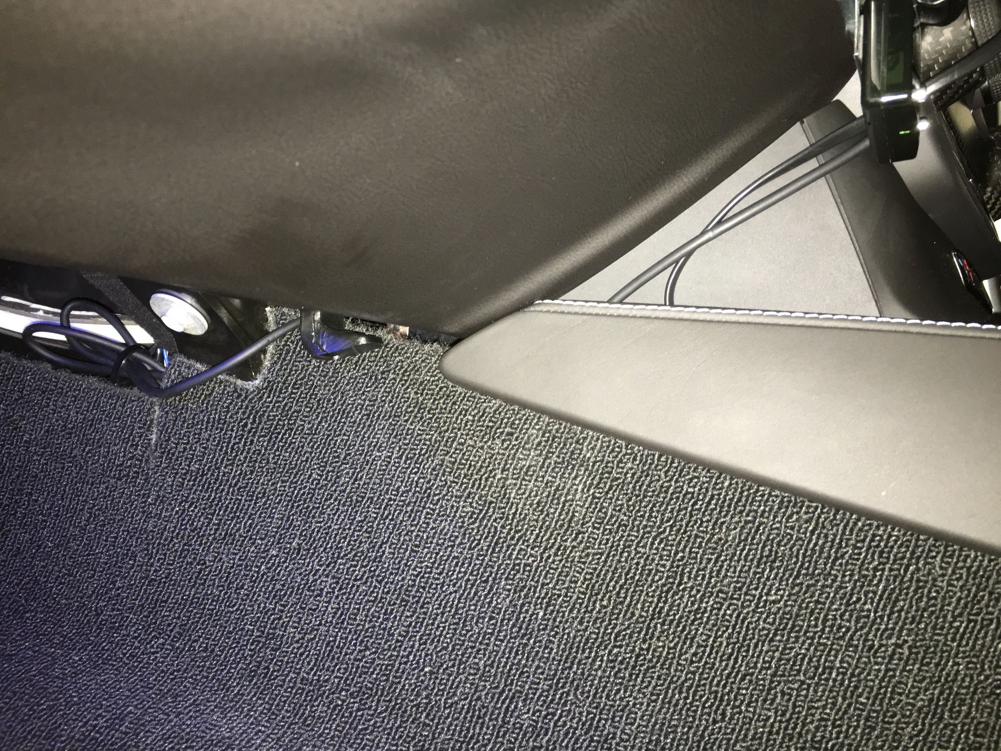

Ok so I got it installed. It's fairly straightforward but would be a LOT easier if I were a double jointed ninja. Sadly, I'm not. I wanted to put it out of my siteline and down a little bit. If you're tall, this may not work for you but I'm happy. It's out of the way because it kinda looks like *** to have it stuck in the middle of your dash and it's easy to hide the wires where I put it. I used double sided tape and a 1 1/2 x 3/4" corner bracket. It's raining so I'll have to test it out later. Here's a few pics of how I did it.

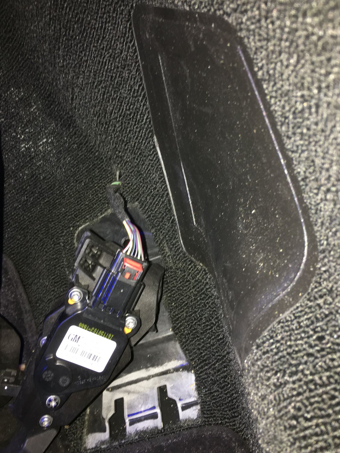

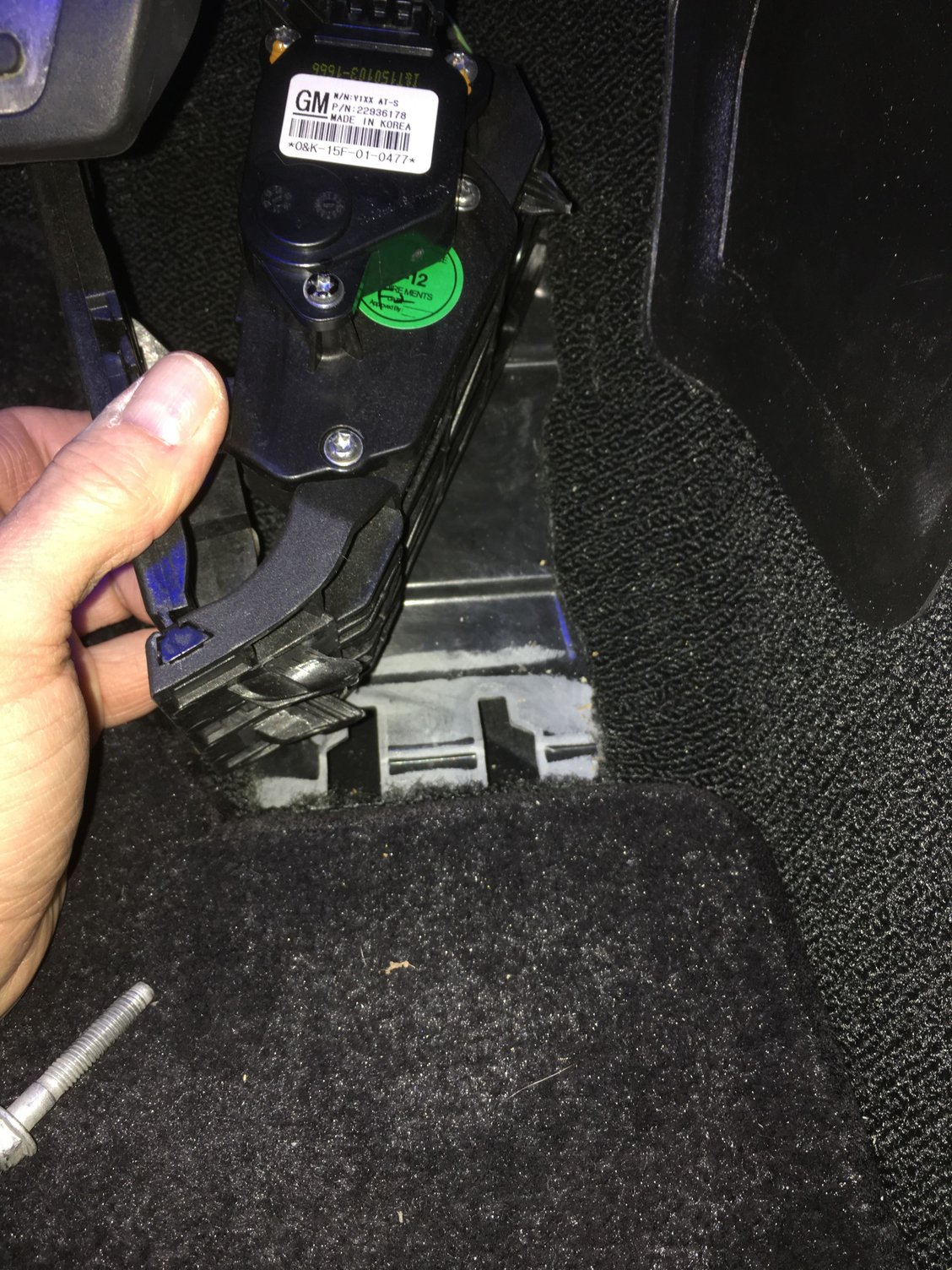

This was only the second time I've removed the gas pedal, you pull that soft rubber cover off, then unscrew the 10mm bolt. The whole assembly slides straight back. You might have to wiggle it to get it free:

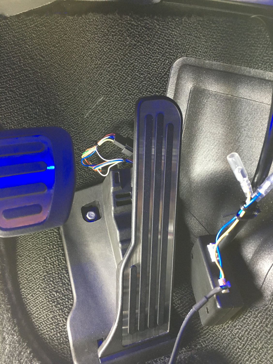

I ran the wires for the pedal and controller behind the carpet, then tucked it all back under so it was out of the way.

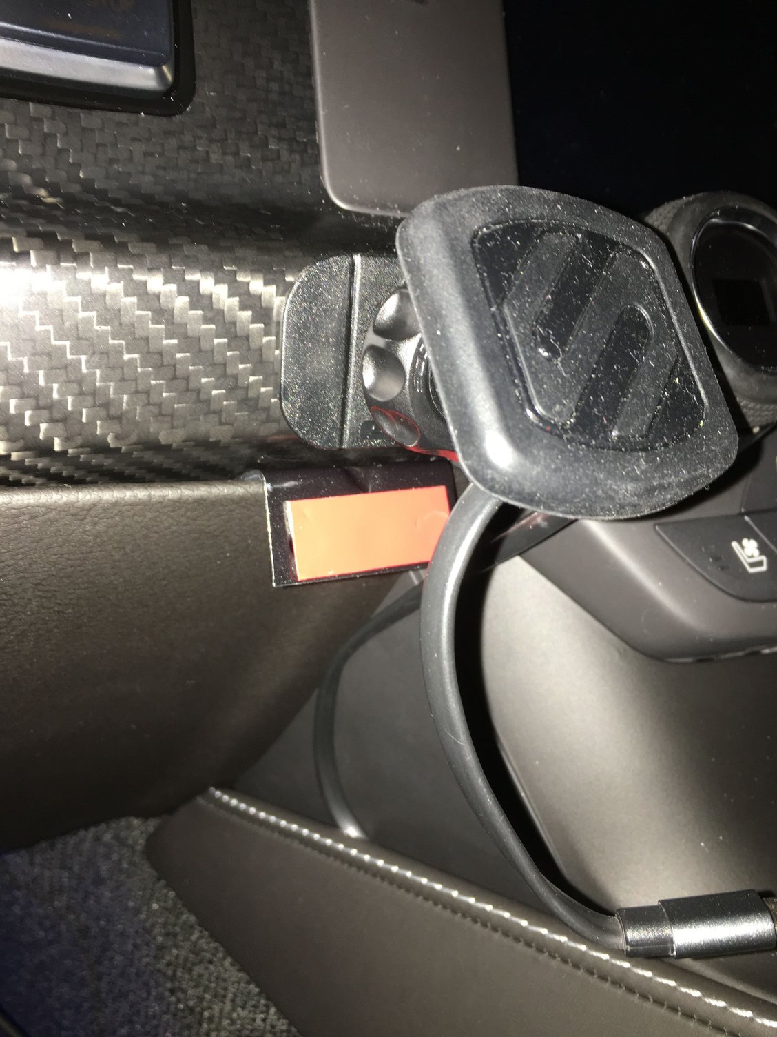

I bent the bracket a little so it angled down when it was installed. I also painted it because I'm ****. The bracket just slips between the dash and the lower trim piece. I have my phone mounted on that side, I like it because I can run the wires under that trim piece and back to the center console to be plugged in. It worked well for the control because the wires come out that side and they can be hidden pretty well.
The only thing I'm not thrilled about is the second Vitesse box, I just tucked it under the carpet but I think it's gonna get too warm there so I'll probably mount it using that bolt under the dash:
This works for me, hopefully somebody can improve on it.
