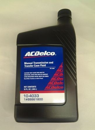

Now that my car (Z51) is at 20k miles and nearing 2 years old, I figured it was time I should change out the transmission (M7) and rear differential fluids.
Tremec recommends a Dexron III ATF fluid in the transmission, but the dealer parts counter tried to sell me something called ACDelco Manual Transmission Fluid. I decided to just skip the confusion and order the tried & trued Redline D4. I've been using Redline transmission fluids for 15 years and always been very satisfied with the shift quality. I was able to get a gallon jug of it on Amazon for under $50.
For the rear differential I went with the factory ACDelco LS 75W-90 fluid, which I was also able to get 3 quarts of it on Amazon at a good price (with same-day delivery).
Thoughts? Comments? Suggestions? Discussion?

The M7 takes ATF fluid only! Not regular 75W gear oil

part # 88861800

I change my differential fluid on my 2014, and used the GM fluid that comes with friction modifiers already in it...
Technically, no one makes Dexron III fluid anymore, and I have been using the GM Manual Transmission fluid (same stuff)..
Some club members tried a full synthetic on older models and had some shifting problems. They went back to the stock fluid and problems went away... GM stocks only one manual transmission fluid for C5, C6, and C7 now.

Interesting, so it's likely the ACDelco Manual Transmission Fluid is the correct fluid, just under a different name since it's only sold for the manual transmission cars, not the ones equipped with automatics (since those are all running Dexron VI now it appears).
Correct, automatics now use Dexron VI.

Pics for future reference:
